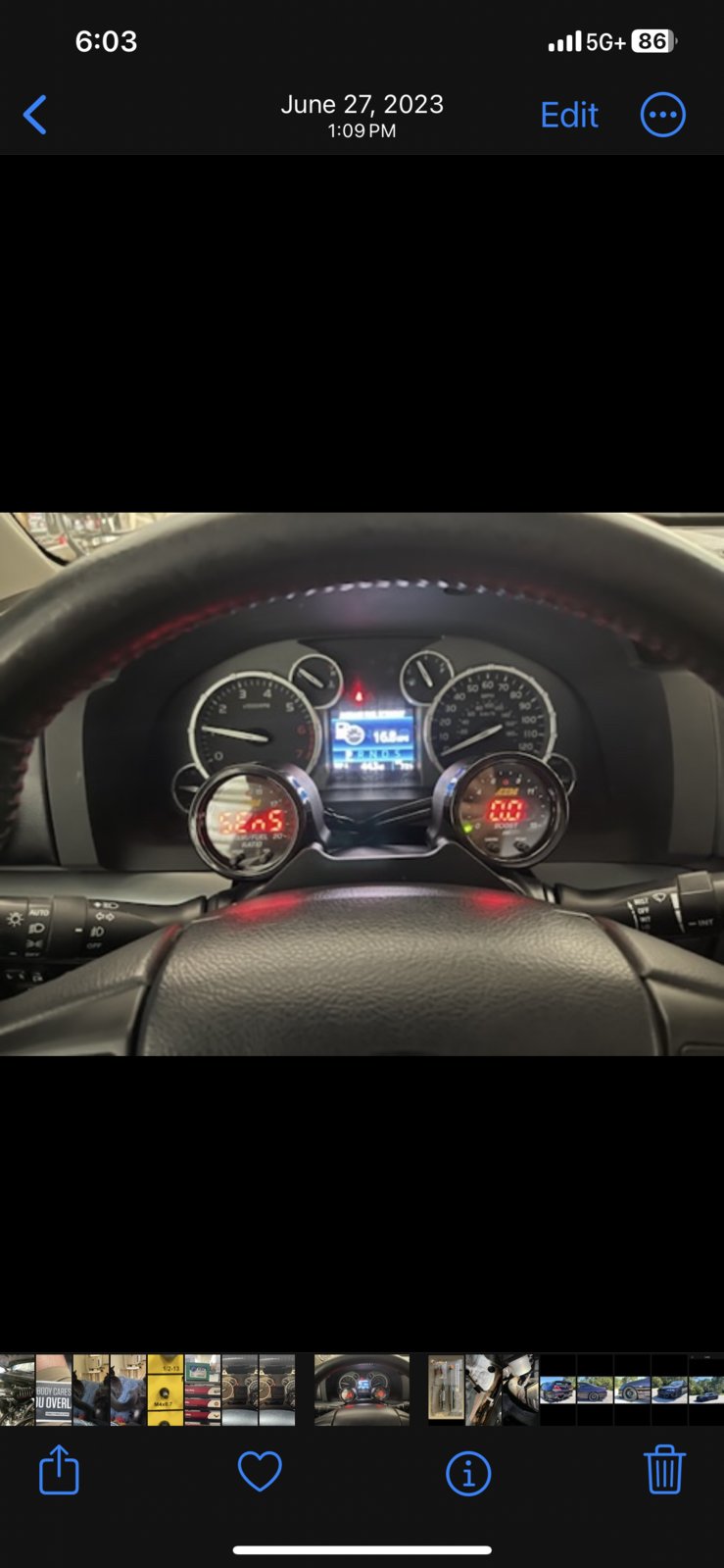

    Madness! What RPM is your redline with the built engine? Even at 6200 rpm, with a 2.0 pulley you’re spinning that sucker about 19k rpm and Eaton quotes the max at 18k, granted people over spin them all the time. It’s probably pumping a lot of heat for greatly diminished returns at that rotor speed. You would have much cooler IATs and I bet would easily pick up 50whp from just a bigger blower! Are you gonna go E85 with it as well?

    What mounting bracket are you using?! looks clean

    Aem here

    Craven speed

    Looks good! Thanks

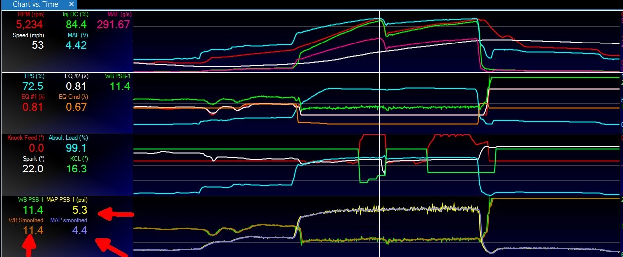

    Got the MAP and Wideband hooked into HP Tuner with the Prolink+. Pretty easy install, would take no time at all if you did it while installing the gauge. Well worth the $50 to have everything in one datalog. The PSB1 updates data 12 times a second, so playing with smoothing to make the lines a little easier to read.
