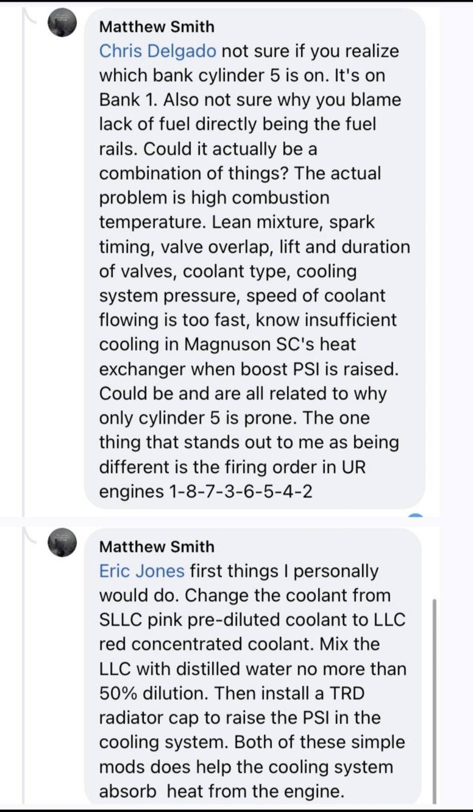

    Questions, are we running these super rich to keep the pistons and tight ring gap from overheating and thus wreaking havoc? With proper pistons, ring gap, and big fat oil to air oil cooler to supply the piston cooling jets with cool oil, can we lean things out a smidge?

    That's how it's explained to me. Weak-ish ring lands along with tight ring gaps are theorized to cause mechanical failure when hot. Richening past the normal 12:1 is strictly for cooling.

    Back in 2008 Lextreme did a tear down of the 3ur exposing its shortcomings when supercharged. Then when were experiencing failures it was found the short piston skirt and tight ring lands had little room for expansion. Matt Smith came on scene talking about the cooling system. Thanks @Silver17 for info on Matt as I'm not on FB.
    If your going to tear down might as well go with a true forged built engine.
    @ViktorG and myself had catastrophic failures.
    https://www.lextreme.com/forums/threads/3urfe-engine-exposed.9701/

    @Fastlane47 new engine is built by XAT and has corrected pistons and ring gap, he's making 15+ psi and right now we're targeting in the ~12:1 range for most of the rpm band. None of that I would attempt on a stock setup based on what @Mdl said.

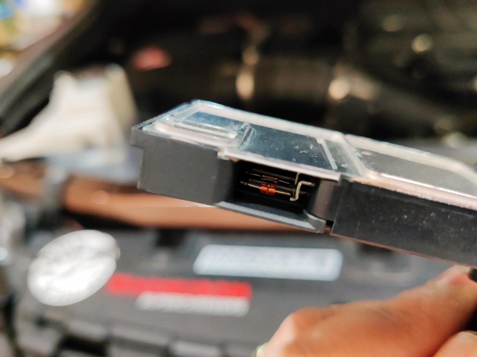

    Thanks for the interest in the MAF sensor we developed for our Turbo Kit. Keep in mind, ours is scaled to read a higher flow for the same 0-5v range, it does require rescaling of your MAF table. Included is a MAF scale sheet, with voltages plotted along with the corresponding flow, with flowing done on a 3.5" ID sample size. You will have to adjust up or down (probably not down) from there based on your MAF tube size using simple math and then monitor fueling to dial it in 100%. Thanks again for the support! :thumbsup:
