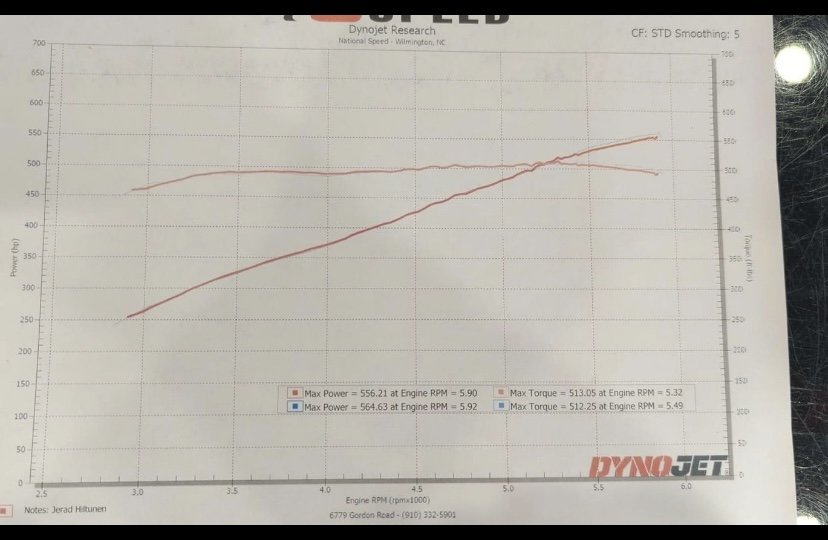

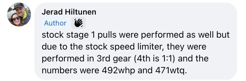

    Thought I’d share this post I saw on FB. Good numbers here I thought given a roller dyno, especially given the stock intake box. Maybe I should put it in the dyno thread. Hell even the base stage 1 is putting down some good numbers for just 6-7psi.
    Edit: look at that torque curve too. That is amazing. It’s like there is no peak to it, just straight gobs of torque all the way across the range.
