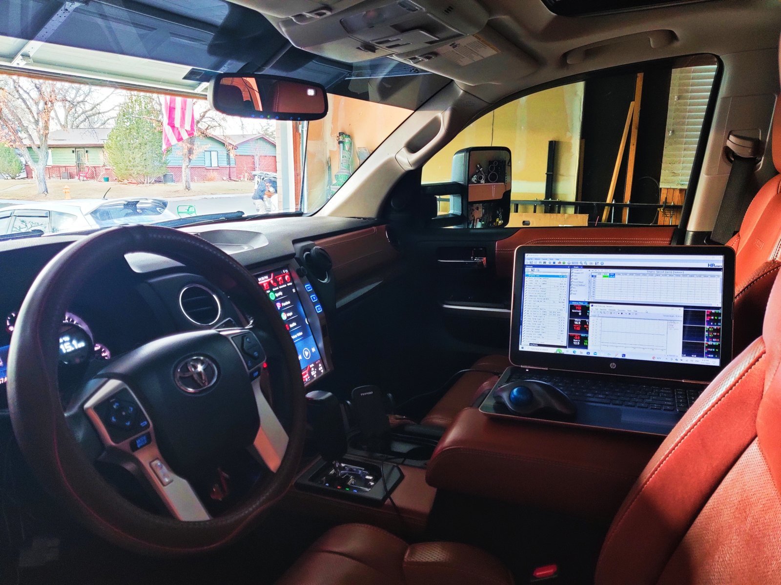

    I realized today that I have a problem...... Like a crack fiend I find myself hunting down open Wifi locations when street tuning, alot of times at Mc Donald's. Especially since my t mobile hot spot blows. Anyone else or just me? Just curious.:rofl:

    I bought a cheap reliable computer to be able to load a non W/M PE table. Got decent PE up to 7psi without W/M. Not worried if it got stolen or broke. Have tunes backed up on USB stick too.
    Can load at a free wifi area or Hotspot if needed. I could see it out in the boonies going up to someone's house asking for wifi access...

    Why wifi, you cant get any regular cell signal?
    ARES35[QUOTED] likes this.

    To Hotspot, cell or wifi, the computer to change up tunes on the fly.

    So you have no cell signal?

    I believe he was stating that he has crappy cell coverage to hotspot and uses wifi in a pinch. You need HPT to verify your VIN before you can write to your ecu.

    Yes sir when hot spot doesn't work. Get the "fail to int" error when no service...... Thus searching for wifi. This is only if I'm not in my garage out in the boonies though

    I have my oldest daughters highschool laptop, she said it was to old and slow years back lol. I use it and have it with me at all times at this point lol. Exclusively use it to datalog, monitor, tune...... The wife always bitches that it's in the way for it lives on the middle console:D. And if need be I would ask for wifi access say if shit was to lean or something. Offer maybe a bottle of liquor, kinda like asking a landowner to hunt on their land:rofl:
