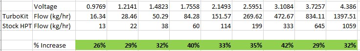

    Looking at the MAF from TurboKits (this thread: https://www.tundras.com/threads/turbo-charging-a-tundra.115951/page-27#post-3537022) they appear to have made a MAF that drops the voltage by ~30%:
    https://www.turbokits.com/2007-2021-tundra-5-7l-high-flow-mass-air-sensor-maf.html
    That's based off the values HP Tuners gives for a stock tune, and the little sheet that TurboKits has a picture of (for whatever reason they wouldn't just tell me that 30% value outright).
    Punching some numbers it sounds like a lot but is not as much as I would've thought. Since the MAF voltage is based on intake area which is a square function of radius, you actually get a 30% increase in flow roughly each size the intake is bumped. So the Magnuson 4" is a 30% increase over the stock 3.5". A 4.5" is a ~30% increase over the 4". 5" is a ~30% increase. Essentially a 0.5" larger intake is around 30% more area for the ranges we typically see.
    To some extent the TurboKits MAF makes sense at $175, but you're also not getting a larger physical intake. The Magnuson 4" might be a better buy if you have a stock intake, it's more expensive but not a lot more. A 4.5" or 5" intake is guaranteed to be significantly more expensive though and custom made, so at that point their MAF probably makes sense if you don't care to physically make the intake larger or if you still want to keep the stock style airbox. Food for thought, and very cool to have this as an option. Either way it'll need a tune update the same as an intake would.

    So a 5" intake and their maf would be even better. But also note this is on their blow through wonder how much that will effect us? Should I get one lol
