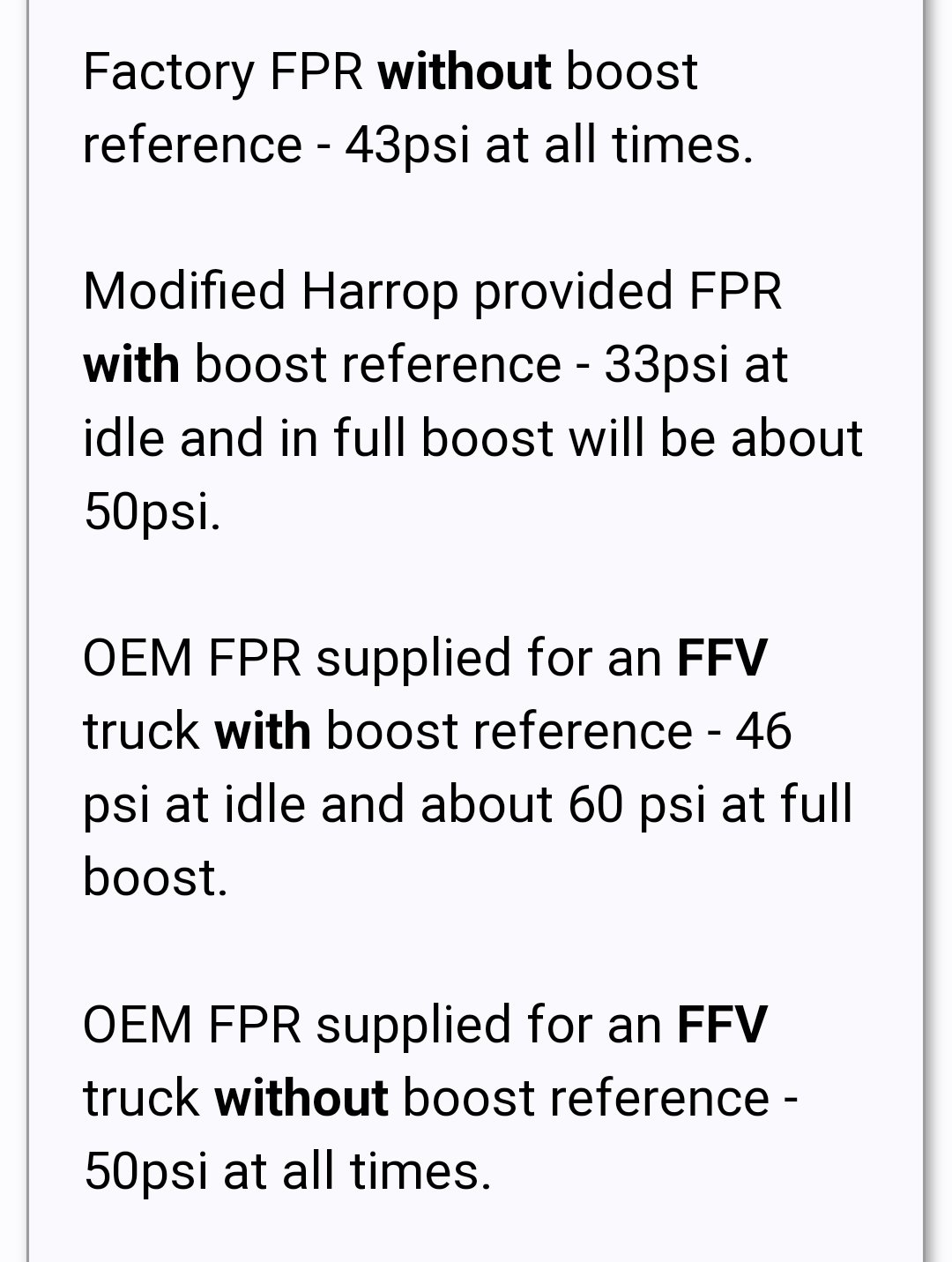

    Mine is set for 43psi and my boost reference goes to 58 psi. No idle issues.

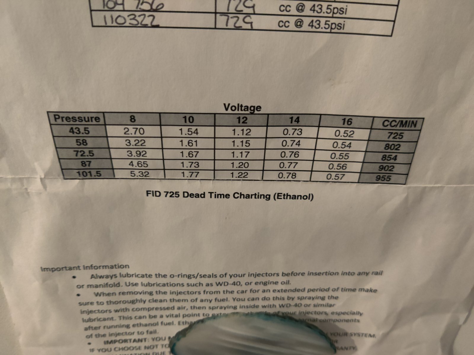

    Thanks @Mdl for the information. I'm set at 58 PSI charting, figured that's closest to 60 at 13-14 Volts at wot..... Having no issues at partial throttle/WOT. Right in 10-10.7 range with PE flatlined 1.4 but idle is killing me lol
    Also not sure why charting show as "Ethanol" seems odd

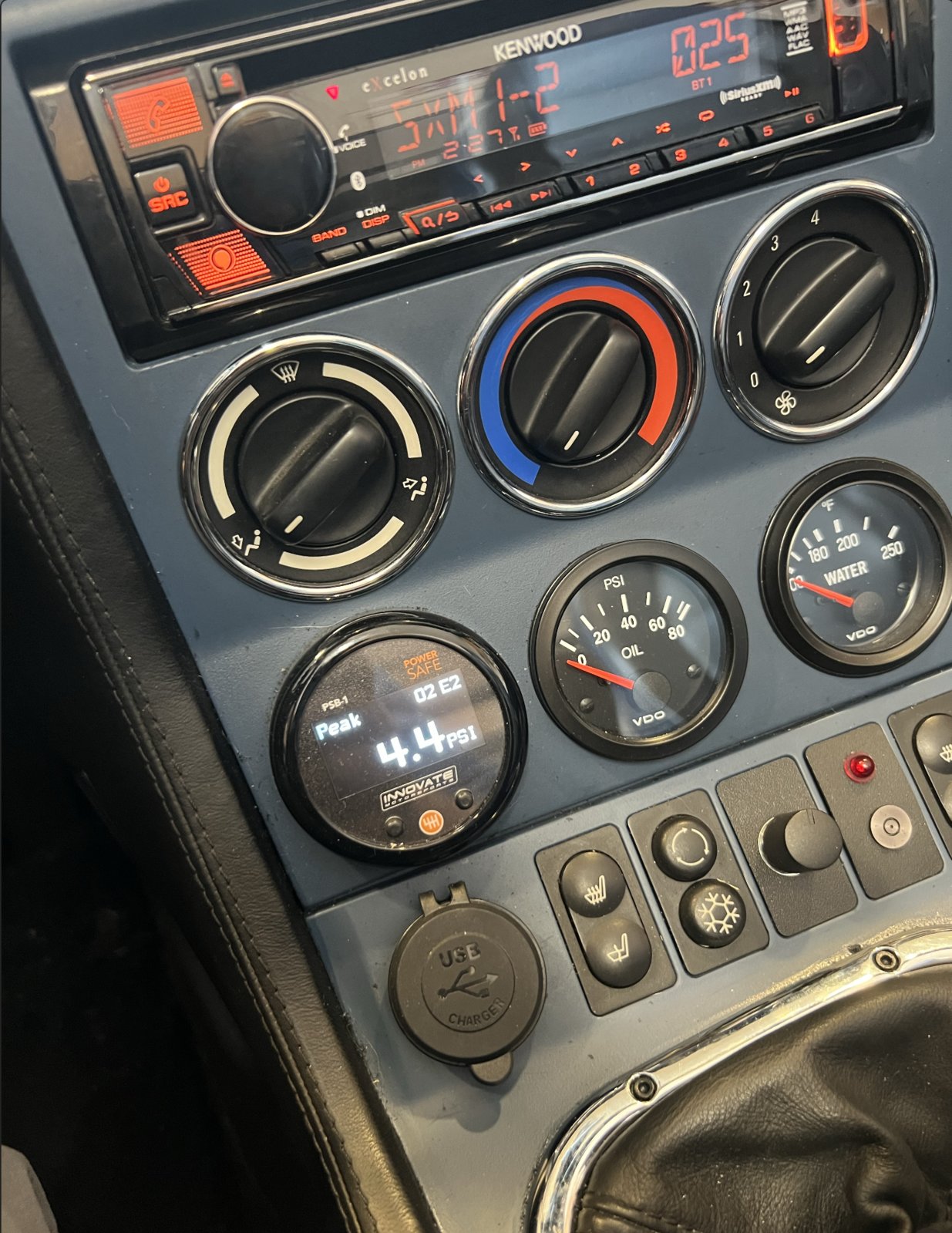

    BMW has boost!

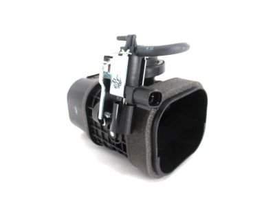

    How about a variable SABM? Always thought it would be neat to program the the old variable intake manifold function from the ECU to open/close it at a certain load/RPM.

    Installed one on my now sold 2009 Land Cruiser, never got around to finding someone to see if the ECU variable intake function can be adjusted. Same type of vsv vacuum valve operates this.

    Just the valve… was hoping someone around here would look into the control part.
    Valve is a Toyota OEM part. 17330-0A010 or 17330-20010.
