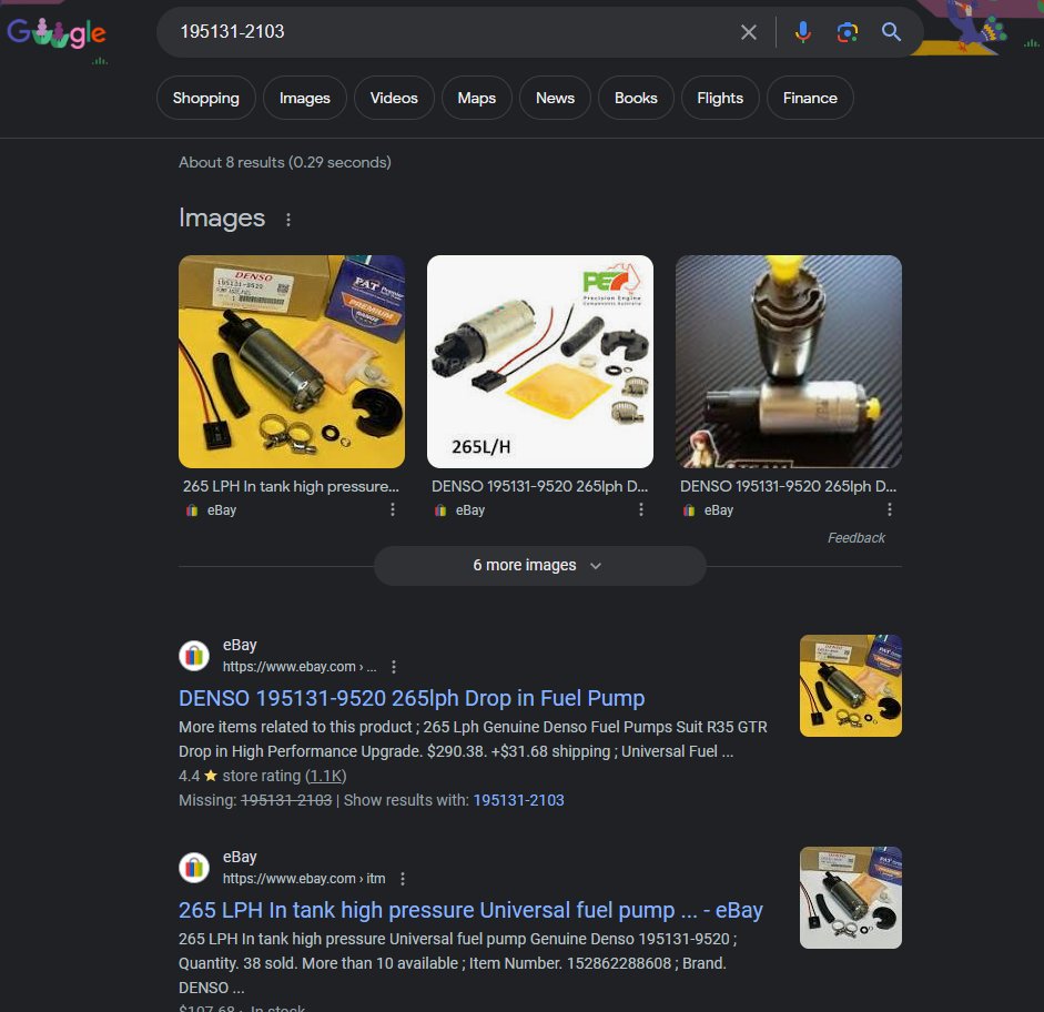

    yeah it pulls the 9520 PN instead - but the flow is close to what magnuson states for that one. 265 vs 255. Still doesn't add up though
    535's maxed out would need 282 at 3bar
    My brain can't believe that the pump is a 265 if when I upgraded to 650's, I'm able to provide more/enough fueling.
    Shouldn't the flow remain the same (maxed by pump) regardless if I upgrade injectors?

    Looking back at my data, the TRD Denso pump flowed 196 lph out of the FPR at 43 PSI.
    The Aeromotive 325 flowed 217 lph out of the FPR at 43 PSI.
    The same Aeromotive 325 flowed 353 lph with zero restriction, no pressure regulator.
    That flow would drop if the pressure was regulated to 43 PSI at the outlet, but I had no way of achieving that in my testing.
    Assuming the Aero 325 flows 325 lph with no restriction at 43 PSI and crunching some numbers together, the Denso pump would be "rated at":
    (196/217)*(325/353)*325 = 270 lph, very close to the 255/265 lph numbers you mentioned.

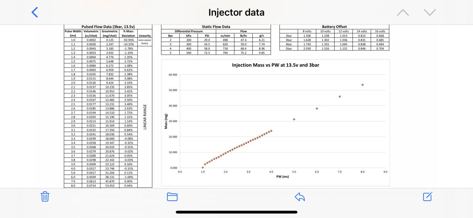

    Here is the flow data for the Harrop supplied DW650 injectors that I got directly from Harrop.
    Interestingly, their “650 cc” injectors flow 620 cc at 3 bar.

    My DW650s were all in the 650 range. I guess each person must check their individual flow sheet. upload_2024-3-19_15-27-45.jpg

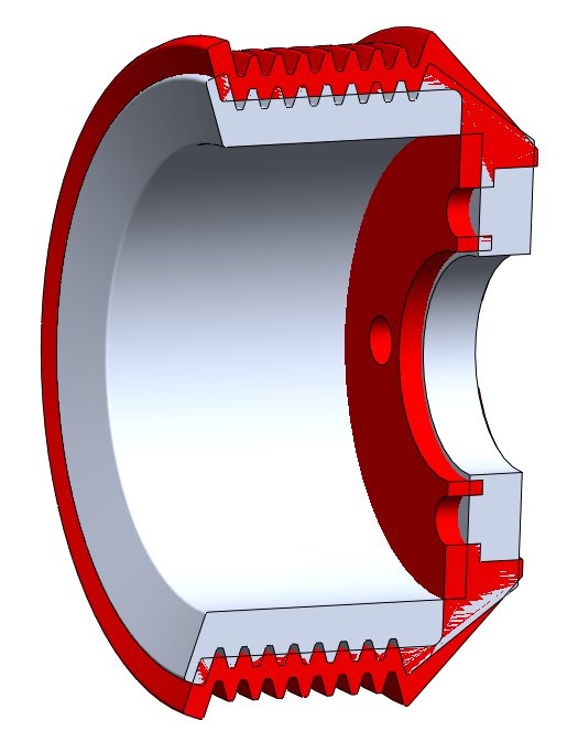

    I decided to look at how much of a Harrop pulley would need modification to run on the Magnuson, maybe it'd be better to buy Harrop pulleys and just machine them to work with the Magnuson. You only need to cut .124" off the back side and drill four holes, and then preferably sleeve it since the Magnuson has a smaller alignment boss.
    Except I go on Harrop's website and their pulleys are crazy expensive! It's $215 for one! And here I was trying to get price into a "reasonable" range for other Magnuson sizes, which I viewed as nearing $100 lmao. Modifying a Harrop pulley to work on the Magnuson would cost more than just machining a one off Magnuson pulley due to the pulley cost alone.

    I’m not saying the price is that much better, but it sounds like you may be looking on the Australian website and seeing their pricing. Check Harrop U.S.A. and they’re $165. It says backordered but I bet if you email @Chris@Harrop he could get you true availability. Keep in mind these have the Griptec technology so I’m sure that adds to the price a fair amount. https://www.harrop-usa.com/harrop-8pk-supercharger-pulley-+19.8-offset/p104

    Ah good call, you're right it was the Australian website :annoyed: $165 is a good bit closer to what I would've thought

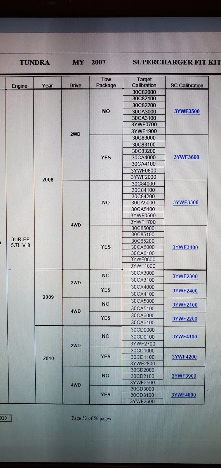

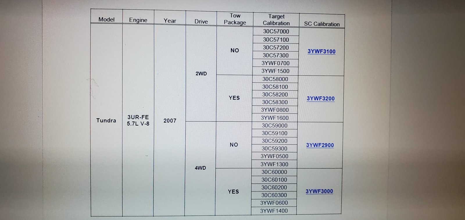

    Is there a way of knowing if a supercharger calibration was offered for a specific calibration ID? If someone knows their current ID is there a list or some identifier to know the TRD calibration existed for it?
  18. Mar 20, 2024 at 11:05 AM
    helidave
    helidave Hellacopter
    Oct 3, 2018
    #20151
    1,431
    flagstaff
    2015 DC 4x4
    Magnuson 2650 w/76mm pulley, ADS suspension, 35's, misc overlanding bro-trophies
    You would think there must be a way. All the supercharger cals in my VFT repository are YWFxxx instead of something like OCLxx. So it's not as obvious as just matching up the file names.

    I remember for the TRD tvs 1900 there were specific Calibration ID'S for different years until Toyota stopped offering it. When I was on tundratalk I thought there was a list with Vin and cal id's.

  21. Mar 20, 2024 at 11:32 AM
    snivilous
    snivilous [OP] snivspeedshop.com
    Apr 16, 2019
    #29192
    5,021
    SW UT
    300k+ Supercharged 2008
    Awesome that's what I was hoping for! I'll add that to the home page too.
    EDIT: "Supercharger fit kit calibration" comes up with multiple documents and at the bottom lists what stock calibration and what corresponding supercharger one is. Though there seems to be multiple documents, and my truck for example has 3YWF3400 which doesn't even show up in the documents I'm looking at even though it's a supercharger calibration. And different documents list different factory calibrations. So if someone is looking if their factory calibration does work, I would take those documents with a grain of salt.

    I can send it in a pdf its in the last 2 pages. Those were just screenshots from the 2010 SC install.

    I found a few documents online so you're good, I got it!

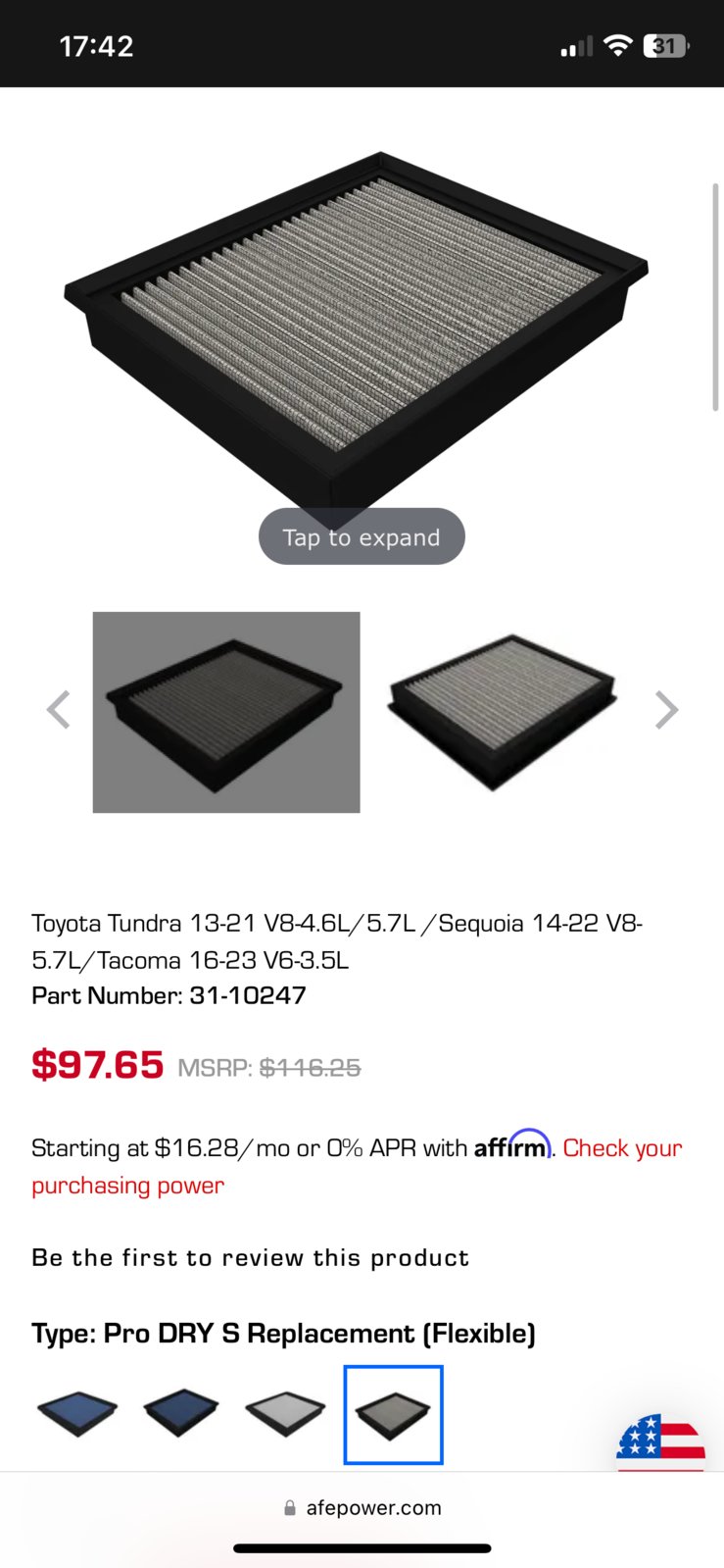

    Afe dry filter or even stock paper for the win.
    I'll run a wix paper filter when I'm cleaning the afe.

    This the one?

    Or this one?

    I went from the TRD Air Filter to the Wix...*cough, this reminds me, I have a TRD filter in near perfect condition available...cough
