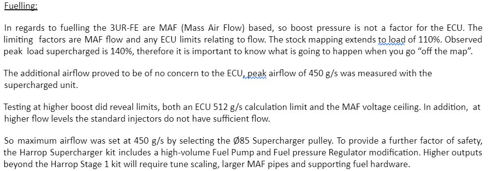

    Agreed grams/second appears to be the units. If you refer to the Harrop technical guide you may recall that max g/s measured on the 85mm was 450g/s which is why they chose that pulley for their tuneless option. It also stated that at the higher boost levels the limit they discovered was 512 g/s as well as the voltage ceiling.

    yup. I think your right - i was just reading that.
    I will wait for dry pavement...and see if I can reach 500.
    I can dig it if it really is grams per second, as I know 512 is my top.

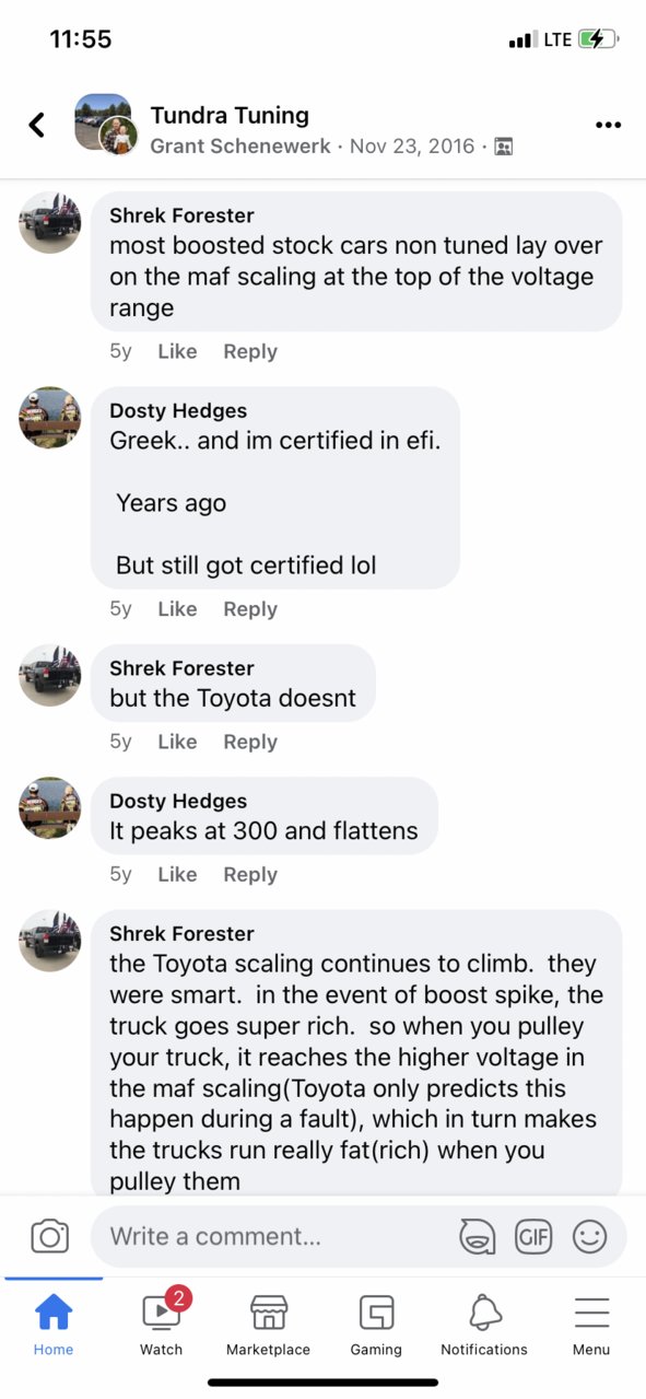

    I was digging into some old posts regarding the MAF on some Facebook pages. I found posts with Shrek talking about maxing out the MAF. Sounds to me based on this that it running lean “off the map” is unlikely. It will go super rich if anything as a protective strategy. If it runs good when I’m done tuning I’ll probably just abandon the idea of getting a bigger intake. I think I’m just over analyzing at this point. Like Viktor said, not lean and no codes your fine.

    My tuner had to re-scale my maf due to maxing the airflow. Since then I tripped PO103 once at the top of 3rd gear. I just reset the code and went on. Probably a result of the outside temp being really cold(25) and doing Dragy runs. It should only pop the code if the airflow is exceeded for more than 3 seconds, if I remember correctly. Unlikely to happen again.

    This jives with D3’s words
    my tailpipes were black with soot after dynos
    They left if super rich under load
