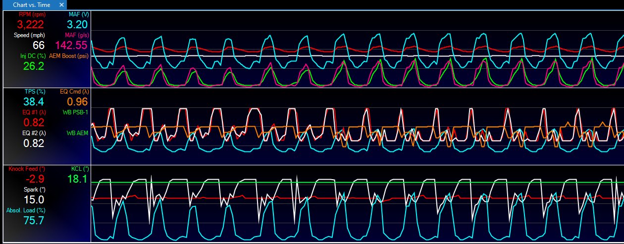

    Back to surging cruise control. Anyone have any insights into this? Not happening on my truck, and I've heard of it before and now have two people I've tuned with the same issue. Not sure what is causing it, different year trucks, though both have a Magnuson 1900 (though I don't think that has anything to do with it). There was a thread that didn't go anywhere from 1.5 years ago about someone detailing the same issue, though they did not mention it being supercharged but just that it happened after they got it tuned: https://www.tundras.com/threads/surging-cruise-control-after-hp-tune.115852/
    I'm not sure where to start and want to avoid sending tunes to minimize brickage chances, but if there's no leads then the only solution is someone else tunes it and hopefully doesn't have this issue, or I change half of everything at a time to try and whittle away to the specific variable. And it doesn't happen to my truck so can't test anything personally.
    Truck ends up in 4th gear, torque converter unlocked the entire time. Starts in 6th locked, then cruise activated and cycles unlocked 4/5/6 before settling in on 4th so I'm hesitant to say it's a transmission thing, though maybe forcing the converter to lock up would stop it since the rpm would be more tied into the speed so it can't just do the unloaded revving? I don't know.

    No issues with my cruise control. Use it all the time. But I have tweaked my shift points and TC settings so it takes more throttle to make it downshift and the TC is almost always locked in 4-6. No idea if that makes any difference in your situation.

    Do they have many miles on the tune? The first time I used cruise after the SC install and tune, my truck did a similar thing - it stuck in fourth for 5 or 10 mins when it definitely didn’t need to be. I dropped it in to S Mode and manually pushed it to 5th, then 6th. I may have needed to disengage Cruise then push it up a gear, then re-engae Cruise. But I didn’t really have the same issue after several trips with Cruise on. It was still happy to downshift and scoot, though.
    Years ago, my buddy had a Cummins powered dodge (well a couple - one of pretty much each generation) that we used to haul countertops. After picking up material a few states away and driving home with the cruise on, the vehicle would downshift and surge forward 10 or 15 mph whenever you set it without the trailer hooked up. I think it was expecting a heavier load and throttle up appropriately. After 100 miles and several applications of cruise, it was back to normal.
    I wonder if the ECU on our trucks is doing something similar, but the extra power it’s getting makes it think it needs to be in a lower gear until it re learns itself. Just a guess.

    I’ve seen that happen if the throttle opening angle is maxed out in the “torque limit” (or whatever that table is called, can’t remember off the top of my head). Usually happens on newer trucks.

    That was one of the tables I was suspicious of. I'll try that, thanks Viktor!

    And @ViktorG was on the money! Reset the torque limits tables back to stock and it fixed it.

    I am glad that fixed it! It's an interesting issue, that only happens on some trucks. In my experience, most 2nd gen are fine, but some 2.5 gen have the problem with cruise if the torque limits are removed. Don't know the exact years or calibrations that are affected.
