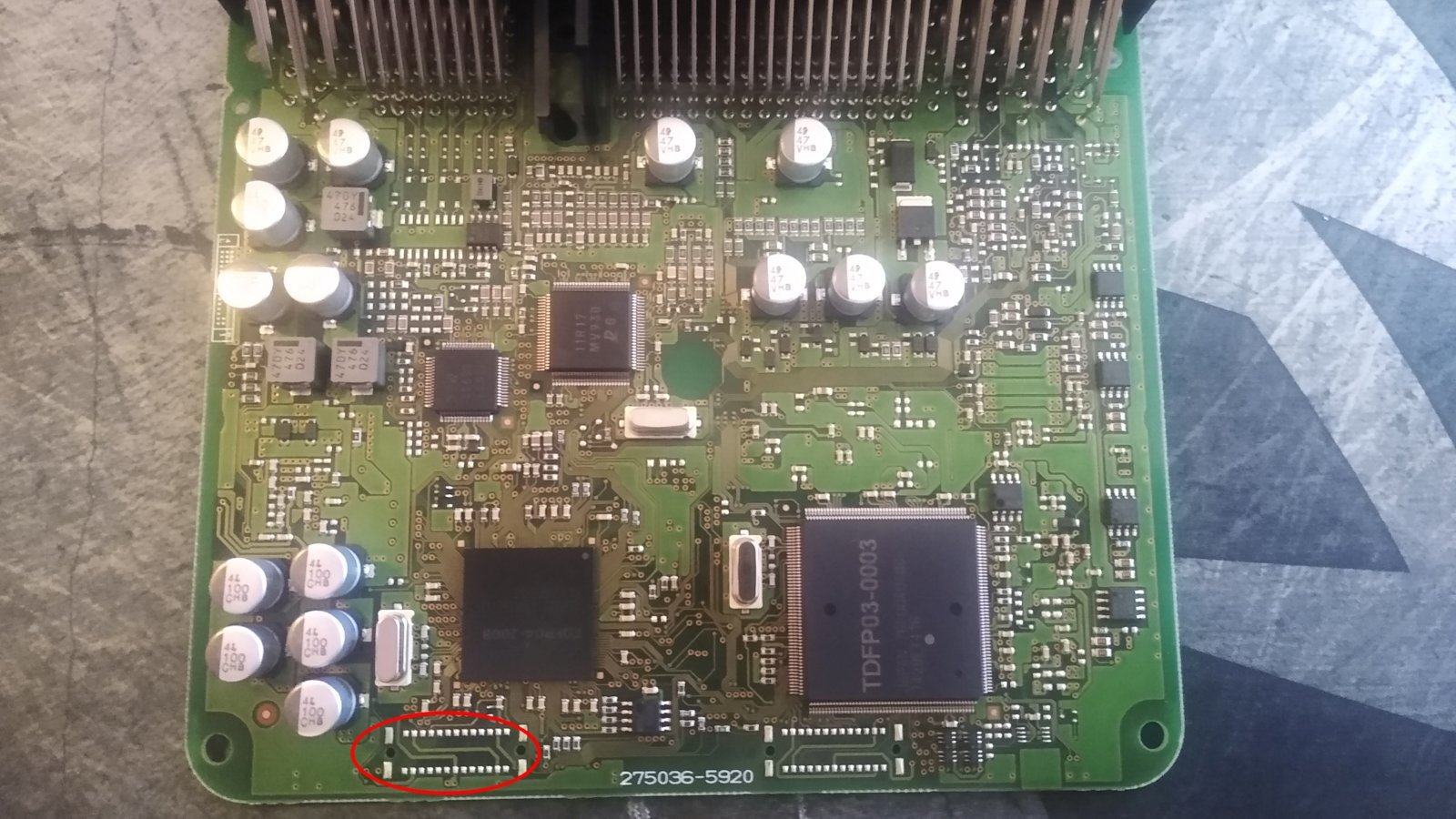

    helidave
    helidave Hellacopter
    Oct 3, 2018
    #20151
    1,431
    flagstaff
    2015 DC 4x4
    Magnuson 2650 w/76mm pulley, ADS suspension, 35's, misc overlanding bro-trophies
    IT'S ALIVE!!!!!1!!!!!!1!!!1 :bananadance::dancingbacon::broccoli::burnrubber:
    It looked like the ecu was dead for good but I decided to try and combine VF's bench recovery method with an HP flash just as a hail mary and it actually worked. Truck started right up and seems to be running fine.

    helidave
    Oct 3, 2018
    #20151
    1,431
    flagstaff
    2015 DC 4x4
    You have to take the ecm out of the truck and take it apart (pain in the ass), so you can solder a resistor onto the board, then you reinstall the ecu in the truck and flash it, then remove the ecu, remove the resistor, put the ecu back together, reinstall, and if you're lucky it will be fixed.
    I guess the resistor forces the board into boot mode or something. Tried the process a couple times with the VF Tuner recovery function, and it would say it took the flash but the truck still wouldn't start. I figured it was worth a shot to try the resistor thing and writing the tune with HP, since that's what bricked it in the first place, and it worked.

    armyoffoo

    ZPhilip

  20. Mar 3, 2024 at 11:32 AM

    Wynnded
    Wynnded What MPG...
    #379
    5,711
    Rockies
    Souped up truck
    In my case it was a 1k ohms resistor, and where it's soldered is ECU dependent. That's probably why Mat requested a pic of his board.

    helidave
    Oct 3, 2018
    #20151
    1,431
    flagstaff
    2015 DC 4x4
    Yea, there's 26 little pads on the board that you jump 2 with a 1k resistor. No idea if it's the same for different versions. One thing I've learned is there are a ton of tundra ECUs
