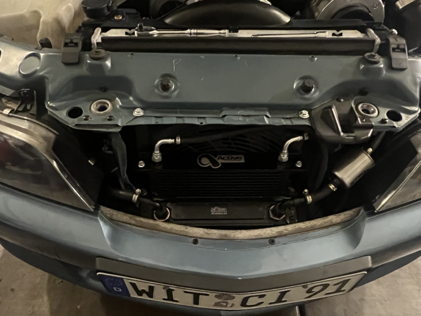

  12. Mar 2, 2024 at 11:07 AM
    e30cabrio
    Oct 20, 2017
    #10410
    6,125
    West Valley, Phoenix, Az.
    Boosted 2013 Sequoia TRD FAUX
    For those upset over getting the belt on a Tundra.
    Been wrestling it for 2 days.
    Fastlane47 and ARES35 like this.

  15. Mar 2, 2024 at 11:22 AM
    e30cabrio
    Oct 20, 2017
    #10410
    6,125
    This is an S52 with S54 oil filter housing & oil cooler/hoses that are in the way. my arms are a mess, look like a cross between poison ivy & chickenpocks.
    Modding is such fun!!!!
    Fastlane47 likes this.
