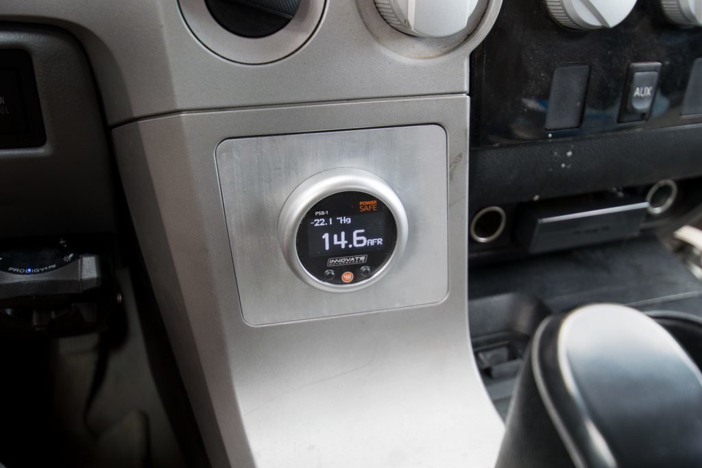

    Older ones I really like this mounting spot:

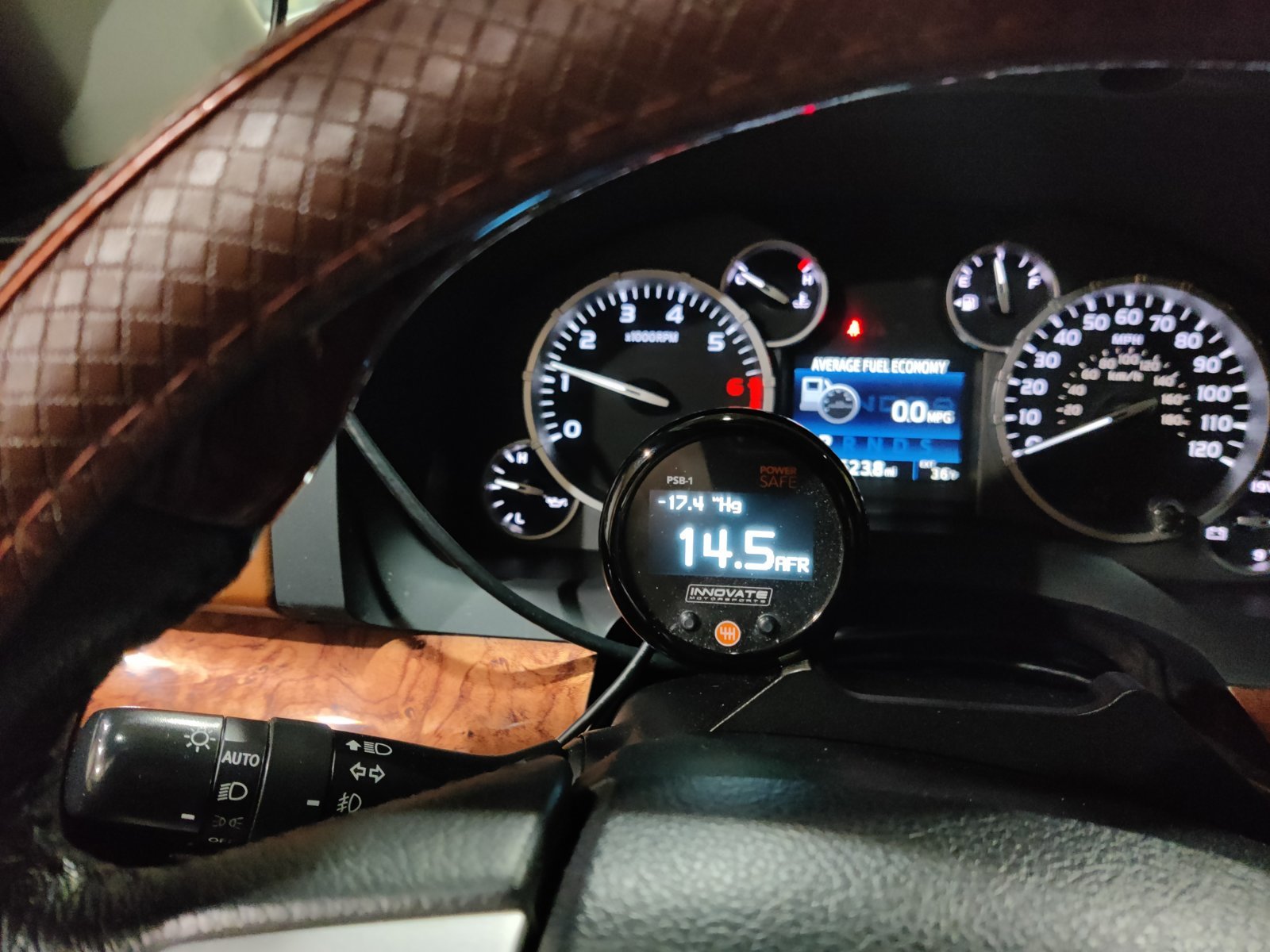

    PSB1 on a craven mount. Has both boost and A/F ratio.

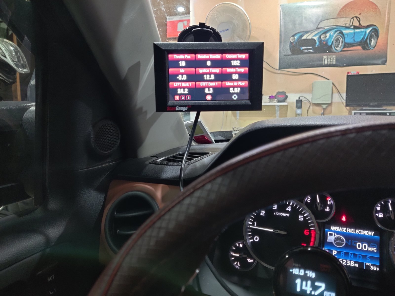

    Thanks guys. I run SC2 presently, gotta check to see if it's already loaded or if I got to program the PIDs.
    I don't have a SC2 in the '21, yet. want research what is most observable and looks good as well.

    I also have the SC3 but datalog via VCM scanner so much I don't use it.... Yet. SC3 won't log A/F you need a wideband.

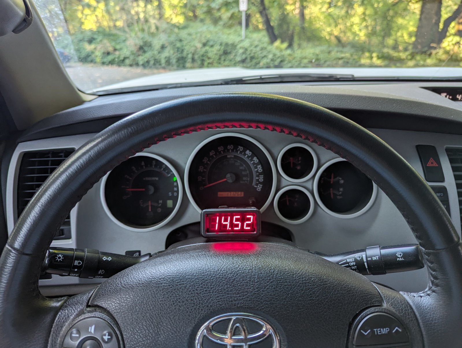

    Ballenger Motorsports Wideband. A tuning/racing wizard friend of mine swears by them, supposed to have a better heater circuit that doesn't burn sensors as often.

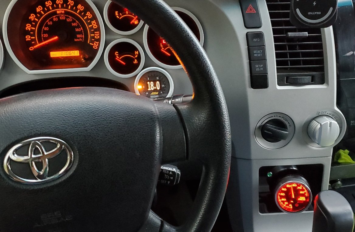

    Thanks for the idea! Fuel psi sits nicely with a water/meth active light. Black acrylic works great.
