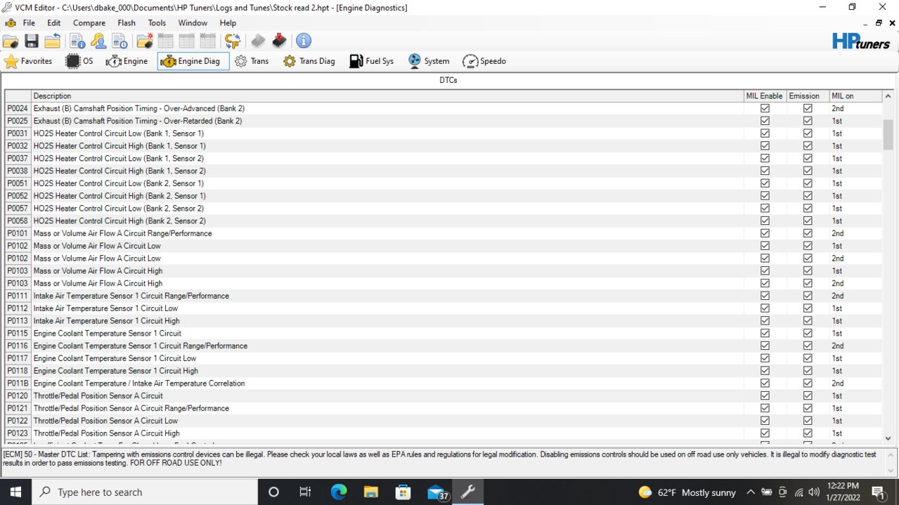

    Have to go to *Engine Diag* to control MIL/codes with HP. Don’t follow the latest in tuning but believe this is or was an advantage for HP vs. others. I looked through a TRD tune and the P0101 was not disabled.

    Cool! I had no idea you could do that. Now the question is should it be turned off or not? I still get the code occasionally, at least since winter has come.

    Just checked my current tune file. Mine is also not disabled, yet anyway. It was also said that some not all of the trd files were like that.

    The MAF measures the amount of air going into the engine and is the most important sensor that is involved in the fuel delivery calculation.
    It is used both during closed loop and open loop operation.
    During closed loop (light load/cruise), the ECU looks at the MAF, injects a certain amount of fuel based on the MAF reading and then looks at the A/F sensor output.
    If the A/F sensor says the mixture is leaner than stoichiometric (14.6-14.7:1 AFR), it will increase the short term fuel trim to add more fuel.
    Conversely, if the A/F sensor reads richer than stoich, the ECU will decrease the short term fuel trim to inject less fuel.
    If the short term fuel trim stays positive or negative for a while, the ECU will change the long term fuel trim to compensate and try to bring short term fuel trim close to zero.
    If the combined fuel trim (short term+long term) exceeds +/-35%, the ECU will set system too rich/system too lean fault codes.
    During open loop (moderate/heavy load, based on the power enrichment throttle angle input), the ECU looks at the MAF only and ignores the A/F sensors.
    It will inject fuel based on the MAF, RPM and fuel enrichment tables.
    It does not care what the actual AFR is and has no safety built into it if the engine runs super lean or super rich, other than backing off ignition timing based on knock sensor output.
    The MAF voltage goes up as the airflow increases and the maximum MAF voltage is 5 volts.
    Once there is enough airflow through the intake pipe and the MAF is maxed out, it cannot read any further air mass that is going through the intake pipe.
    If the MAF stays at 5 volts for longer than 3 seconds, P0103 Mass or Volume Air Flow Circuit High Input fault code is set.
    The smaller the intake pipe diameter, the less air mass will be needed before the MAF is maxed out, therefore with the stock NA pipe one can only push so much air through it before the MAF hits the ceiling.
    The ECU will inject fuel based on the 5 volt MAF reading, regardless of how much air is going through the intake pipe, so the AFR will start leaning out as RPM increases, since the ECU cannot measure that extra air.
    This can be somewhat adjusted for in the tune by enriching the mixture more as RPM increases past the point where the MAF is maxed out.
    However, the best way to address this is to increase the intake pipe diameter and re-scale the MAF table accordingly, which will result in lower MAF voltage reading for the same amount of airflow.
    P0101 code is not related to the MAF being maxed out.
    It is set when the calculated vehicle load does not match the expected MAF output for that load level and the fuel trim is under -15% or over 15% under certain throttle conditions.
    It is generally related to the MAF table not being scaled correctly for the intake pipe diameter.
    Can also happen if you operate the vehicle at a very high altitude since that will affect the density/mass of the air going into the intake pipe.
    Neither the p0101 or P0103 code will affect the way the vehicle runs when they are set and both can be disabled with HPTuners if one wishes.
