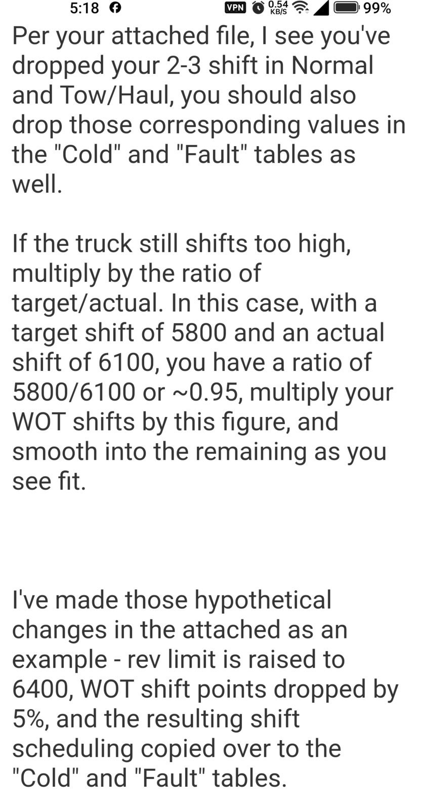

    Anybody know how to soften up the 2-3 shift with HPT? It really slams into gear at higher load/rpm compared to the others.

    I haven’t personally done this - or even tried, really- but over on the HPT forum I recall seeing SlowNStock taking about pulling timing right before the shift as an OE strategy to softening shifts without increasing shift time or decreasing line pressure and risking trans clutches. I will see what I can find but perhaps look in that direction.

    I had the hard 2-3 shift try this per SlowNStock. Works like a charm

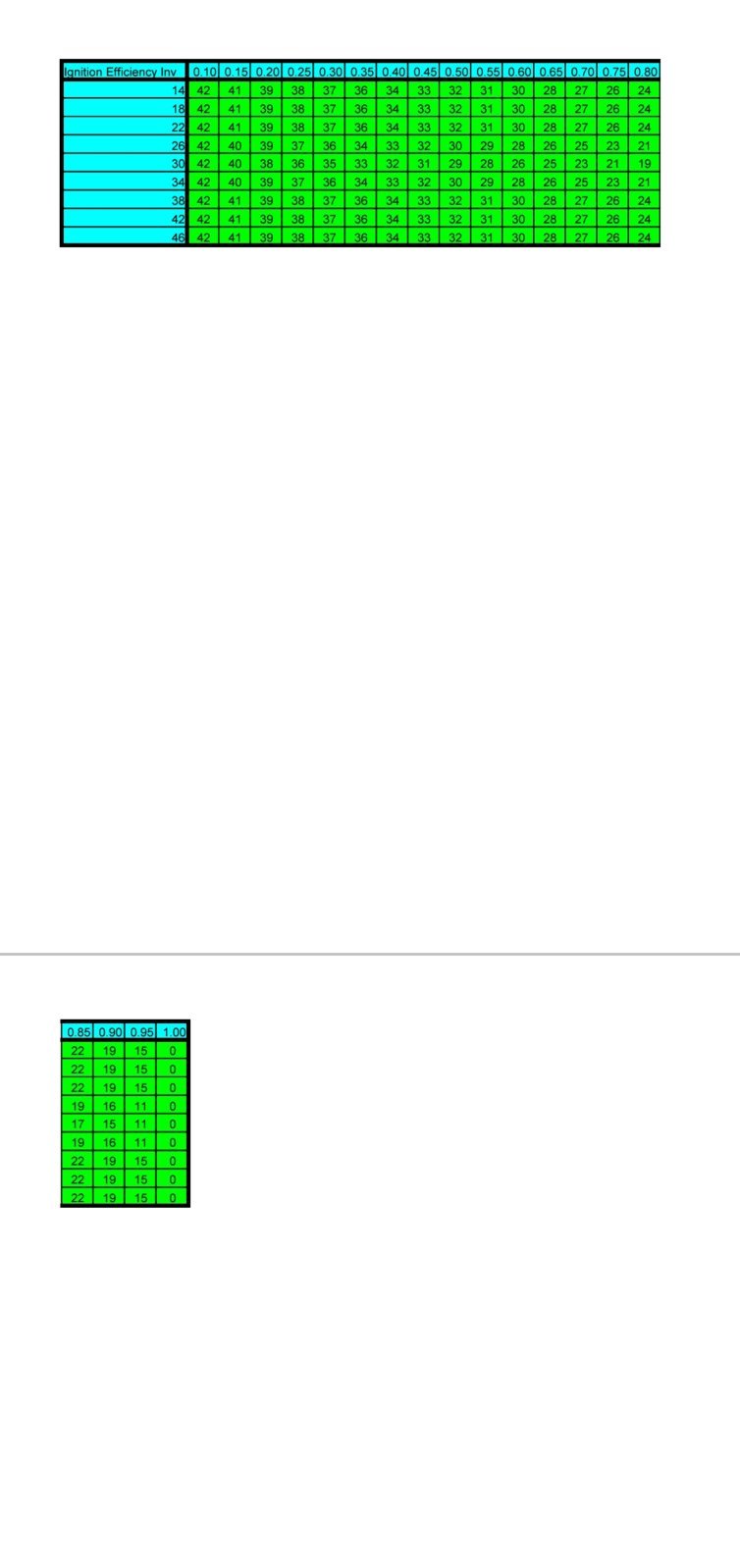

    Another option besides the above might be to increase torque reduction for 2-3 shift
