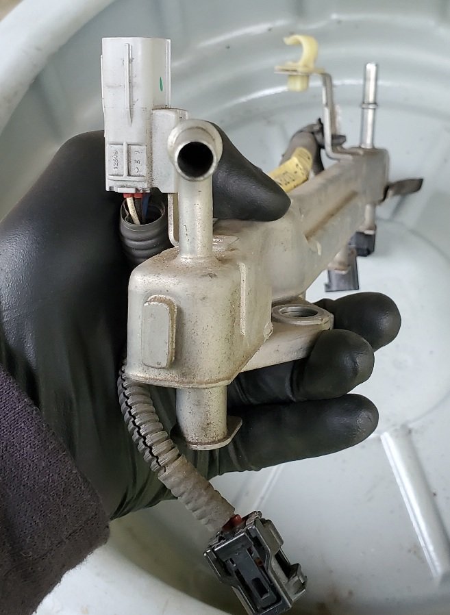

    I'm running walbro 450, denso 750's, AN-6 supply and return with stock fuel rails with Matt Smith mod. Remove the end flares on the inlet and outlet. Works just fine with 43psi to 55psi under load.

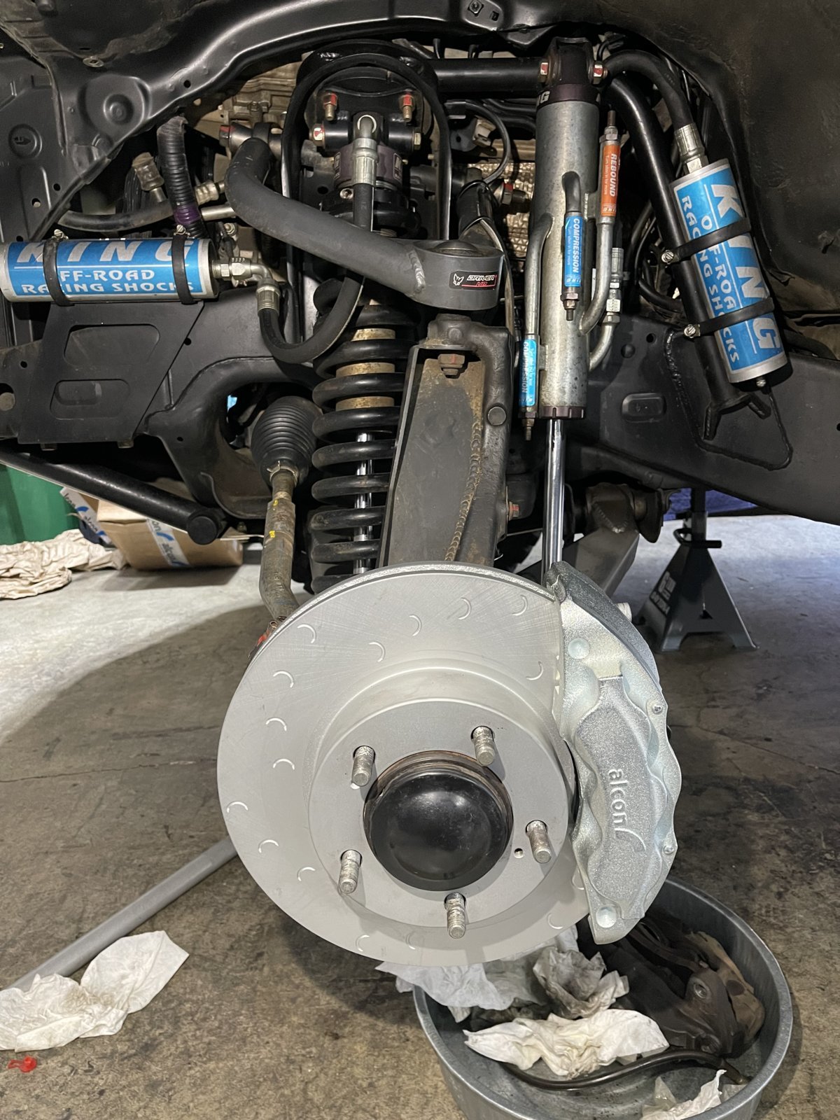

    Woah with the go finally going in

    Let me know how just fronts work
