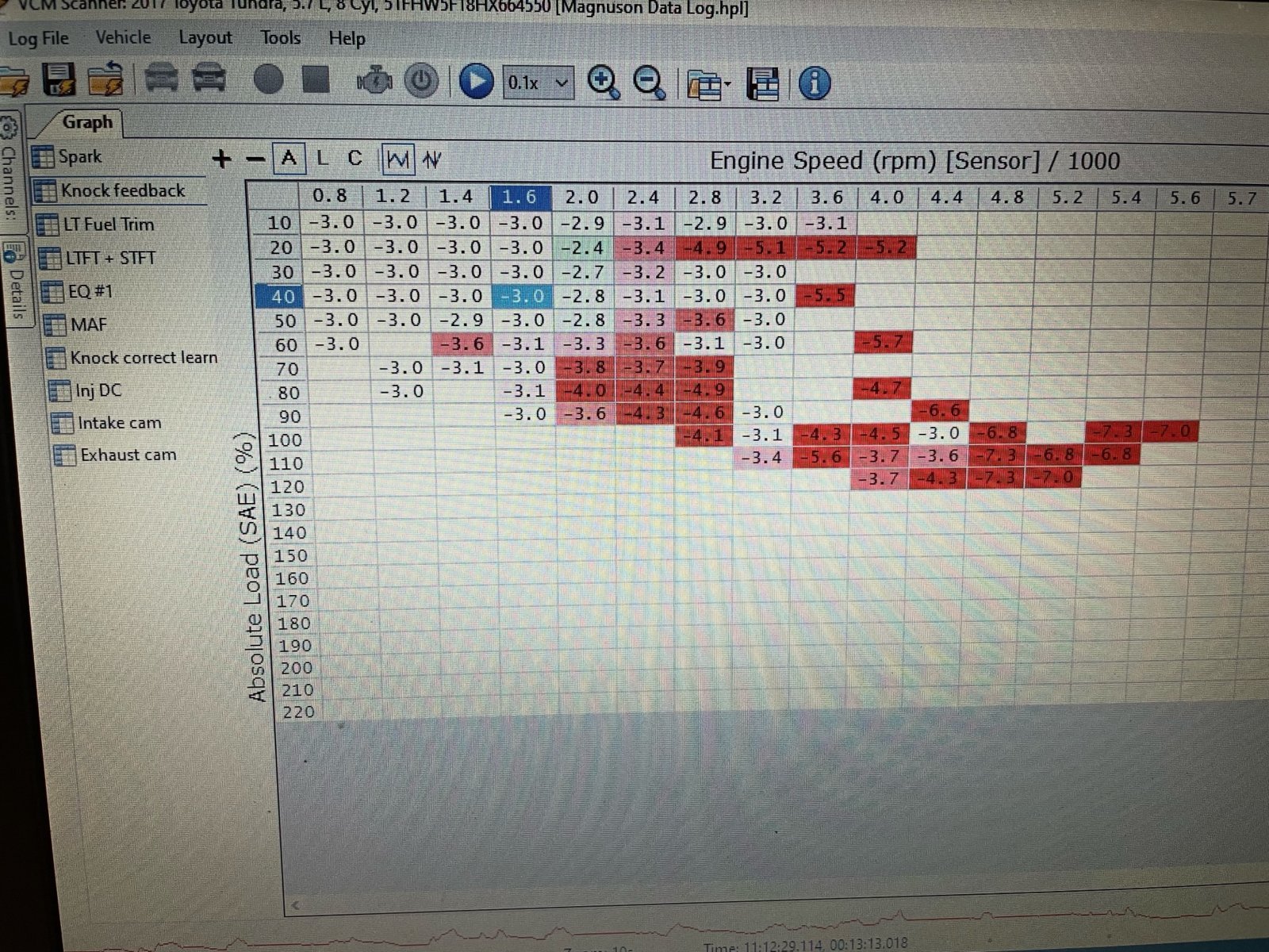

    Curious also about low elevation logs on Maggie stock map. Mine was riddled with knock and ran lean as hell, into the 12's. And I'm at 5k

    Here was a log with my Maggie provided tune at around 1100 elevation. Not ideal by any means. This was on the 1900, not sure if they've made any changes in comparison to the 2650.
