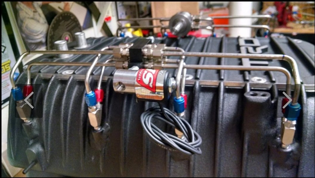

    @blenton you remember that bad toy guy doing the 6.2 build and running NOS around 2014? At least AES should have a runner available. Just drill and weld those ports in!
    Discussed methanol back on pg. 386 with an article from prometh. Will wear coating over the long haul but not damage bearings.

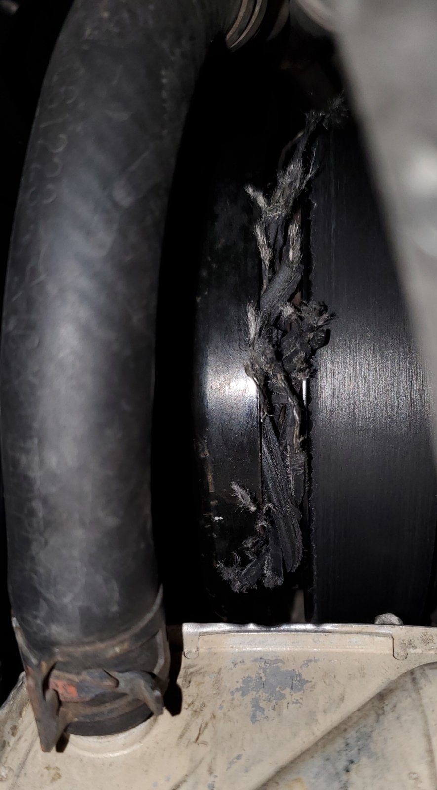

    My idler pulley froze and think it jumped when I got on it. Somehow the AC clutch ate the edge of the belt. Now rocking a 6 ribber. Upgrade to Gates green coming up.

    I had a similar experience on my LSA, welding the accessory brackets warped them enough for it to jump teeth, except it devolved from a 6 rib belt into a 4 rib belt due to the edge of the AC pulley :D

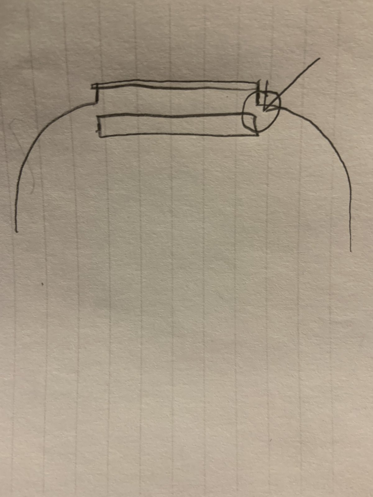

    At least on my Harrop the air comes out of the rotor discharge straight through the 2” thick intercoolers into the intake. On those remote coolers the air has to do a total 180 degree turn through what is also a much thicker intercooler. Seems pretty clear to me which is a bigger restriction. Rapid changes in the air direction of travel drops pressure. Bottom line is, trying to give the pressure drop though a water to air intercooler in a supercharger any consideration is a waste of time IMO.

    Forget the heat exchanger core for the moment, rather, look at how the air enters and exits. My point is that the air doesn’t have equal access to the large heat exchanger face, at least in the Mag TVS R1900. The area for it to spread out and enter the complete face appears to be on the slim side.

    In regards to the purpose of your post, I would think the struggle with spacing the intercooler and lid farther upward would further block off the air path down into the sides of the housing as shown here based on how I recall the 1900 being designed. I do agree that a 3/8” gap for the air to pass through is pretty restrictive.

    Your drawing is spot on. It’s not simply the space, but all that air has to make an immediate and very sharp 90 degree turn, very little radius there. Even a small increase in the lid height could produce results here. There is some material that can be machined out of the main body/case in the area you have circled.
    As above, so below… the area between the rotor outlet and heat exchanger is also small.
