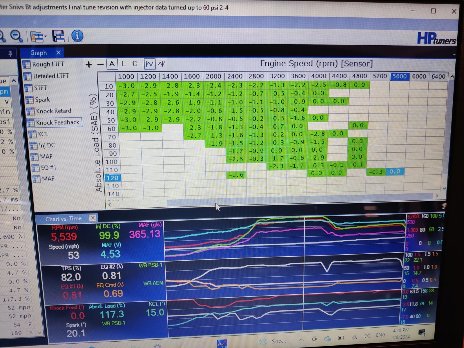

    Question of the day, in this instance on 750 injectors. Stock FFV FPR is rated at 43psi low speed and 55-60 psi high side non boost referenced from what I've read. With that said do you guys tune your injector offset vs volts to the idle pressure of 43 psi or the high side of 55-60 psi? Looks like @43.5 psi CC/min is 725cc whilst at 58 psi CC/min is 802cc.

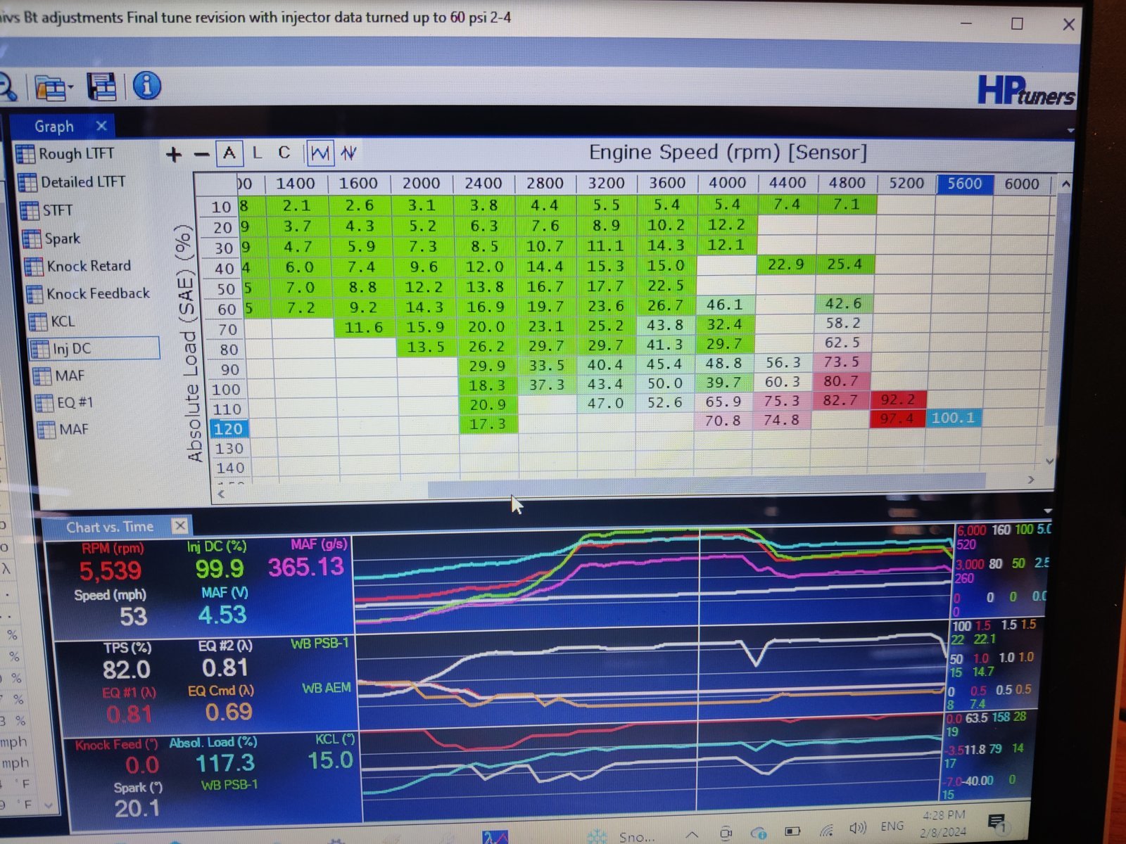

    Understood I started with the base of 43psi charting. Once I jumped to boost reference and WOT PE tuning I was always running lean on top now matter how much fuel I throwing at it.

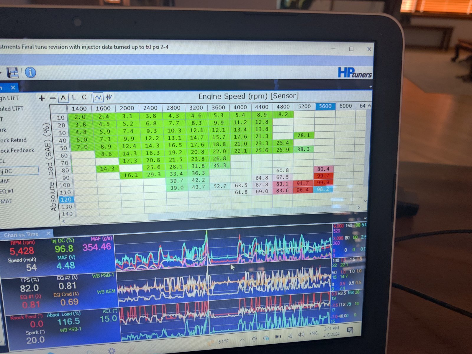

    She's running like a banshee at 58psi charting, I'm now concerned about injector duty cycle. Trims are great, knock is non existent, PE is rich....... But these InjDC values are insane...... And I haven't even touched timing for more power lol

    Yes sir I am currently fine tuning PE a wee bit leaner. But God damn I'm out of injector on prospeeds 750s already. Granted this is on the 76mm pulley where up high the muthfucka just screams..... It scares people

    While in the realm of possibility for sure, something feels wrong to me. No one with comparable setups is maxing out 750s (well 800 in your case). @Wynnded isn't that much higher elevation and running the 70mm. @helidave just put on the 76mm and is running 535cc I thought at like 7000-8000ft. Like I said, seems impressive it's requiring that much fuel.
    Was it at 100% duty cycle before adjusting the injector offset? Or did you change the injector constant too? I don't understand why injector offset would change it much since I thought offset was just how premature does the injector fire to get the timing right, I don't see why that would affect fuel flow.

    At the 43 psi charting I would max out at 86%. My injector constant is set @.10 with an Inverse of 2.3. I did have my Constant in the .12's but my MAF Volts was getting out of wack trying to get more fuel. So I backed off and went back to .10. I agree something seems off for im mile high...... But trims are within 5, -3.0 and lower in KFB throughout so I'm not sure.

    Lat run I logged at 7000' with 535's and the 76mm pulley mine maxed out at 89% DC at 5700rpm, holding mid 10's AFR. That's with boost referenced FFV and whatever injector settings @snivilous set it up with.

    Interesting. I'm not sure why im maxing 750s at this point especially in thin air. Granted I need to lean out some but injDC is still up there:notsure:

    I'm not sure but I just assumed more pressure at the FPR with increased values at voltage pushes more fuel. Figured especially up in the 14/16 volt range where PE really kicks in and dumps fuel. But I have no idea and am just assuming and probably thinking incorrectly.

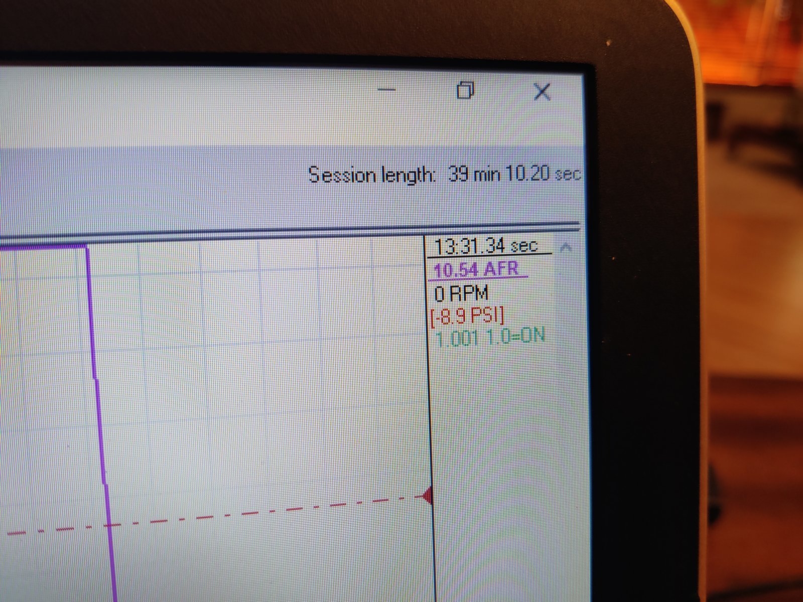

    Check this out for reference. 100% DC, 0.0 knock, A/F @10.54:notsure:
