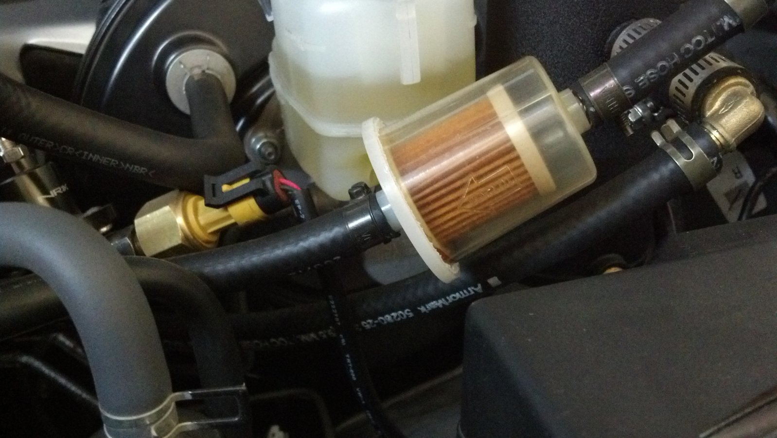

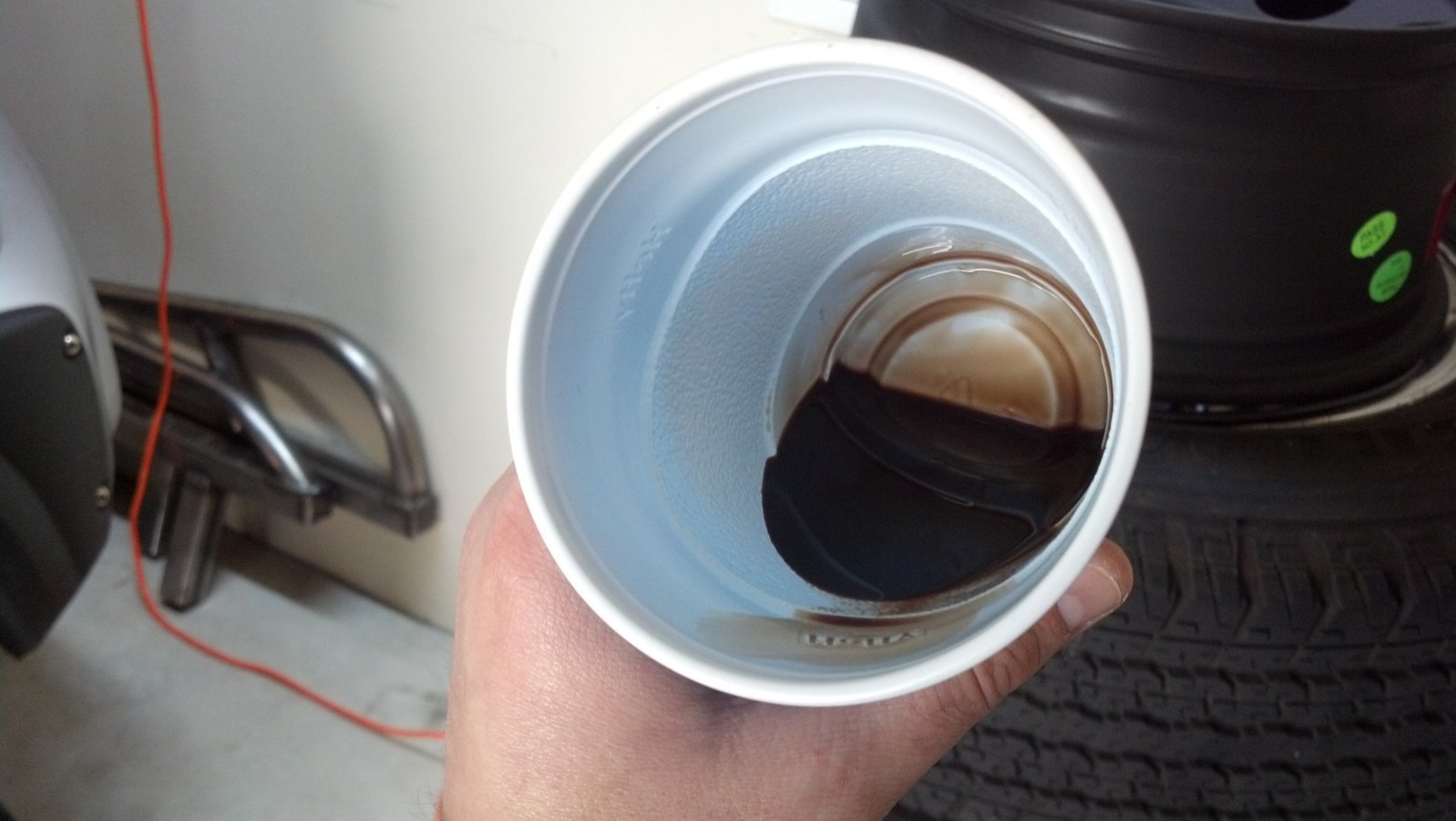

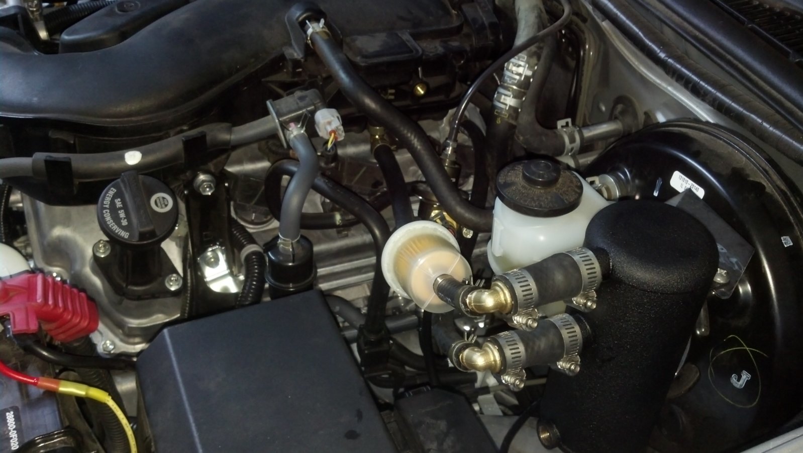

    All gas engines have a PCV now, before they used to vent to atmosphere and drip the condensed oil vapor on the ground, or through a air filter on the valve cover (and drip on the engine, and then the ground), or get drawn out the valve cover into the exhaust via a one-way valve under vacuum and then burned off. They can't do this any more, obviously because of environmental harm of oil on the ground or excess hydrocarbons in the exhaust.
    99% of the manufacturers just route the PVC to the intake, so any blow-by gets burned in the combustion chamber and any hydrocarbons get caught by the cats, good to go. The problem is the oil vapor from the PCV gets burned along with your fuel, meaning your fuel isn't burned as clean and you're leaving efficiency/power on the table. So, it's not necessary, but some of us would like to filter the oil out of the combustion chamber.
    I found some old pictures from my Tacoma, NA V6. First picture is my installation and fresh fuel filter on the output of the catch can, second picture is the fuel filter after 3000 miles and third picture is how much the can caught between oil changes.

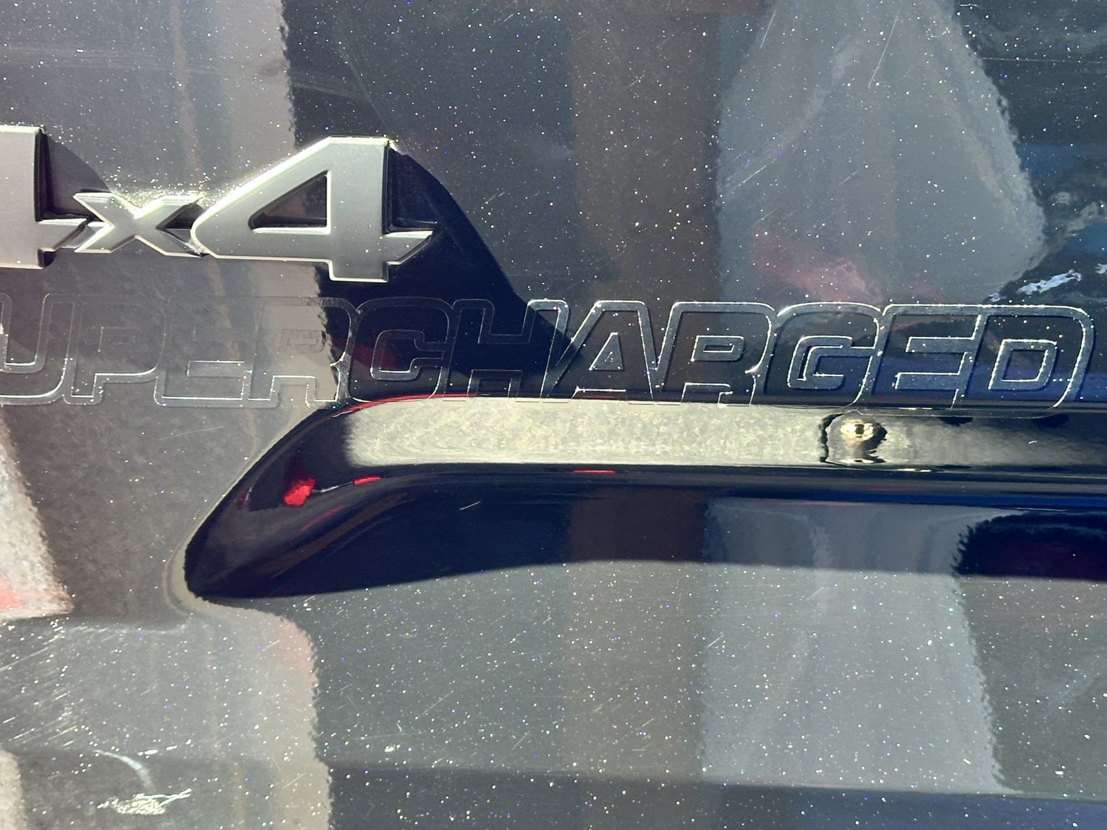

    Forgot something hit the tree on the way.
    Didn't make any noise I hoped it was foam before forgetting about it.
    No dent but won't just wipe off.

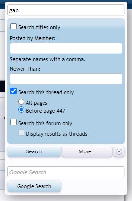

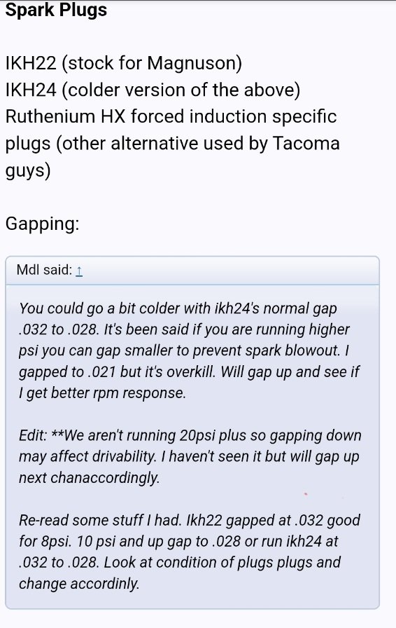

    Did you really just refer me to the search bar…? o_O

    Yes...but only because I know we've had this discussion a few times before, not to be a dick...
    Mine are .022 per ProSpeed's suggestion, been working well at that gap for over 3 years now.

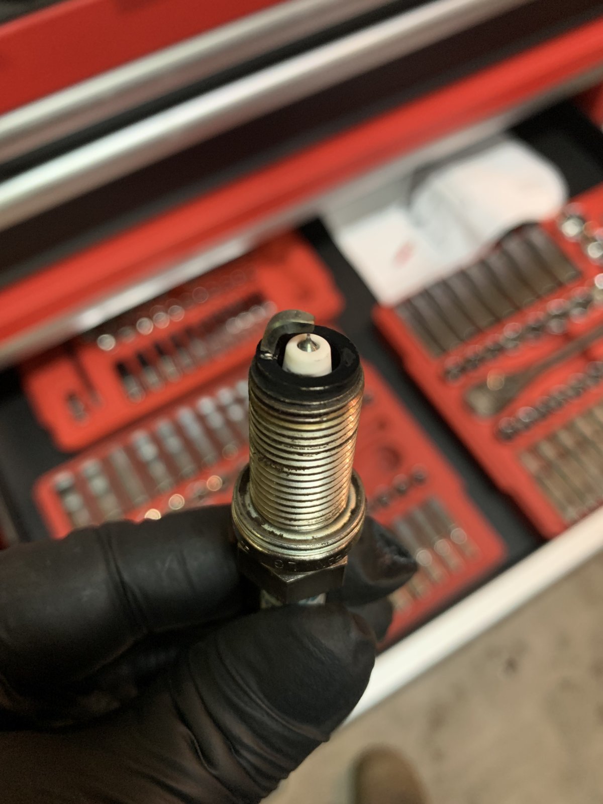

    IKH24 @.028

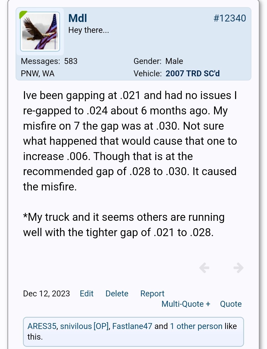

    I messed around with gapping down to .021 and up. I settled on the .026 but whatever gets your spark off...haha
    A smaller gap could help deter a misfire. I dealt with a intermittent misfire and that happened with my plug opening up to
    030.
