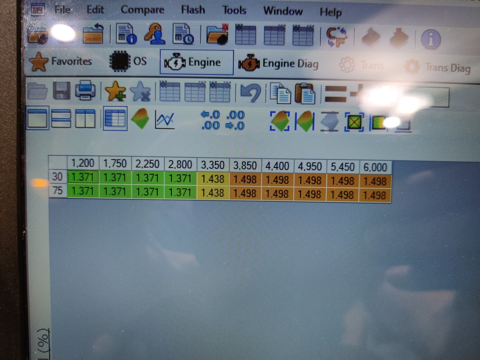

    Hey guys need some insight here on power enrichment. I've adjusted my MAF, increased my IC/inverse, and calculated between my ERC with The PE table. No matter what calculations and adjustments I do for WOT I tap out @11.1/11.5 at approximately 5800/6000rpm. WOT before I hit the limiter is 9's low 10's. I thought it was through shifts but it's happening before a shift. My MAF table is tapped out at 388.36 at 5 volts, COTS EQ ratio is set at 1 so it doesn't seem like it interfering. Furthermore LTFTs are dead nuts, injDC max I've hit is 87% and Knock feedback is averaging -3.0/-1.1 WOT. I'm at a loss at this point and any pointers is appreciated! Other then that truck runs like a sob.

    What are the numbers in your PE table?

    I've adjusted my MAF and increased IC twice, trims are perfect. I'm maxing out at 3850 rpm....

    You have a FPR and new pump, or rocking the OE setup?
    ARES35 likes this.
  20. Jan 30, 2024 at 6:31 PM
    ARES35
    ARES35 New member for life
    Aug 8, 2018
    #17920
    1,026
    Mile high
    Blown 2650 17 1794 Tundra 4x4 CM
    2650/750cc/76mm/SPD DP-DD exhaust/HP tuned
    Still rocking the FFV pump and stock regulator boost referenced on 750cc Injectors.

    Not sure if this will help. @snivilous was schooling me on adjusting the MAF, IC and relationships to afr's. Look it over and hope something sticks out. I do have more emails that I printed off for my files... I think my cots is set at 0.

    Not to throw a wrench in it...have you tried just running a straight PE without boost referencing? Did you run a log before being boost referenced. I know Sniv is not running boost referenced and still running a good tune.

    Yes I did a good amount of tuning and datlogging before BRing on the 86mm pulley. Then I decided to BR after installing the 750's. Sniv guided me through extensive tuning and helped me get dialed in with his extensive information. At this point WOT high load air/fuel is my only issue....... Only thing I haven't tried is increasing the high volt MAF cells where I'm leaning and not meeting PE. Its just odd that my trims are perfect through out.

    And if you increase IC by say 20% and decrease MAF values by 20%, but don't adjust PE, that doesn't make any difference?
    Can you clarify this "for WOT I tap out @11.1/11.5 at approximately 5800/6000rpm. WOT before I hit the limiter is 9's low 10's."
    Maybe I'm retarded but those two sentences seem to contradict each other?

    No sir not retarded at all! Lol. When I gun it, say from 3000 to 5000/5500 or so it will come on 9.8 to approx 10.2 A/F. 5000/5500 and up it gradually increases to reline tapping out 11.1-11.5 tops. I have increased the IC 20%, dropped the MAF 20% twice. Max the PE no change. Figure I could incrementally increase the MAF volt cells where I am at WOT to demand fuel would be my next move.

    Something I've done before is make a new tune entirely from scratch, grab the base file and edit it again. I only change the bare minimum (granted that's usually a lot of stuff though), and try that and see if it makes any difference. Essentially start fresh. I've noticed times where making a change doesn't do what you expect for whatever reason.
    For instance, copy your MAF and PE and IC values. Turn COTS off completely. Copy the timing values. Run that and see if it behaves any differently being a fresh file. Food for thought. Might help isolate what exactly needs changing since you have a bare bones tune so only a couple variables that you touched.

    Understood.... But dang it's so close lol. I do have cots enabled, stock values other then main table set at 1. I will try disabling cots all together. If no cigar I will take your advise and start from scratch again. :pccoffee:
