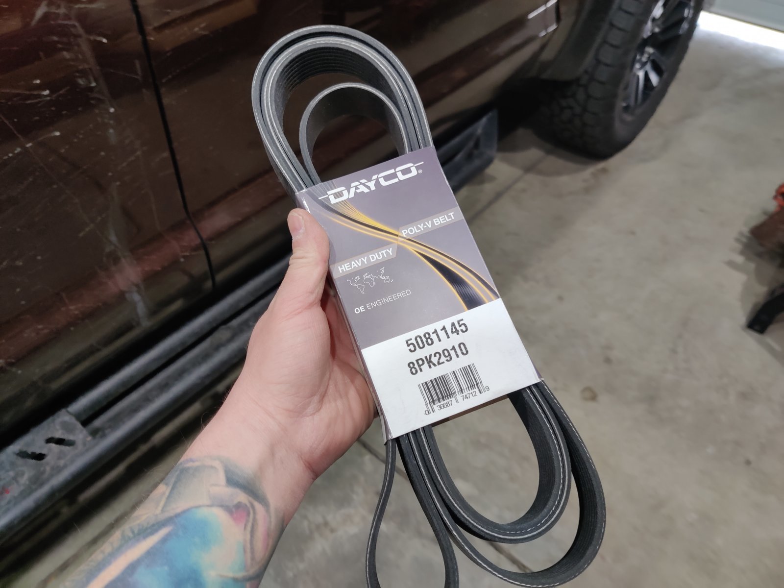

    Supercharged with all the trimmings

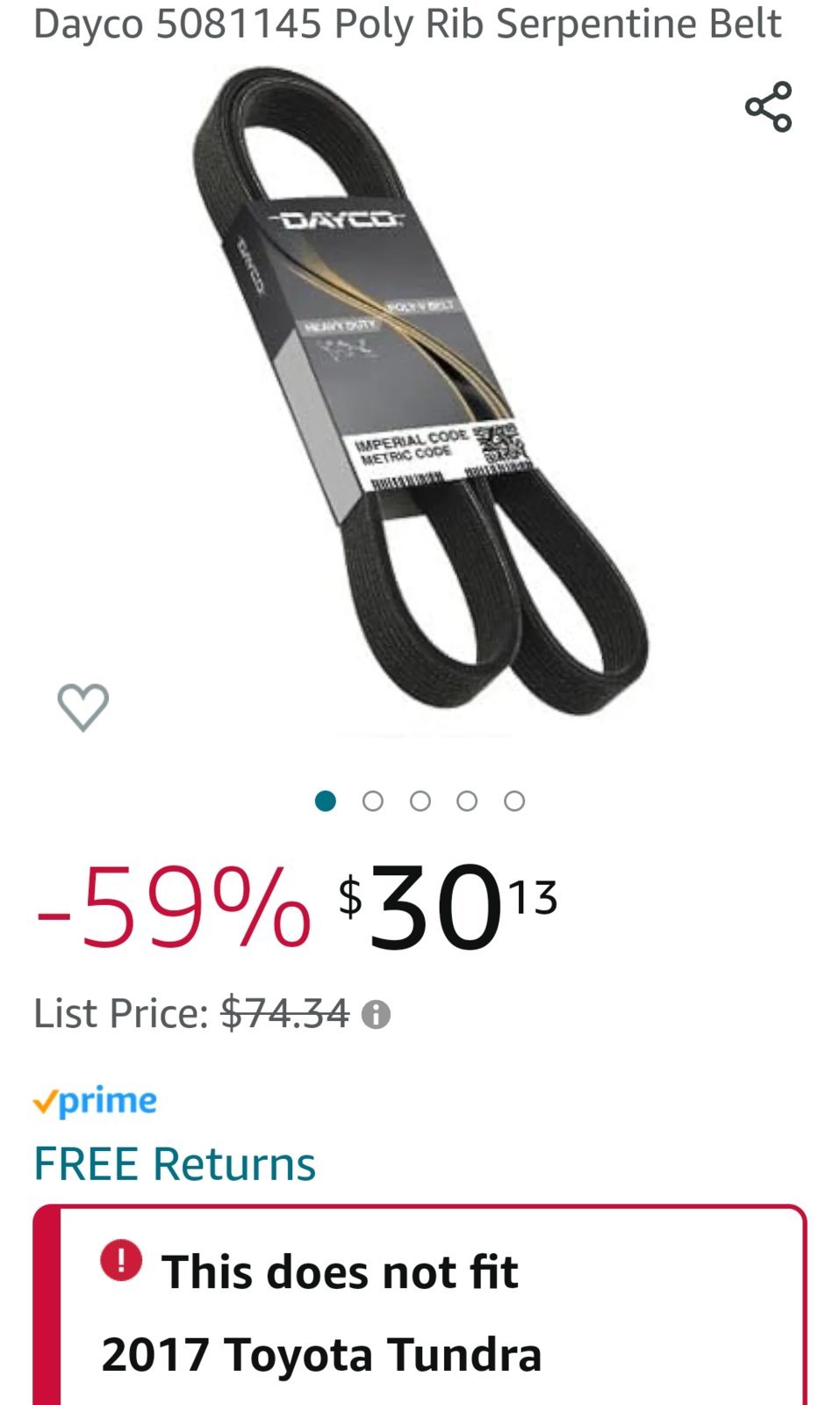

    No sir, I'd have to say if you need some belts get them via Amazon right now:eek2:

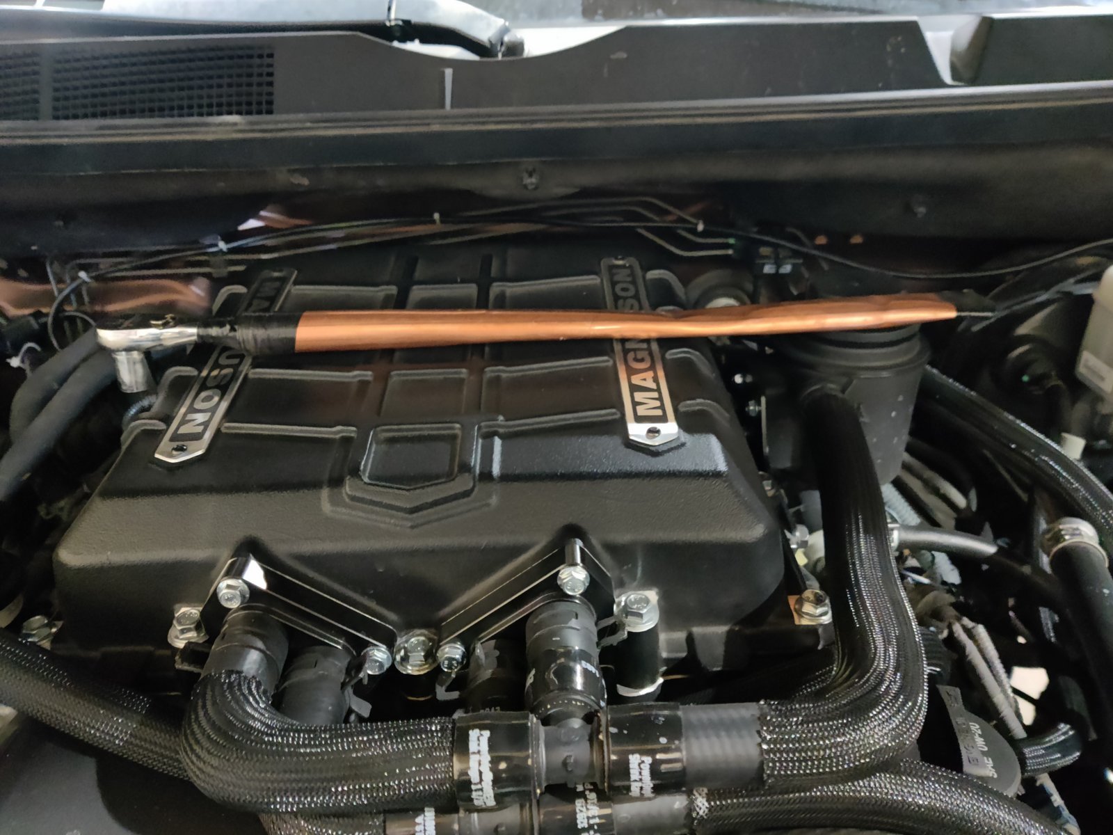

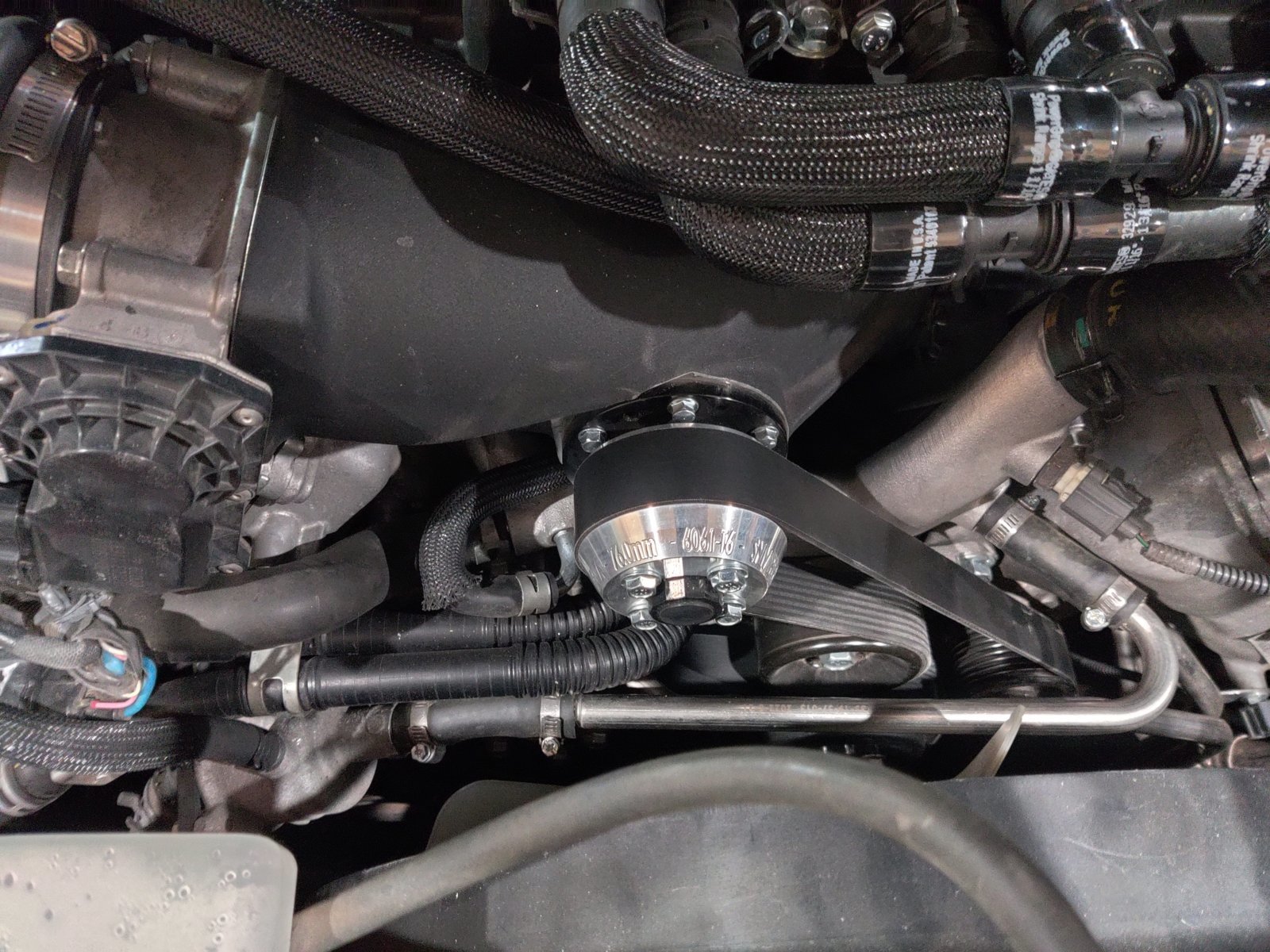

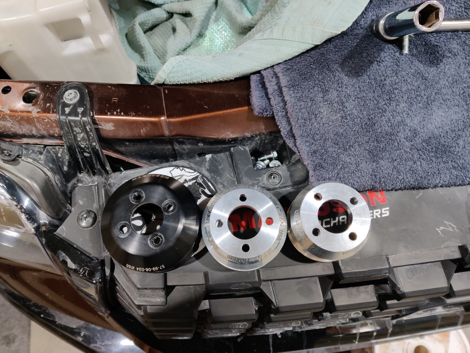

    Got the 86mm swapped to the 76mm. God damn belt is a arm ripper and hand de-skinner. Had to Jerry rigg/tape a socket wrench to 3/4" copper conduit and flattened it out. My breaker bar was to thick to fit between fan and supercharger coolant line smh. Here's the 86vs76vs70mm. I threw on the 76 for time being.

    Nice job. One thing I did was cut a notch that my breaker bar with pipe extension would fit on the lower shroud. I've been running an e-fan off and on for the past 6 years and is a bit easier.

    Good idea for tensioner access, that shroud is directly in the damn way:facepalm:

    It’s easier to do that from the bottom

    Oh yeah. I notched a section about 2 inches deep and 10 inches along the sway bar. Gave me access for crank pulley and serpentine idler pulley.
    **I use a 1inch ID steel pipe about 20 inches long as my cheater bar.

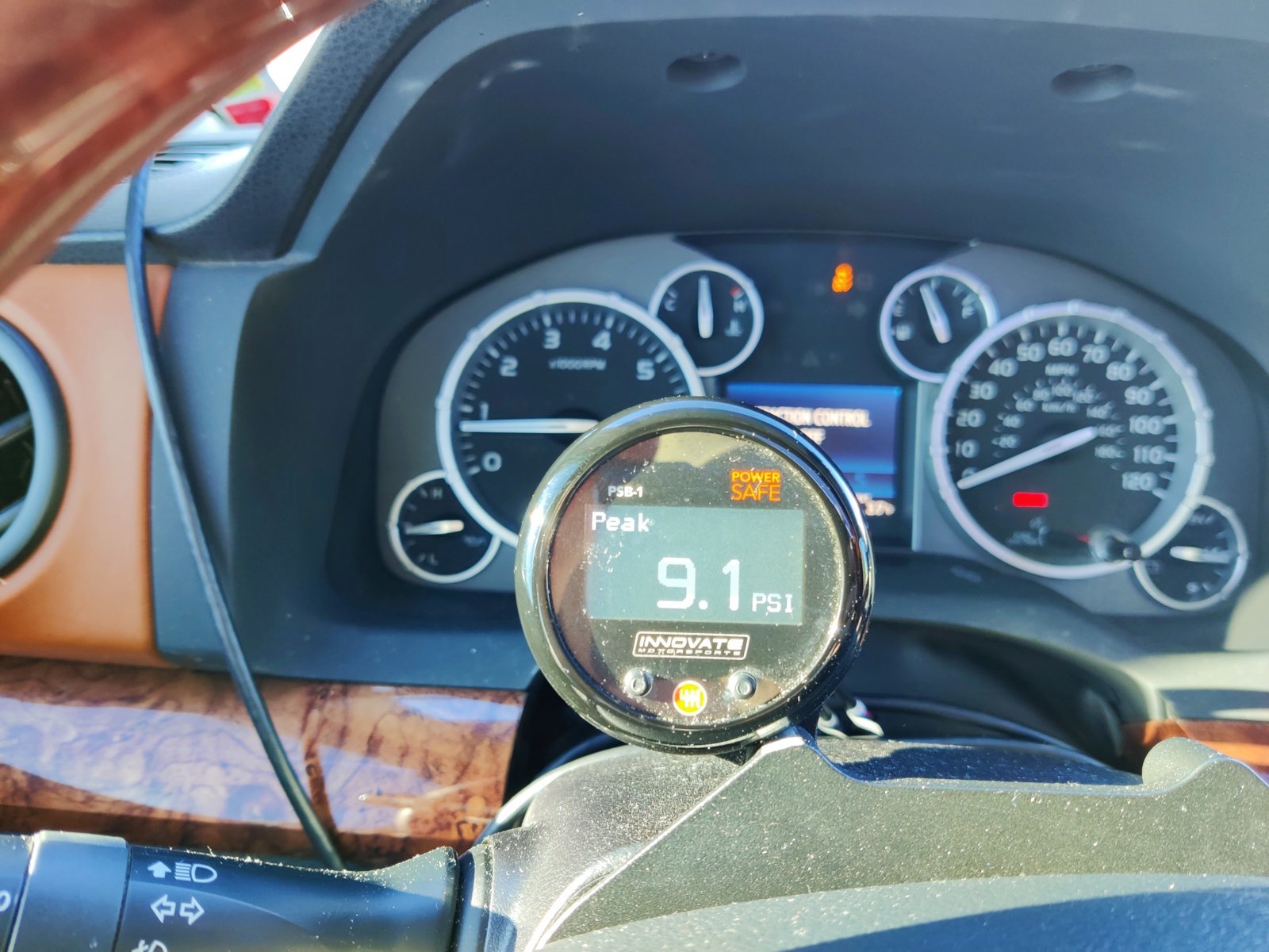

    Now hitting a max of 9 psi at 5280' on the 76mm. Commanding PE of 1.4 before the swap but running in the mid 11's up top. Need to tweak the tune for sure now.
