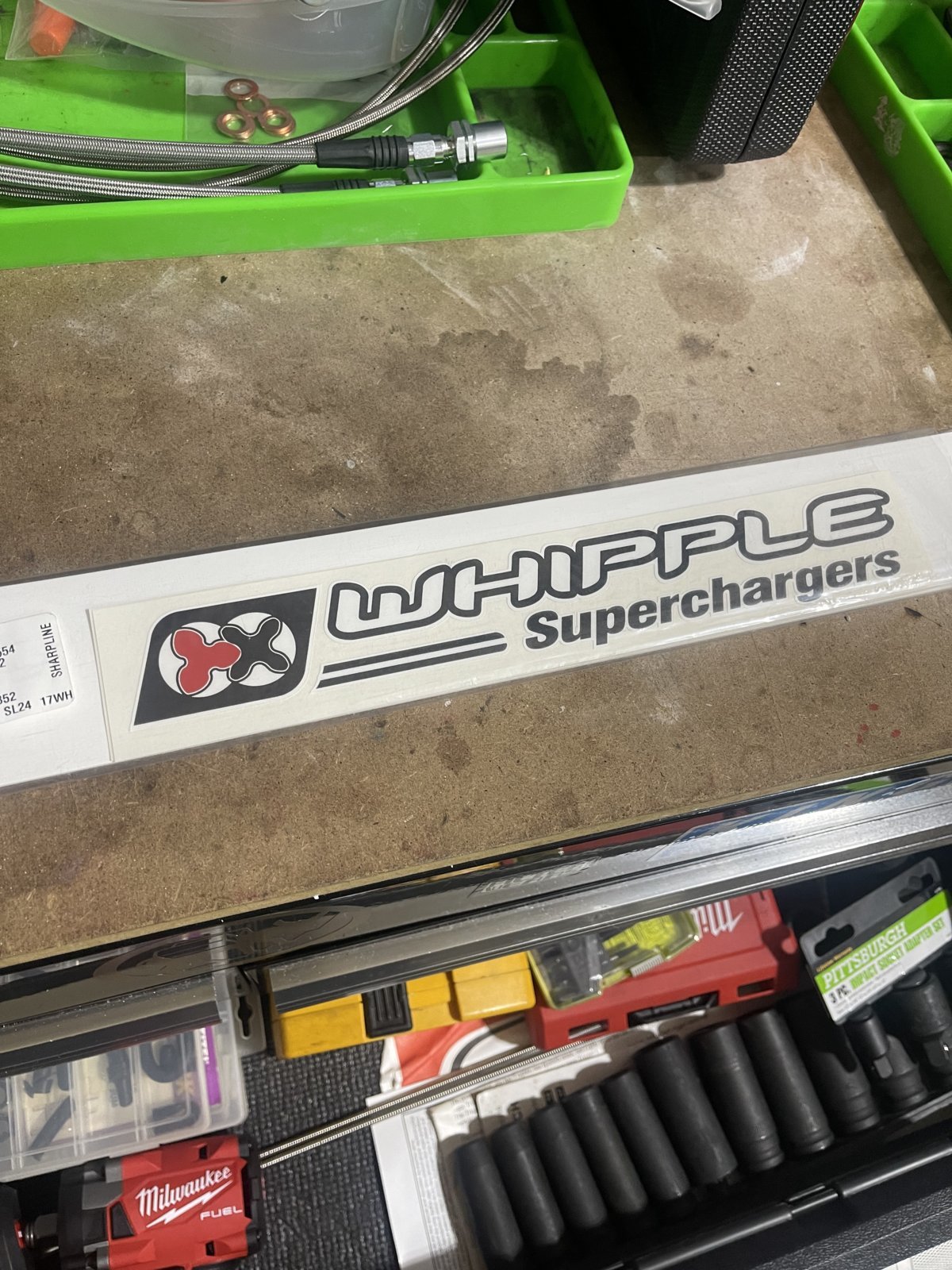

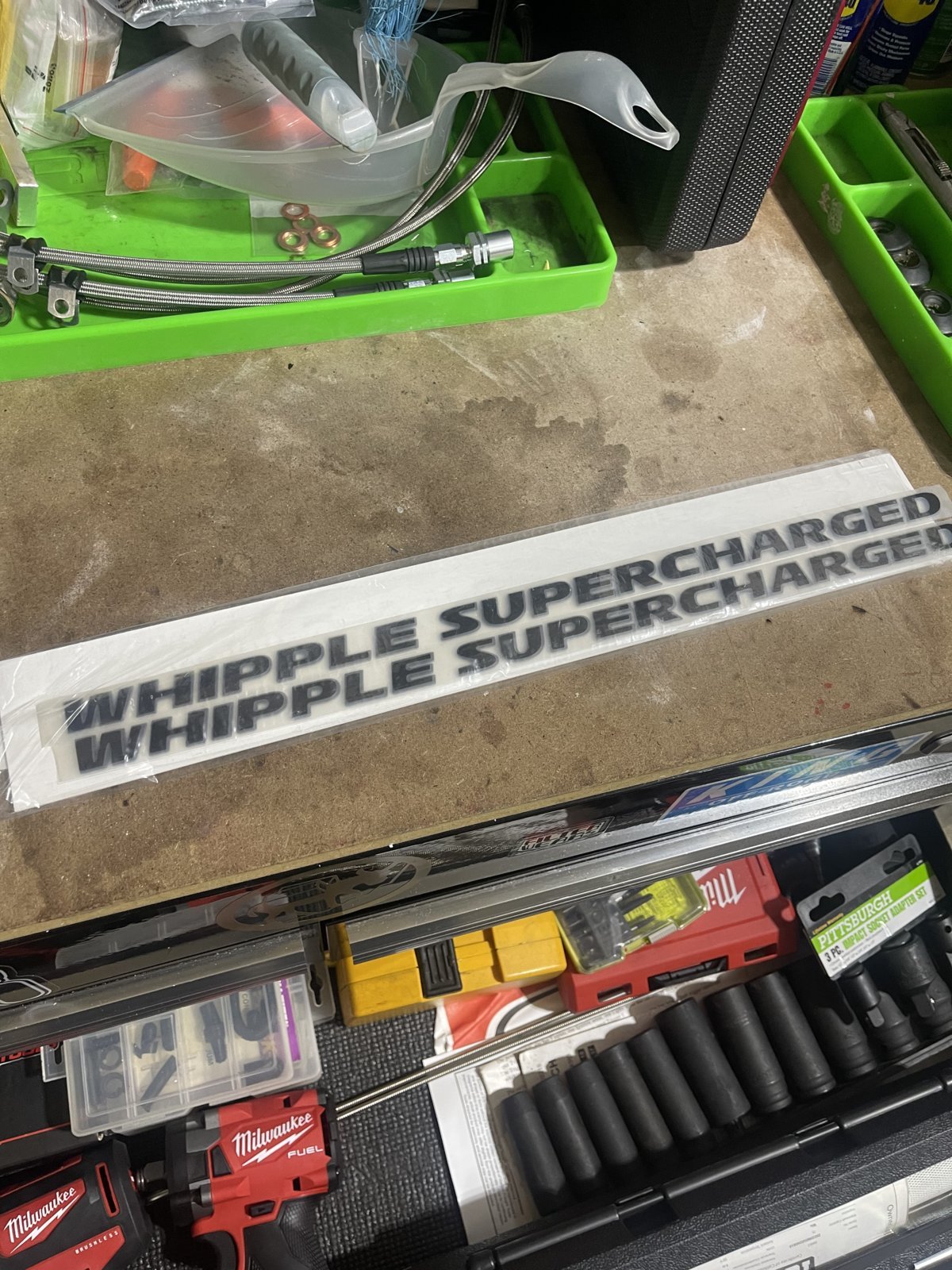

    Whipple sent a few but I don’t run decals etc on the rig.
