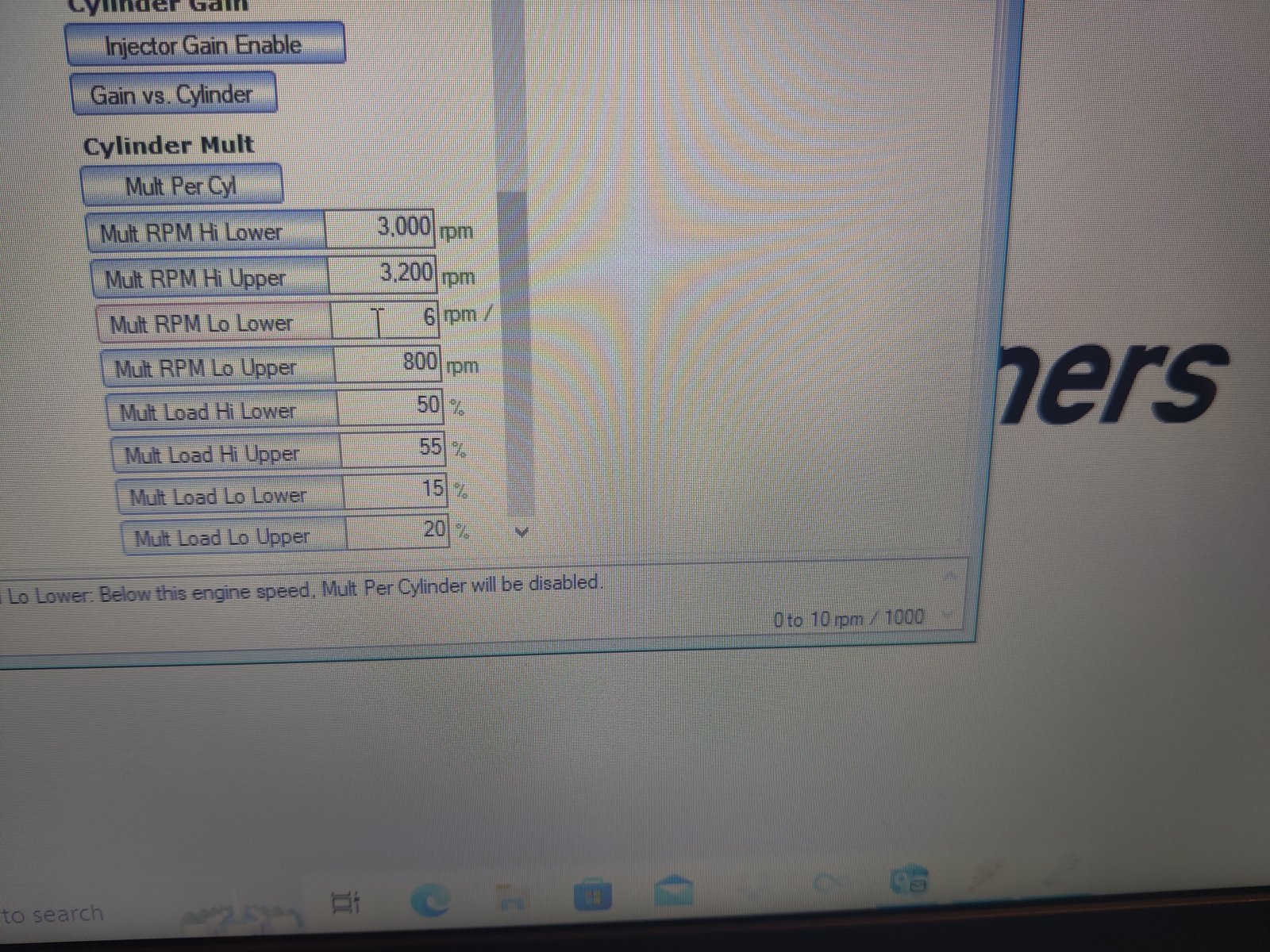

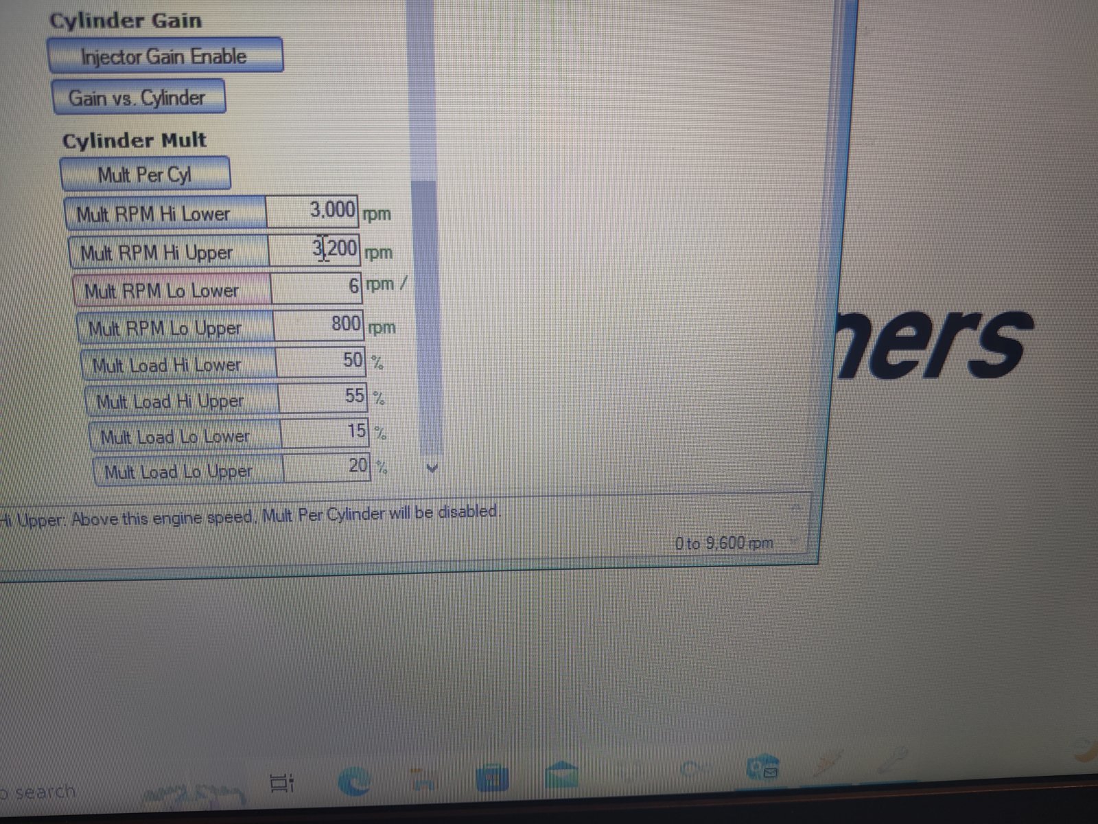

    Well I found a few things at least with my base map that are wonky. For example under fuel/mulit rpm lo lower, the value is from 0 to 10/1000 rpm. The rest of the multis are 0 to 9600rpm. Mine was set at 1. So I changed that to 6 for 600rpm from 1/100 rpm lol. Also my PE table was only set to something like 5600rpm, thus my reason for leaning out on top I believe smh. So column axis from the trd up to now 6000rpm. Also under spark/advance/base-high octane and low octane the timing values are pushing some pretty aggressive timing in low loads throughout the rpm range, at least from the TRD tune. Im going to try dropping 3 degrees across 10/20% load across the rpm range. Also my base and high octane column Axis was off so I matched them. Idk hopefully it'll help.

    The TRD tune is weird at best, and extremely difficult to understand what they're trying to do. I would start with the stock tables and modify from there.
    SlowNStock said not to be overly worried about low load knock happening, though I still usually retard those values if it's getting counted a lot. The lowest load is usually 40-45deg. There's also transition lines for KCL where knock can show up as the KCL instantly jumps, but if your KCL is uniform everywhere I don't think that rears it's head really.

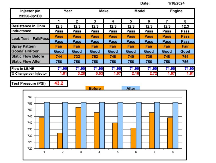

    I got the report for the Five-O injector testing, looks like they were pretty dirty

    Interesting, how long were they on the truck? May need to add cleaning injectors to the maintenance routine.

    Brand new, never installed, purchased in February 23 and have been sitting in the packaging in my office. They looked spotless on the outside, but were not flowing what they should have been.

    What the heck, huh. That has me wondering how the last set of "brand new" ones I got from them would test. I never got a printout on the first set I returned, just what Bruce said via email. Who did you have test these, and what was your rationale, merely due to them sitting?

    I know, right? They gave them the old "Craigslist rebuild" wipe down and new O-rings...done! I had them tested at InjectorRX here in town, second place I tried and even they had to order Denso leads to test them. I wanted to get them cleaned and flow tested before wasting time installing and tuning after seeing everyone else having issues, like what you had reported.

    Hmm, I'll have to ponder following your lead and have mine checked too.

    I might as well get my 650s tested and dialed prior to install myself...I trust who I got them from but it's hard saying not knowing for sure!
