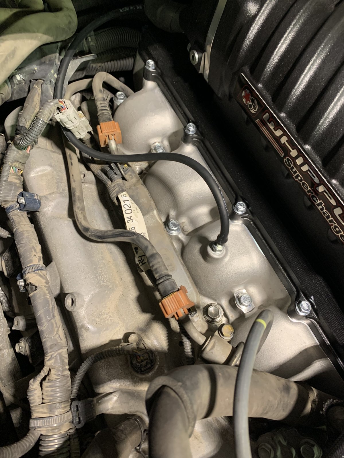

    Looks like the FPR is fixed. Unless what I’m looking at isn’t the FPR… Ignore the dirty valve covers…

    regulator is on the passenger side with a vacuum line from the intake tube

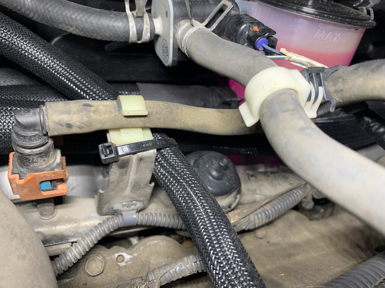

    THERE it is! It was hiding… So, that runs right in to the intake, which I’m assuming is only going to show vacuum and not boost since the boost is below the rotors and not in the intake. I ran it to this port pictured, which was originally capped but Whipple supplied a nipple.

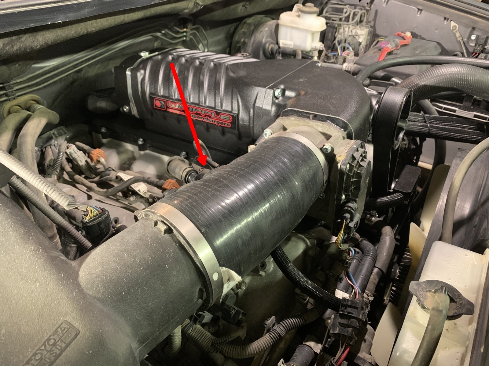

    To boost reference the FPR, the vacuum line needs to connect to a port that sees vacuum/boost. Same port or similar location to your boost gauge sensor. Sorry if that's what you did, wasn't clear to me.

    I was gonna say that there is your pulse damper, fuel reg is on pass side with vac line attached at intake.

    Take the end of hose A from the intake tube and T it into hose B. Then you're boost referenced. Don't forget to cap off the nipple at the intake where you've removed hose A. That fubar is reserved for the likes of me. o_O

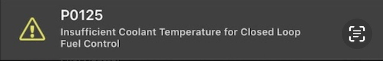

    Lucky! Remote started my pig at -11º, went out to find a Christmas tree in my cluster:
    First time I've had codes, aside from O2 sensor problems from my cats being stolen.

    That's super frustrating, and REAL cold. Sounds like maybe a connector froze or clockspring doesn't like the cold?

    I think you’re right with the connectors, as it’s never done this before - albeit I’ve not tried starting it this cold before. I did a zero point calibration just in case.
    The hard start has reappeared and is consistent - it turns over but won’t start until the third attempt. The P0125 & C1201 came back and the idle surges as the engine gets warmer. Driving feels fine - too much snow to give it the beans, but I got up to 4psi and AFRs looked good. Closed loop STFTs and AFRs are great at +/-3% & consistent 14.6, respectively.
    I’m going to mess around with some tables on HPT and see if I can get a handle on it.

    I had the same P0125 last week when I remote started my truck after a night of single-digit temps. Mine ran fine though and the code hasn't come back since.
