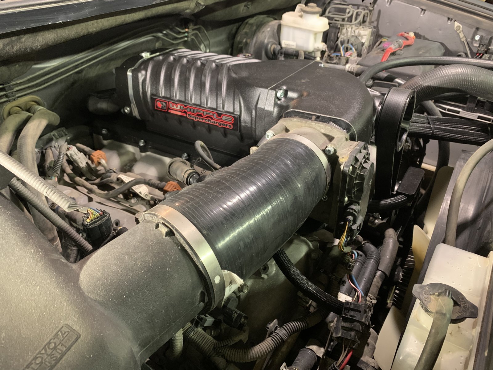

    Officially joined the club! Geez, I wish I’d have done this years ago. Shout out to @reywcms and @snivilous for helping get things sorted out and tuned! Took it for a rip last night - I had to find patches of clear road between the snow drifts, but I kept in 4wd and this thing RIPS! Permasmile for sure. I love how instant the power delivery is. Snivs tune turned out on point, right out of the box, too. I’m beyond happy with the setup.

    Another Whipple to the mix! Looks awesome! Fees like a big block doesn’t it?

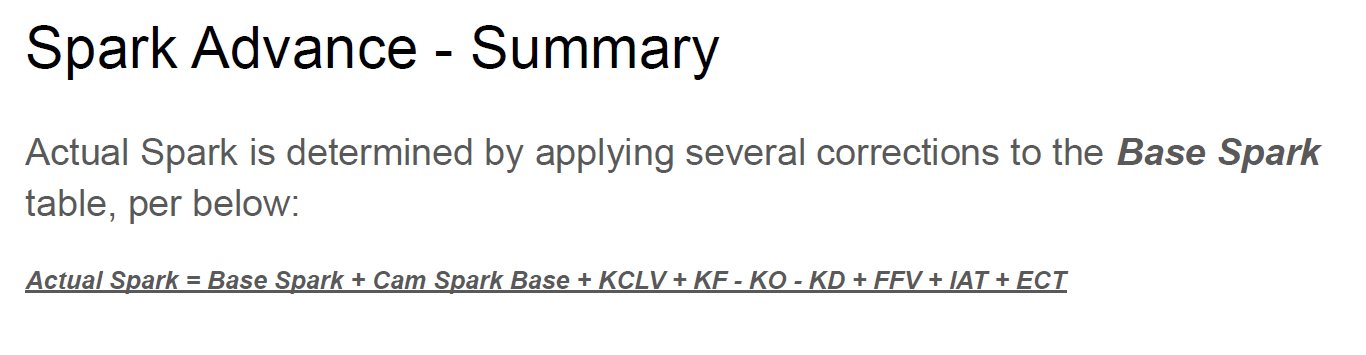

    Yes, from what I understand, the ECU should be adjusting by pulling timing in relation to the hotter readings, so overall more conservative.

  7. Jan 13, 2024 at 7:51 AM

  8. Jan 13, 2024 at 8:25 AM
    armyoffoo
    armyoffoo Member
    Jun 4, 2018
    #15876
    1,479
    Cypress, TX
    2018 Black TRD Sport CrewMax
    Supercharged with all the trimmings
    To add, my answer is very basic, as IAT is referenced in several tables, but I'm no tuner so I don't know how it correlates. I couldn't find anything about IAT called out specifically in SlowNStock's (HPTuners forum) documentation, but it is a part of the spark advance equation listed in his documentation:
