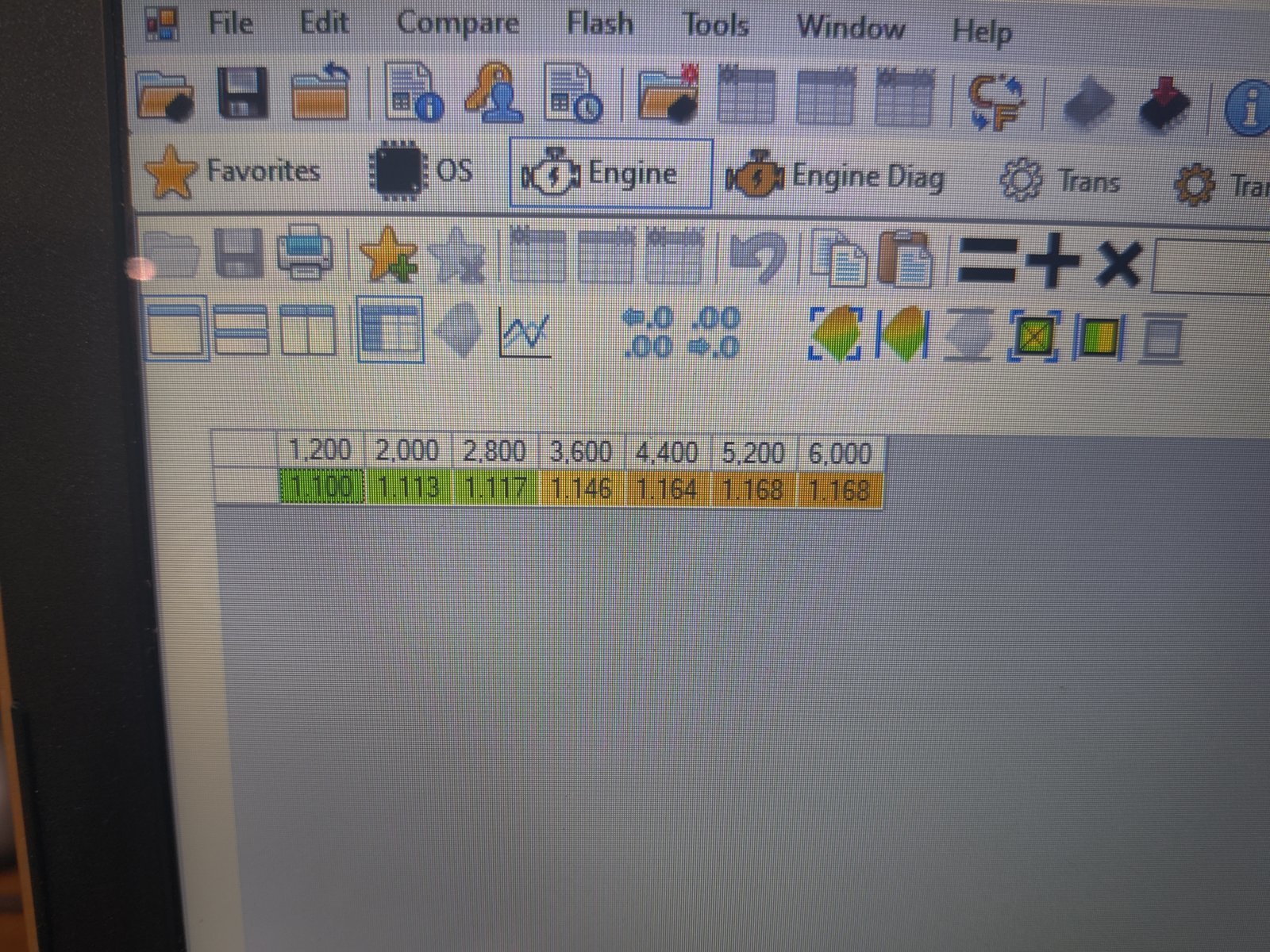

    I have some confusion on power Enrich, EQ ratio, WOT. 14.7 is 1.1? Most of you are targeting mid 10's. So per say wouldn't that be 14.7÷10.5 PE of 1.4? Looking at this TRD table I see nothing above 1.168. Is this not extremely lean? Sorry for my confusion.

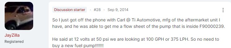

    I found the post from 10 years ago that mentioned 375 lph as the spec for the FFV pump:
    I have also flow tested the FFV pump as per request. Results are in my fuel system testing thread.
    reywcms, HulkSmurf14, Wynnded and 8 others like this.

    @ViktorG thanks for finding that blast from the past. Good info and thank you for testing. Good flow especially if it's hardwired to 14vdc.

    14.7 would be 1.0, since 1.0*14.7 is 14.7 :D
    But yes you are correct. The TRD tune also used the COTS (component protection) table for fueling enrichment to try and make it more dynamic about enrichment instead of the on/off switch that is PE. If you didn't have COTS then it'd be very lean, but because of COTS the TRD tune will run in the 9s in my experience.
    Also, in a perfect world PE would be a straight divisor of AFR, but just like IC and MAF values it varies. PE relates to IC, so if you scale IC then PE needs to be scaled by a similar amount to maintain the same AFR. PE also has a cap of 1.5 like MAF has a cap of 512, so IC can be manipulated if you wind up at 1.5 PE not being enough. A higher IC will command more fuel, so a lower MAF (closed loop AFR) and lower PE (open loop AFR) would be used.

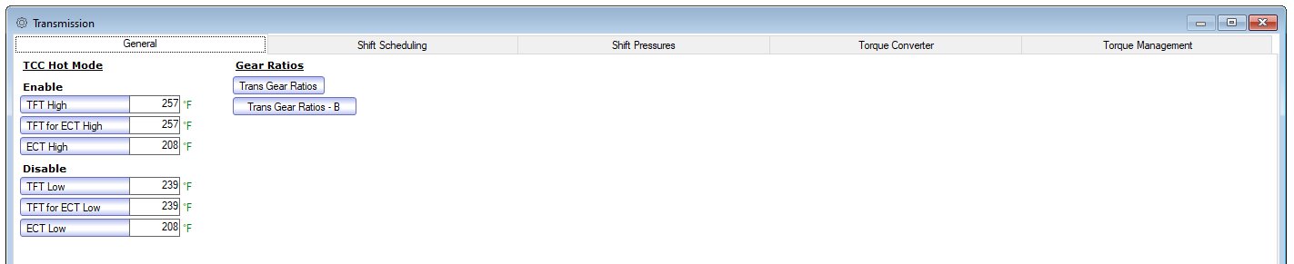

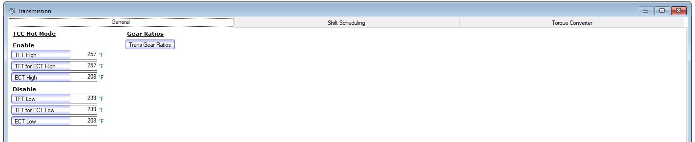

    And another peculiarity, the tune is lacking 2/5 of the transmission tabs which is another first. I'm gonna send an email to HPT, considering it's a 2013 truck I don't know why it'd be lacking so much. Not the first time I've seen a tune that's messed up or won't work from HPT, but a first where it's flat out missing tabs.
    Every other Tundra:

    Cuz it’s mine, that’s why it’s messed up.. :rolleyes: Like standing in line at the grocery store - I can pick the line with 1 person and the line with 7 people with be faster :eek:
    I will open up the file on my machine later today and see if it has the same peculiarities. Truck is in for service right now and I won’t see it again til tomorrow.
