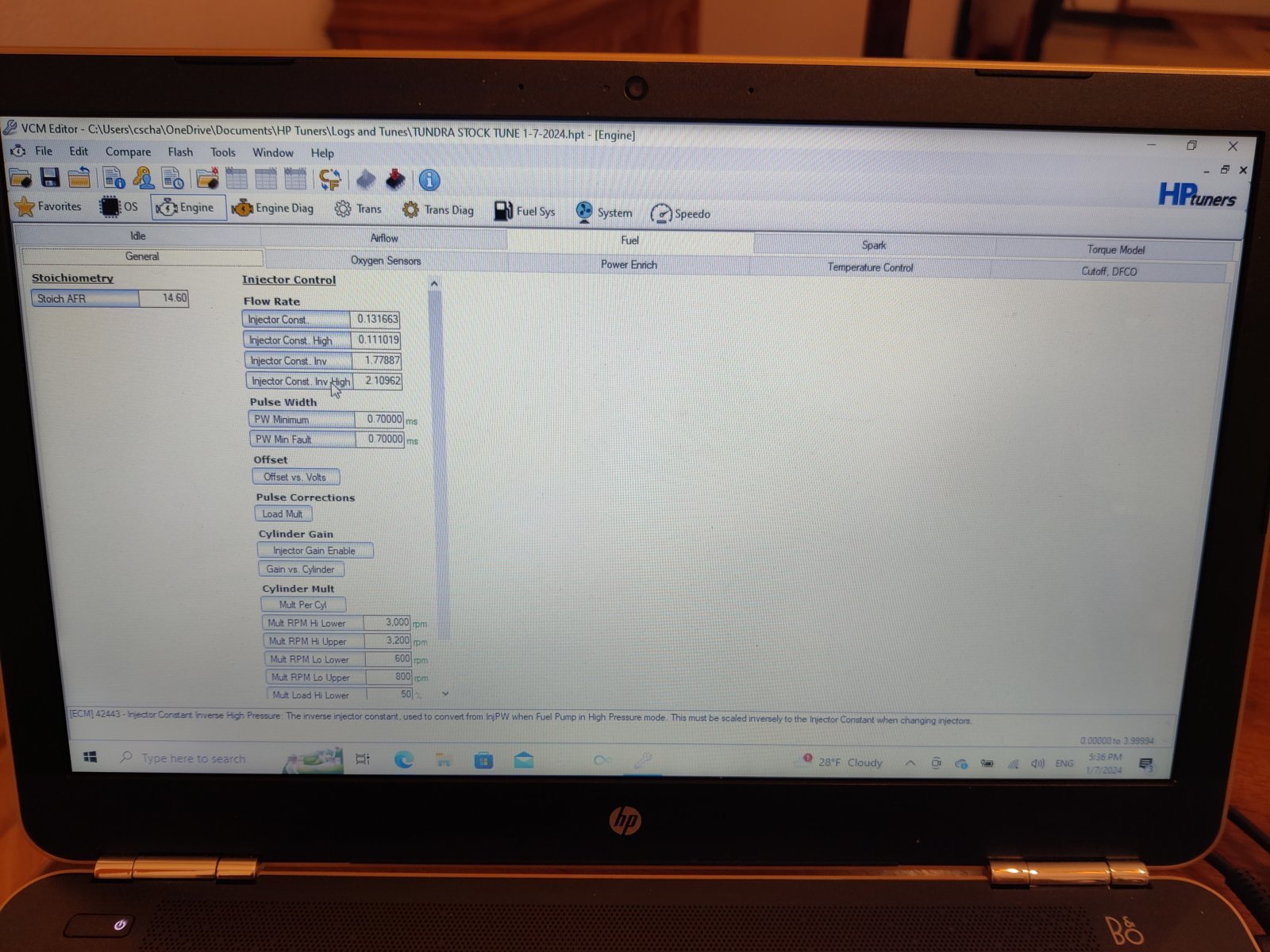

    Yes sir, 0.131663 is stock truck IC per the injector control. My problem at this point is switching to MPVI-3 and having only the stock truck map. I could probably work off the 1900 TRD tune though but still have no idea of the ICH/ICI/ICIH, pulse width, offsets, corrections etc.... I simply need a new tune.

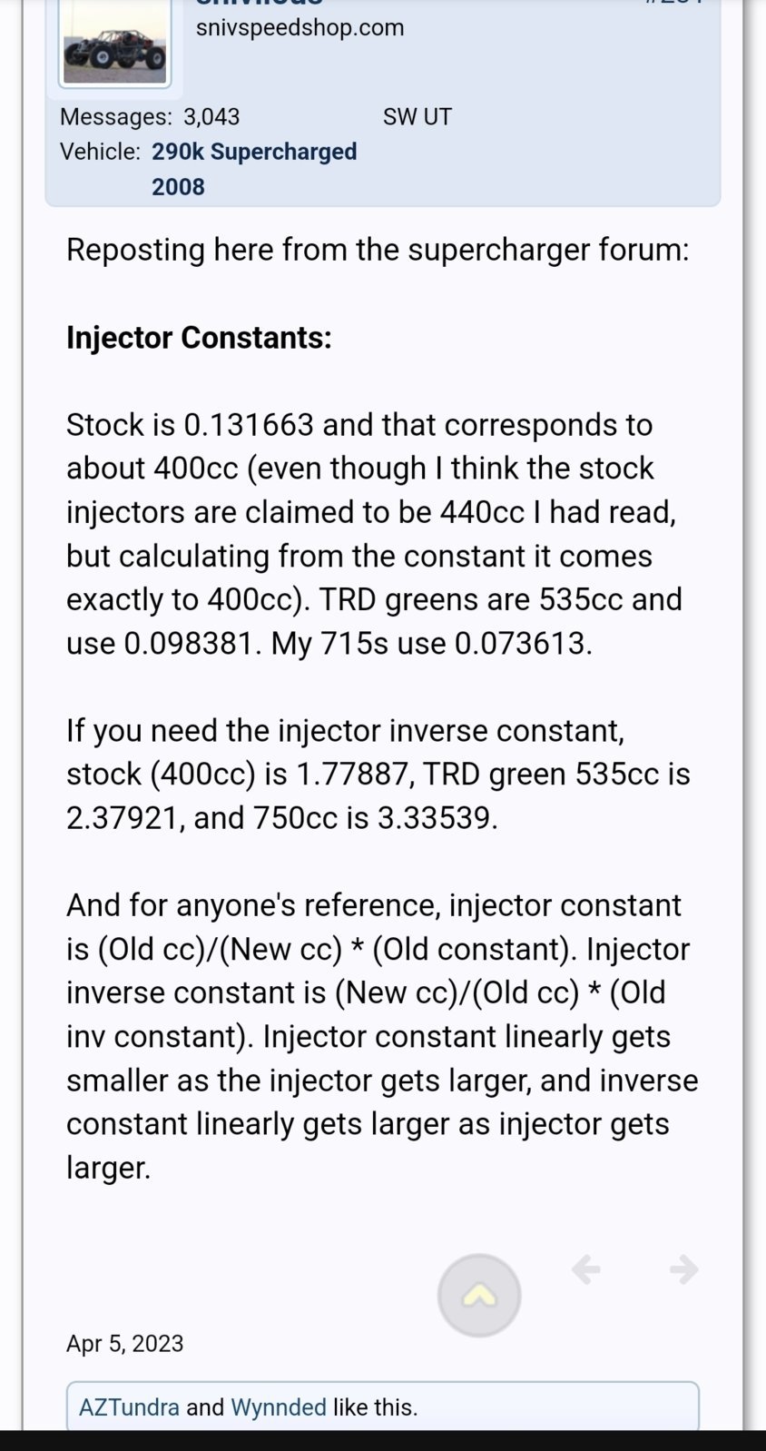

    Start with like .08 for IC, the "high" values just set the same as the normal values. The inverse scales the same as the IC, so I would just multiply/divide by the same ratio to reach 0.08. The pulse width doesn't need changing. Offset you take from the sheet Prospeed gave you where it shows flow rates, it should list injector dead time which is the offset vs volts (make sure the volts are correct). All the other shit you could skip for right now to at least get it running. MAF values if you're using the Magnuson then pull the TRD tune from the HPT forum where I uploaded it or I can send it over and then copy the MAF values.

    Weeeellllll, that might be a place to start, but @snivilous and I have noticed that that doesn't seem to apply to all vehicles. Mine turns out to be way different and Sniv commented that he was tuning one where the IC was unexpectedly higher than anticipated. @ARES35 has a little more going on because his truck is a FFV. I might hazard a guess that once one tunes the IC, the rest will fall into place via calculation. The Offsets he needs are listed on the paperwork that came with the injectors, toward the bottom. Direct plug-in for those. I don't think Corrections come into play on S/C'd tunes.

    If you copy the TRD file, change the injector values, and maybe put the stock timing values back in (or just run the TRD timing) that will put you on a very good track. The TRD tune is the basis for a lot of what i do, like TRD transmission values slap pretty good as is. Just pull up the TRD in one window and your base tune in another, and just go through each table and copy and paste, then tweak those couples things, and you'll be off to a great start.

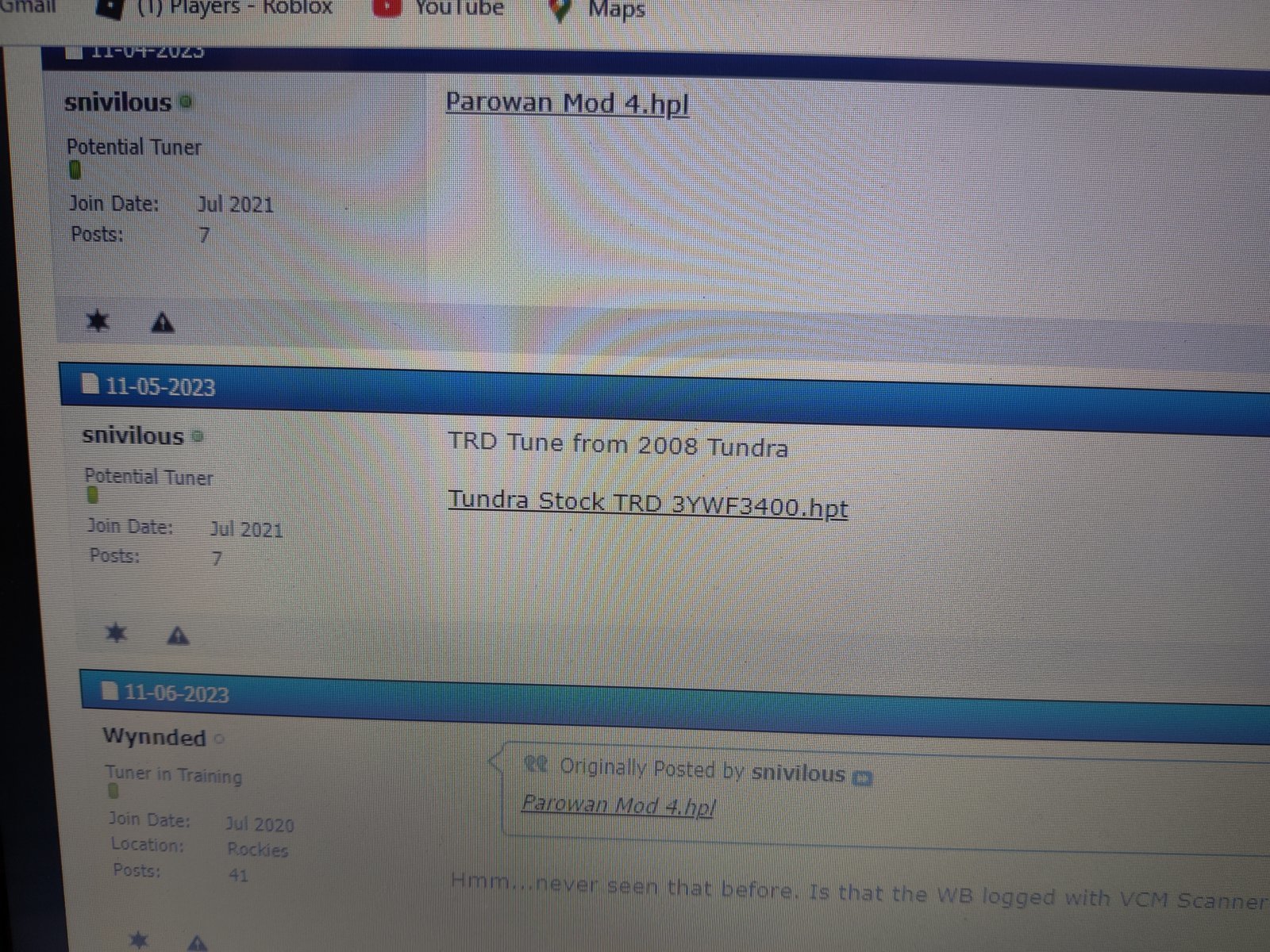

    Understood. In the repository I do see a few of your guys S/C tunes. I see your Tundra stock TRD, and a few FFV S/C tunes. Would I be better off maybe starting with a base FFV?

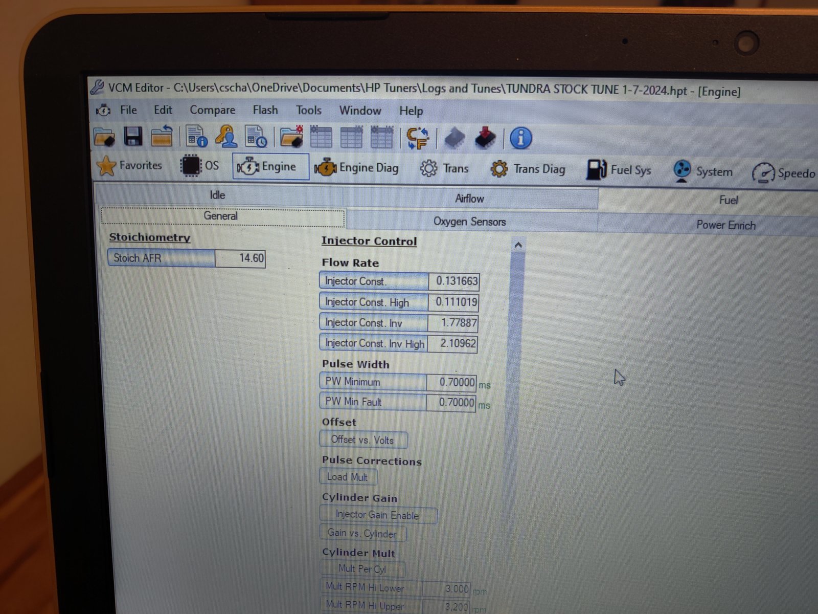

    I'm not aware of FFV TRD files but maybe I'm wrong. I would use mine just since I know it's a clean TRD file.
    For all your FFV values set it to the same as the base value, is there are tables with alcohol amount, go into each alcohol value and set it to the same as everything else, so it shouldn't matter what the ethanol sensor calls out, it always commands the same. This doesn't entirely solve the ethanol issues, but at least there's no question in regards to what you do have control over. An example of that is the injector high constant, just set it as the normal IC so it doesn't matter.

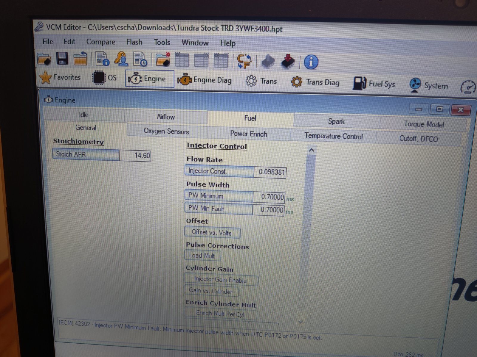

    @snivilous, is this the correct TRD calibration? I'm just not seeing the ICH/ICI/ICIH like my base FFV map?

  14. Jan 7, 2024 at 5:41 PM
    snivilous
    snivilous [OP] snivspeedshop.com
    Apr 16, 2019
    #29192
    5,024
    SW UT
    300k+ Supercharged 2008
    Yes, you'll have to go through each table specifically and copy the values over since the FFV has more things like you're seeing.
