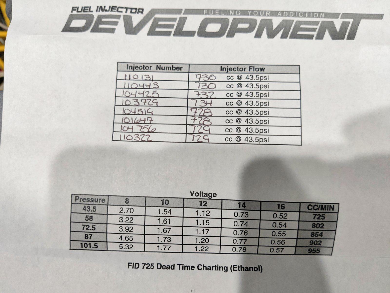

    For comparison purposes here is the flow rate chart on these injectors.
    Fastlane47 and Wynnded like this.

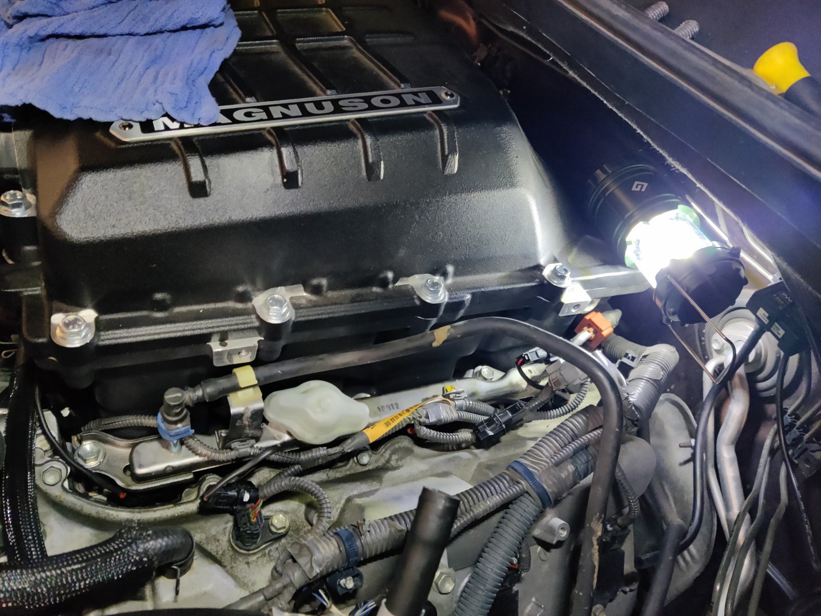

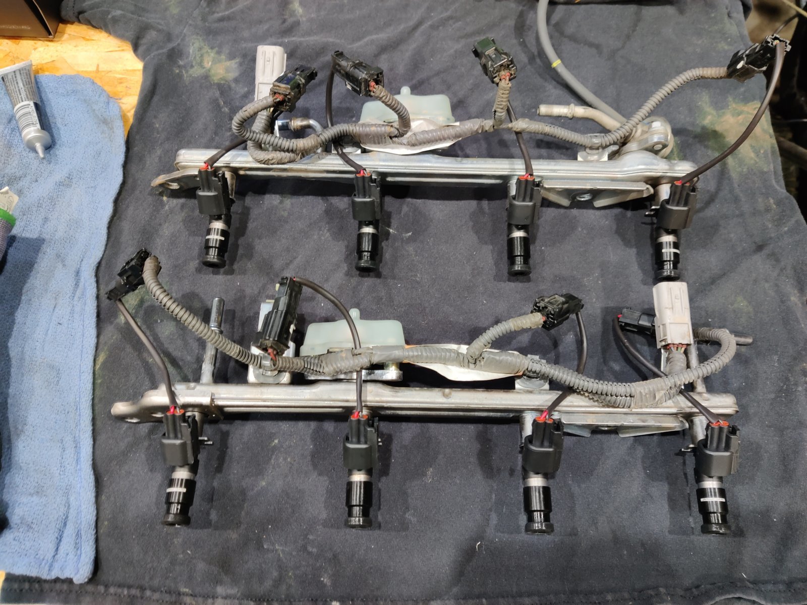

    Well got all these harness dremeled down. Just like @Wynnded said the harnesses do snap tight at the injectors and factory harness. I have no problems soldering but feel not cutting into the factory's was my best option, time wise and if I decide to try another option in the future. I just routed/tucked them.
  12. Jan 7, 2024 at 9:50 AM
    Wynnded
    Wynnded What MPG...
    #379
    5,650
    Rockies
    Souped up truck
    My money is on that they'll be fine.:thumbsup:

    Yes sir, I can't see any way they come loose, with force they stay put:D

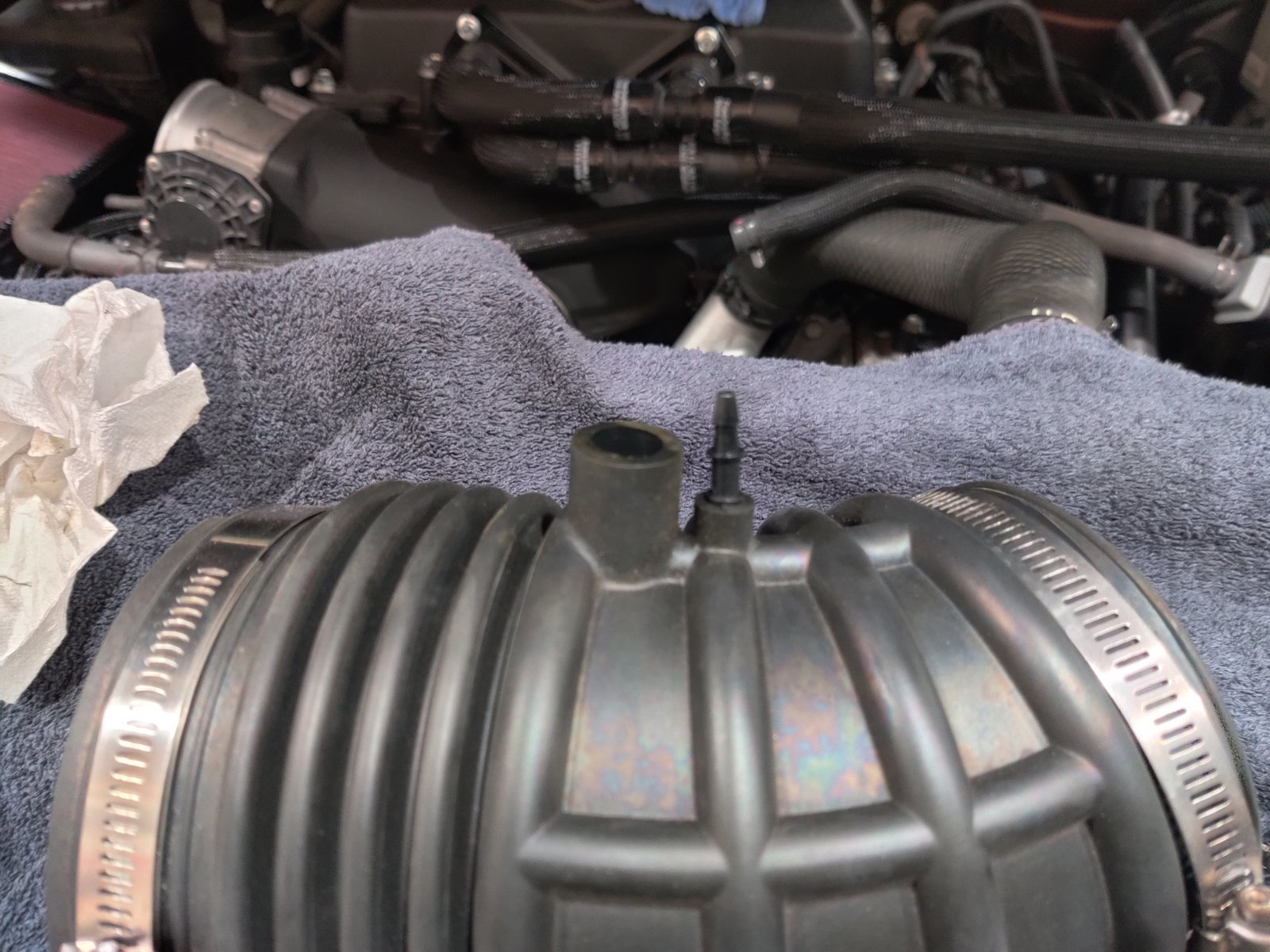

    My dumb question of the morning, with boost referenced did you guys just cap off this nipple at the intake? I'm assuming so.
    Saltyhero13 and Wynnded like this.

    Hey @Land Bruiser, I had the stock 535s in but yes, IDC was maxing out on stock tune in Denver. No way I could safely even run the 76mm pulley. I would suggest the DW650s at minimum or PS 750's. These two injectors kits, from what I've been told run great.
    Land Bruiser[QUOTED] and Wynnded like this.

    Holy unmetered air Batman! (Holy fucking shit!) I completely forgot to cap mine off! Thanks for making me go outside to have a look, because I couldn't remember what I'd done. I'd had a bunch of rubber caps on hand when I put in the boost reference T but they were all too big so I just removed the nipple and dropped it into a cup holder thinking I would rummage through the parts room after I cleaned up and put tools away. :facepalm:It's been running fine though, just wow!
    I ran out of injector with the 535s at 8k ft with the TVS1900 blower, but was overdriving it to near it's maximum. I think you're going to need to go bigger, or make a deal with the tuner that if their inadequate, they swap out to larger ones (that you provide) on their dime :D. Your welcome to the 750cc injectors that I was unable to make work, but if you're paying a tuner, it could be a waste of time and money.
    This backs up the inadequacy of the 535s in our use case.

    weird that there's so much variation in injector DC. I'm at 7k and barely into the 80's with the 535s and the stock pulley. My logs show so much injector left that I just ordered the 76mm pulley from @snivilous

    It's the pulley. The more air it's sucking, the more fuel you're going to need from your injectors.

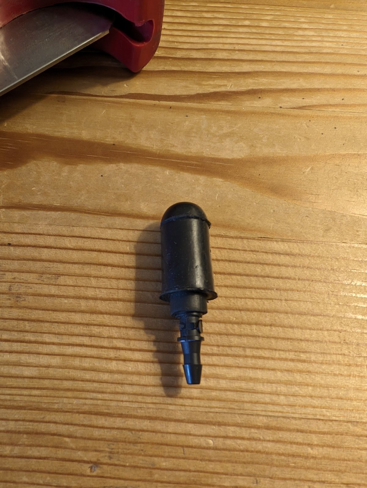

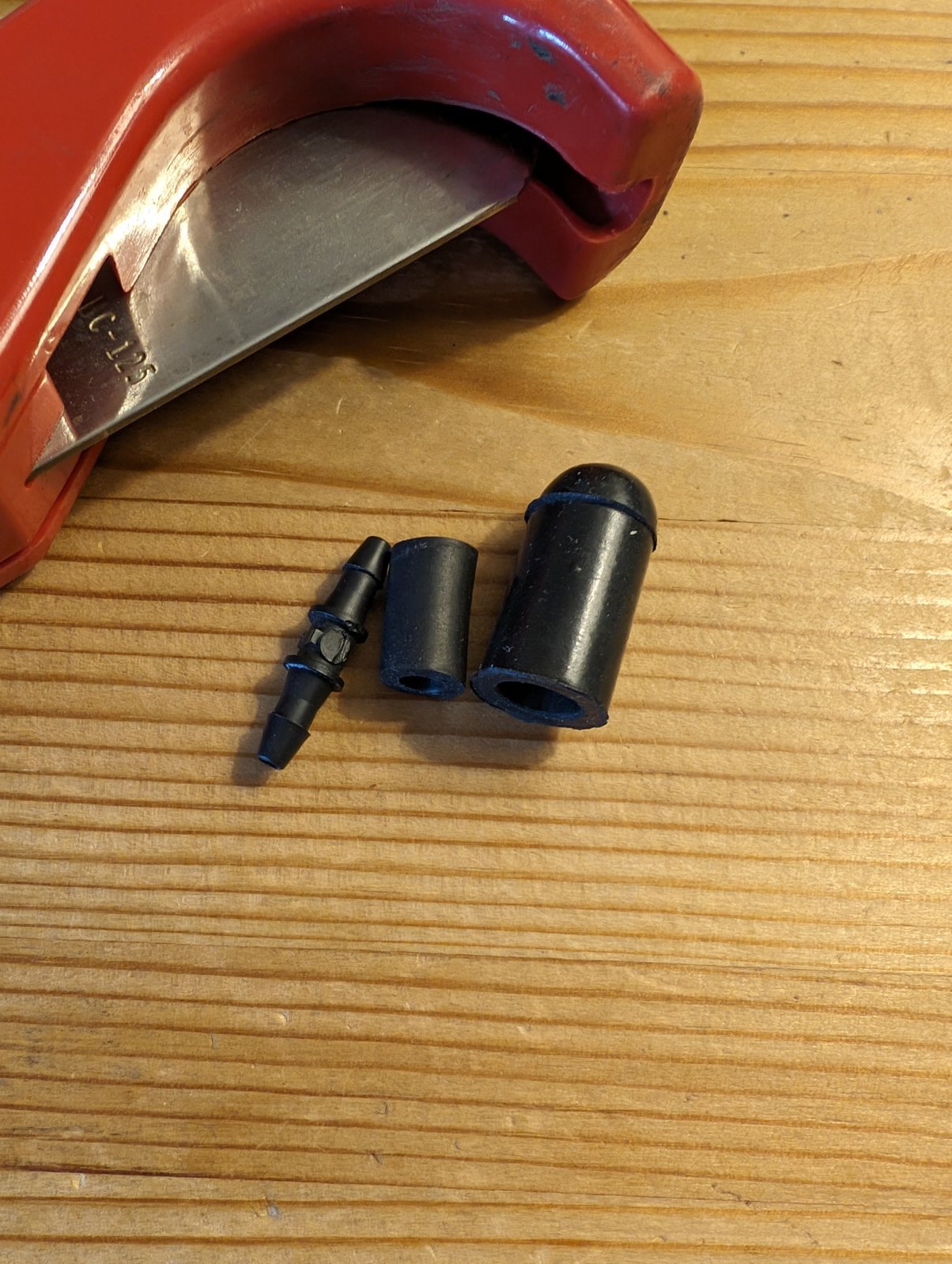

    Five minute fix! Just cut a long enough bit of the same sized hose that was on there, then fit one of the larger rubber caps over the hose. Tight as a fella could wish for. :rofl:
    armyoffoo and ARES35[QUOTED] like this.

    I'm glad I could bring it to your attention! You just had a tiny bit of unmetered air coming in:D
    Wynnded[QUOTED] likes this.

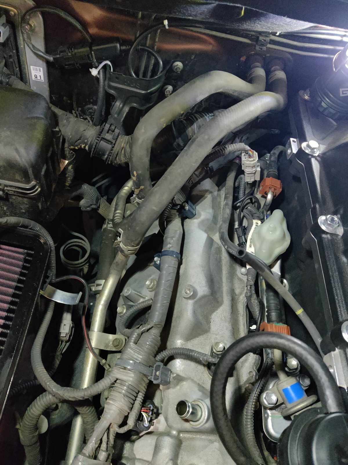

    Alright everything is back together! Double checked all connections/lines/bolts and clips. Started her up and as expected running rich with misfires on all cylinders, but hey no fuel leaks! Now in the need for a 2650 base map to get these injectors tuned. Should I reach out to HP for the base map?
