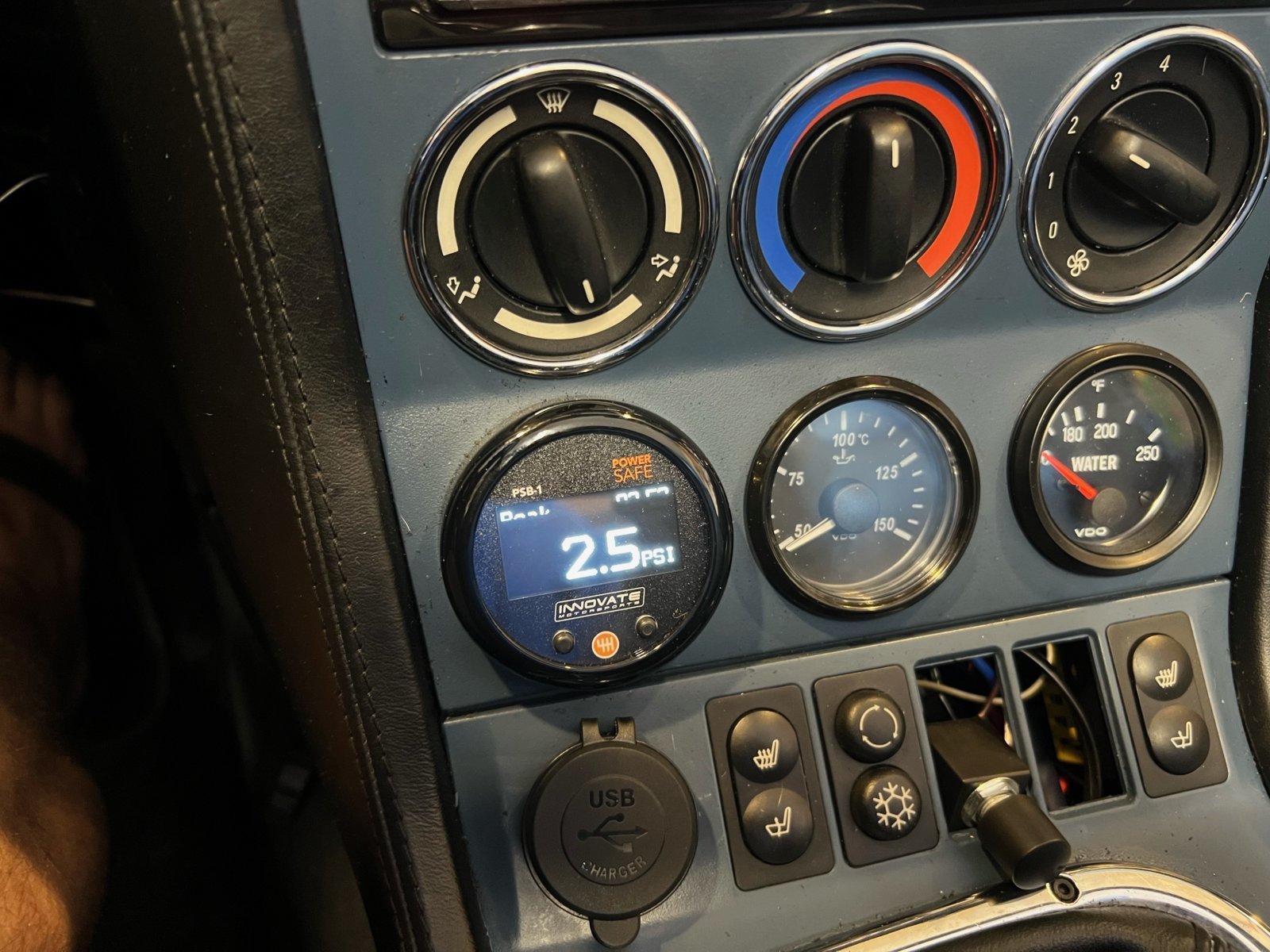

    I'll see your 14 & "raise" you 2.5! (first positive number the BMW has seen. They have the MAP connected to the BOV vacuum, doesn't seem right.
    Blanks have been ordered to house the sub volume knob & LED/glass break sensor for the alarm.

    I rolled into it. Didn’t know I was gonna do a hit till I saw the road was clear
    And
    I realize that 11psi is not due to my zen knowledge of boost as I realize it more an indication of the plethora of restrictions I run
    11psi is just ignorant. In a mature way

    Doh! I was looking at the left gauge. Lol

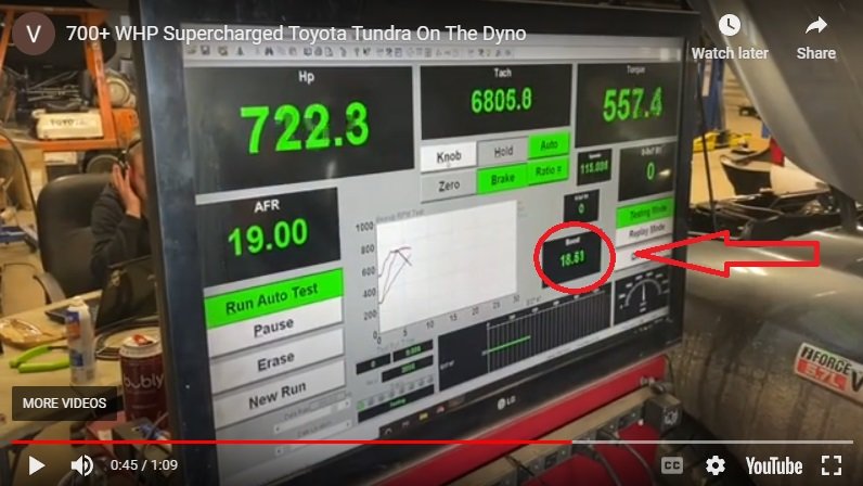

    You'll be fine. 16 PSI wont be anywhere near maxing out your new engine's capacity. I would guess 650-700WHP.
    I think this was shot at 20ish PSI:
    https://youtu.be/q18dzzlHM7Y?si=aIVRI00fwTx9hR8-

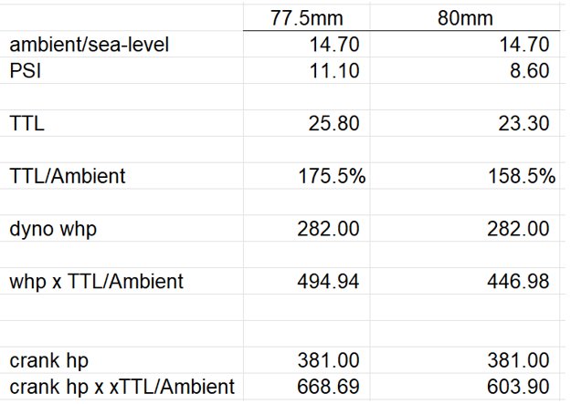

    I think you'll be close if you don't hit your goal. Hard to say with all the variations.
    Using the Holdener formula and not accounting for inefficiencies and parasitic loss you would need to push ~45 PSI (sorry 30 psi) to hit 1000 HP. On a blower set up probably higher PSI to hit 1000. I think the transmission in the video just has a valve body upgrade.

    There was a boost gauge attached during that run and you can see the boost on the screen, peaking around 18.5 PSI. It reads a little lower than the gauge in my truck though, so who knows what it actually is.

    So, i ran the Holdener formula. and come up with 494WHP....or thereabouts.
    which, if you harken back to my previous dynos, is pert-near right on.
    on the 80mm I did 477whp. the 477 is a smidge outside the formula.
    it would not be a far stretch to surmise the 77.5mm gives me ~20hp over the 80mm.
    Crank HP is now at the "demon core" level. or thereabouts.

    Yes it would be "off" a tad to account for parasitic loss of the blower; it should deviate more at higher power levels.
    He uses it to estimate blower parasitic loss in a few videos and to estimate how much boost you'll need to hit your target goal. I would repost the video where he talks about it but I've watched about 100 of his videos in the last few weeks. It helps if you know your baseline dyno number too.

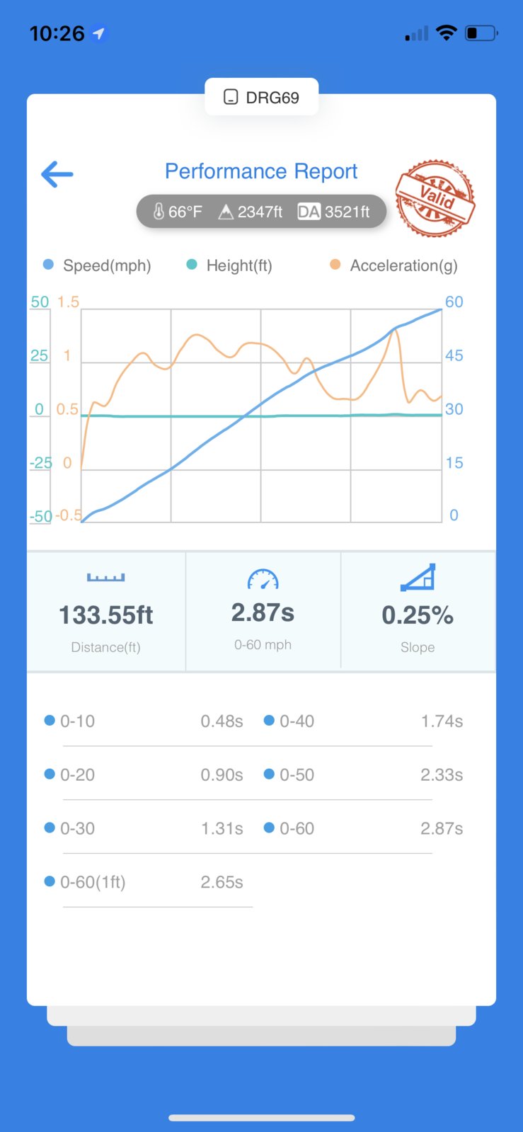

    2.65 seconds on a good day :)
