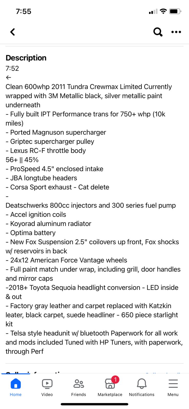

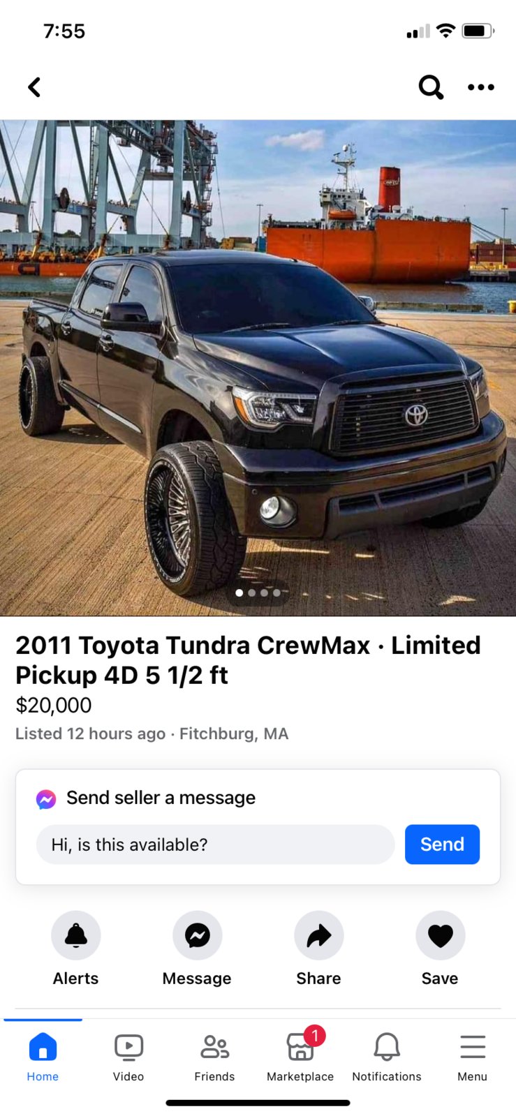

    I saw this truck for sale which has been brought up on here before. He claims to have DW 800cc injectors. I didn’t know that was an option, maybe if you call them it is? Either that or he is wrong about what he has.

    Maybe he meant 800mm wheel offset
