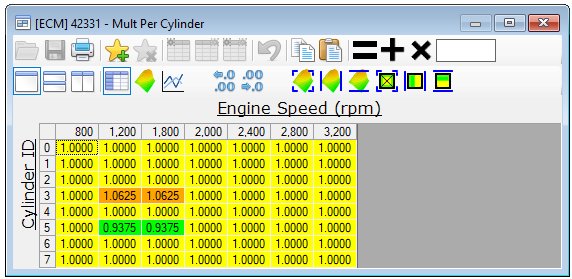

    When I had my engine failure it was cylinder 7, 8, 3 and 6 that went. So you can control individual injectors? I was thinking of the runner, manifold spacer kit, where you could install a water meth kit like aquamist. It allows you to control individual w/m injectors. Good info!

    Yes sir, specifically the Cylinder Mult (Engine -> Fuel -> General -> Cylinder Mult) which is a fueling multiplier (like power enrichment) that you can control specific cylinder fueling based on rpm, as well as when it initializes based on load parameters.
    This is the values I was referring to a week ago or so, where Cylinder 3 gets increased fueling and Cylinder 5 gets decreased fueling in stock form.

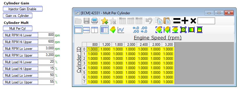

    Just got a tune from a guy, 2019 truck. The stock cylinder multi is way different than anything else I've seen:

    That is wild. Wonder what Toyotas methodology is behind this?

    Interesting. Any/all of the tunes that I have/have seen (not necessarily a large number by any measure) have that entire table set to 1.00.

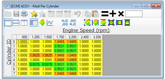

    I have no idea.
    This is the most common setup I've seen across a variety of years:
    Here's @helidave stock table, and his truck is a 2015. His is the only one I've seen with such low values. Like 1.56% fueling difference? How is that worth anything.
    But all of them have been the same pattern of cylinder, rpm, and fueling direction. Though looking at other tunes, one from 2021 has the same table as the above with all the stuff. So it seems to be only newer trucks where they adjusted a bunch of the mid rpm zones.

    Okay, I'm seeing it now. The reason that I wasn't before was because I had my current tune up and I was bringing up all the other tunes via Compare File. Operator malfunction here! :rolleyes::facepalm:
    The oldest one that I have showing the added fuel is from a 2013 N/A Sequioa FFV.

    Probably the same tune I had on my truck. All the TRD tunes I've seen set the cylinder multis to 1, as well as any spark trims for individual cylinders.

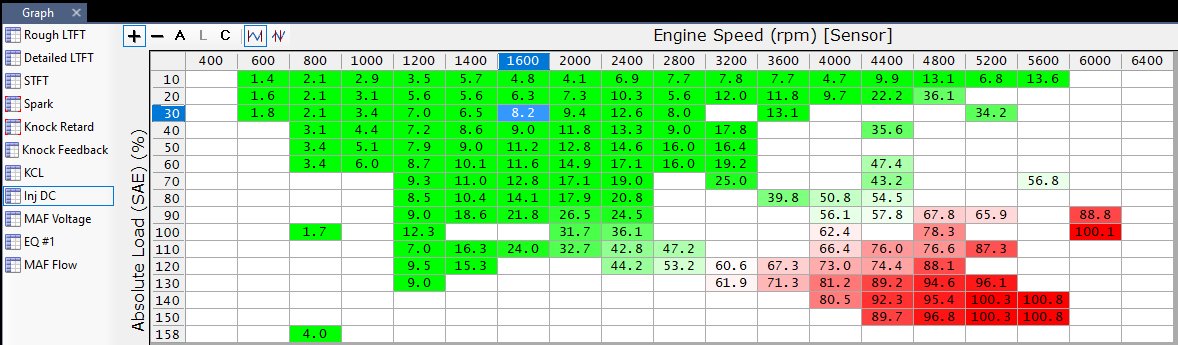

    I'm tuning another 2650 Magnuson, this one is at sea level, and it's very interesting. They apparently use the 535cc green injectors and the 4.0" Magnuson intake, so theoretically the same setup as a 1900 Magnuson comes with. From tuning @helidave it was odd though, I had to run a considerably higher injector constant and the 4in intake MAF values were considerably different than a 1900 Magnuson with the (supposedly) same 535cc/4in setup. @helidave is also at 7000ft elevation and was already using 80%+ injector duty cycle, so much to the point we had worries about him going to lower elevation on a bone stock supercharger.
    Starting yesterday I began tuning someone who reached out on Instagram, this guy at sea level with a stock 2650 but a 4.5in intake. I started out with the values I got from @helidave for the intake (though scaled up for the 4.5) and injector constant which turned out to be on the money out the gate, thus showing the @helidave values weren't a fluke.
    Additionally this guy is maxing out the 535cc injectors at 5200rpm right now! With that said, the truck currently is running excessively rich (9.5 AFR) at the moment and I just sent a tune to lean it out (truck was having lean issues initially from I suspect a leak, which they seem to have fixed now). Nonetheless, I suspect the injectors will be nearly, or completely, maxed out at 6000rpm after we gain a bit of fuel back from leaning out the power enrichment.

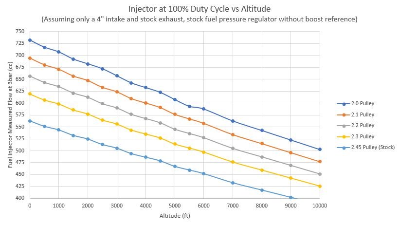

    Looking at @Silver17 comparison chart of airflow vs pulley size for the 2650 vs 1900, it's not surprising since the 535s are close to maxing out on a 1900 in stock form as well, and we know a stock Harrop moves enough air to easily max out stock injectors. But I still find it wild how close to the ragged edge completely stock superchargers are when it comes to fueling.

    Interested to see the injector dc once you get their afr dialed.

    my stock intake 80mm pulley harrop was jusssttt about to max out the 650’s. I think I was at ~89%

    Are you guys with Magnusons switching to at least boost referencing your stock pressure FPRs? If not you’re dropping a pound of fuel pressure for each pound of boost, which definitely doesn’t help the matter! That’s just dropping fuel pressure when you need it most. It’s hard to imagine not running boost reference on anything boosted the more I think about it. I’d love to see how with no other changes to the tune, how much boost referencing drops the duty cycle.
    Also, as long as the Magnuson users are running stock pressure with no BR, the comparable Harrop 2650 will appear to run a lower duty cycle across the board between both the higher pressure regulator and BR.

    Matches my Harrop at 85mm with stock air box.
    AFR's 9.4-9.8 (will lean/smooth out a tiny bit)
    MAF 4.98V @ 6,000RPM
    Inj DC @70% @5,600 75% @6,000
