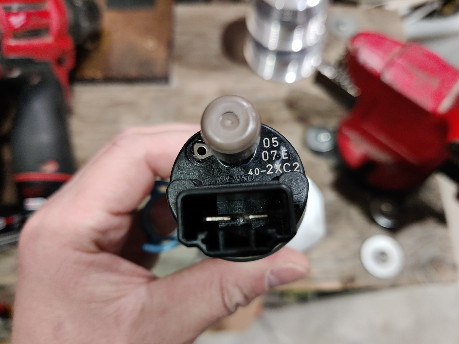

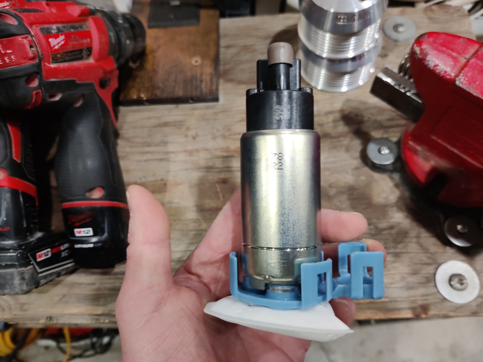

    Here is the non FFV fuel pump supplied with the Magnuson 2650 kit. I've crossed referenced but haven't found the specs on flow yet....
    Saltyhero13 likes this.

    I have no clue on FFV pump specs but can say it looks identical to the Walbro 450 (I posted a pic side by side when I was having my pump issues)
    ARES35[QUOTED] likes this.

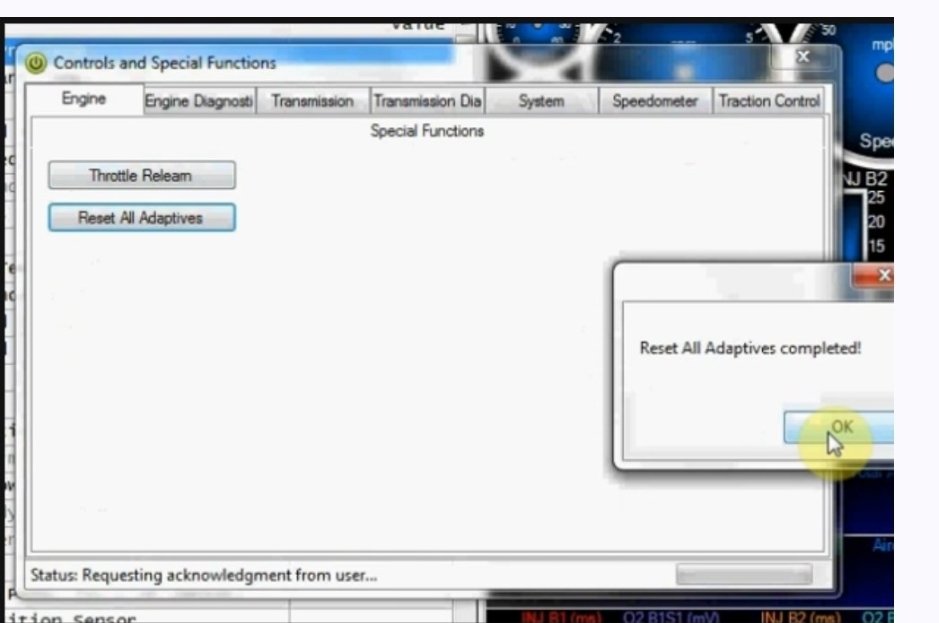

    After touching base with @snivilous I've decided to scratch this worthless ass HP RTD/remote tuning and go MPVI 3. I'm not looking to break the stock block power record by no means. Just good usable power at elevation.

    Was fumbling around on HP tuners site and tried the upgrade option on the rebranded MPVI/RTD-3 Magnuson supplies, for the MPVI3. Does not work, magnusons got it on lock down real good. Not surprising but disappointing lol. MPVI-3 in route. Does anyone know if the MPVI-3 can read the base map from the RTD-3 tune? I'm going to assume thats a big no haha
    Mdl, reywcms and snivilous[OP] like this.

    Probably not but it should generate a basic trd tune that will enable the ecu to be written to. I read in the past some had to contact hpt and they helped with a basic tune for your VIN.

    It will download a tune from the HPT servers based on your ECU ID, even if you flashed the tune from Magnuson it would still download the same file. I wouldn't be worried, it should be smooth since your truck isn't brand new.

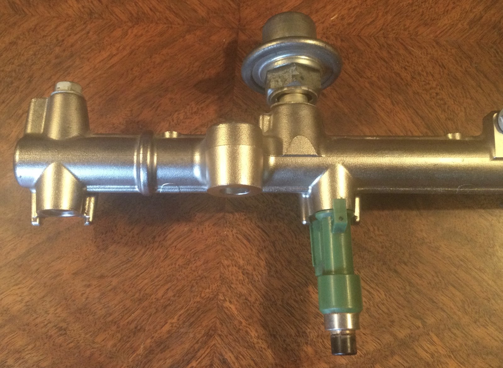

    Jowett
    Jowett New Member
    Mar 19, 2021
    #60646
    589
    Brian
    North Adams, MA
    2011 Regular cab long bed 5.7 Work Truck Package
    Many on the way.

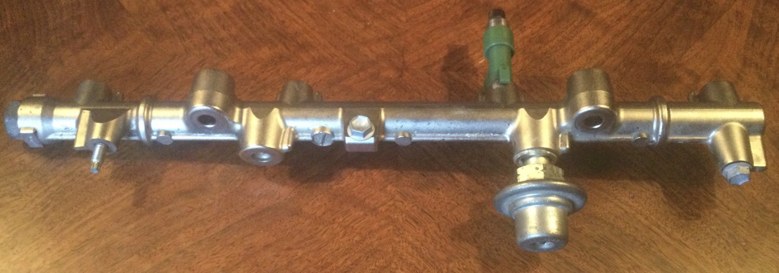

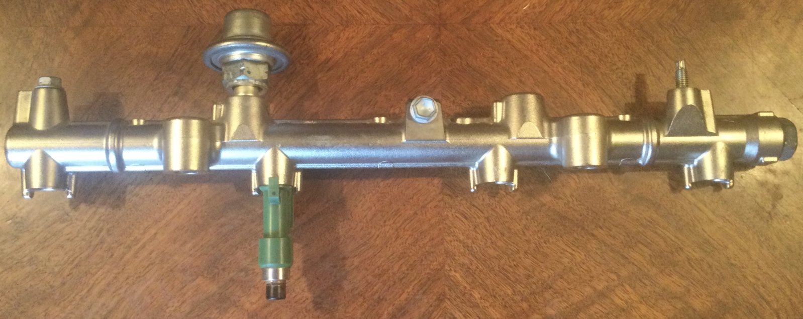

    Fuel rail possibility? This is a low pressure rail from the 2008 - 2014 IS-F 2UR-GSE 5.0L V8. All the other UR engines have stamped steel. Injector spacing is of course spot on. Mounting looks different from the stamped 3UR-FE rail, but shouldn’t be a problem to adapt. The fuel damper is the traditional style, and each rail receives its own, so two total for our V8. Left and right rails are the same casting, but have bosses machined for each side. Opening up the second boss on each rail will allow multiple feed locations and/or cross overs. Each rail also has an M14 bolt plugging the end. The ID of the rail is 11.75mm or .462”, which is a tad larger than common 8AN type rails. 7CA5EC71-387F-4D31-9762-746F106E4269.jpg E6BCB620-AB86-4D9A-A93F-47BD2F9DE2E3.jpg D7B6827D-D45C-42C7-9B59-DF842AD090EB.jpg
  30. Dec 30, 2023 at 12:25 PM
    Mdl
    Mdl Hey there...
    Jun 14, 2023
    #98638
    3,528
    PNW, WA
    2007 TRD SC'd
    JBA Longtubes, Snivs 2.0 SC pulley, ASP crank overdrive pulley 6.71 in, DD Full 3inch dual exhaust, IPT valve body, Airbox mod, 4.5inch intake, Denso 750, 450 Walbro, W/M injection, GM 95mm TB, SABM, Camburg UCA, Icon shocks, Speedmaster LSD, Motive 5.29 Gears, Mickey Thompson Baja Legend EXP 35's, Solid Offroad engine and transmission mounts, DIY Traction Bars, Tuning by Snivspeedshop.com
    Nice! Now I can try to have a true -8an supply other than Prospeed if it can be had for less$
    ARES35 likes this.
