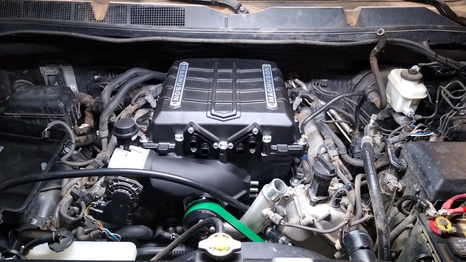

    I was in a rush and didn't have spacers. Used a Dremel to cut off nub and flat cut top of bolt hole on mount. Need to touch it up with black paint marker still

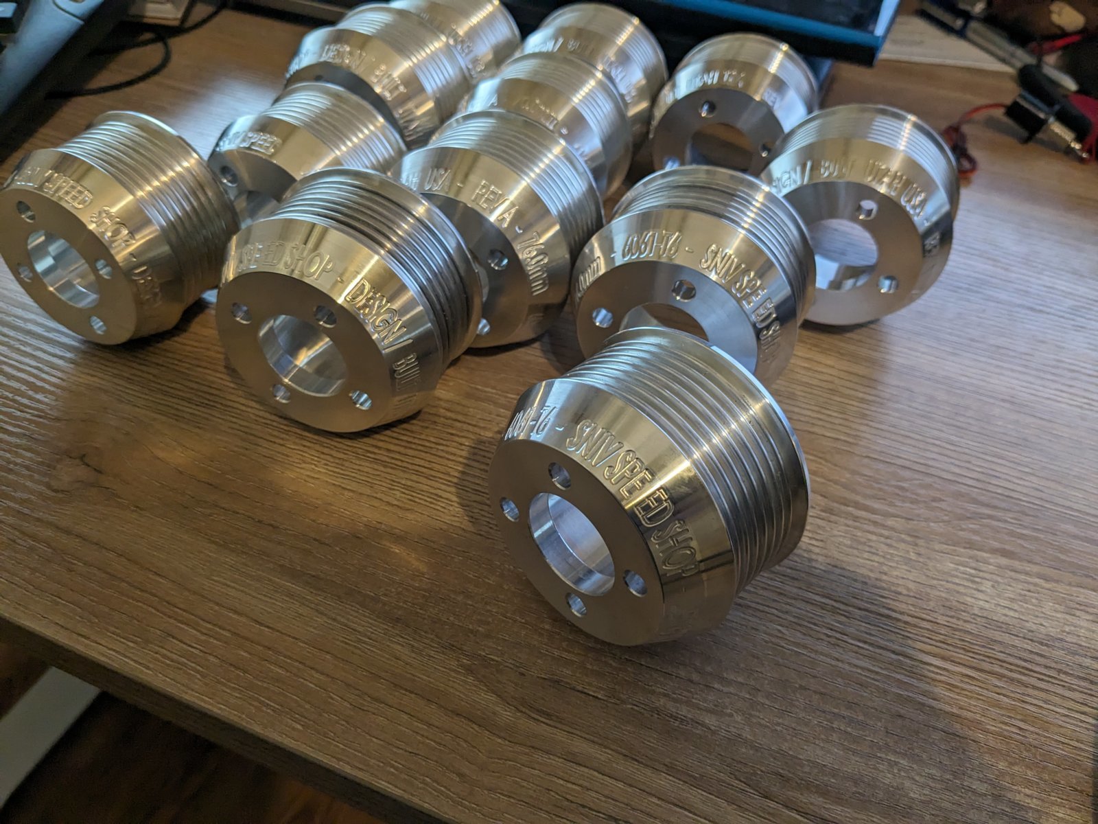

    Gonna need one of @snivilous smaller pullies. Being at 7000' sucks

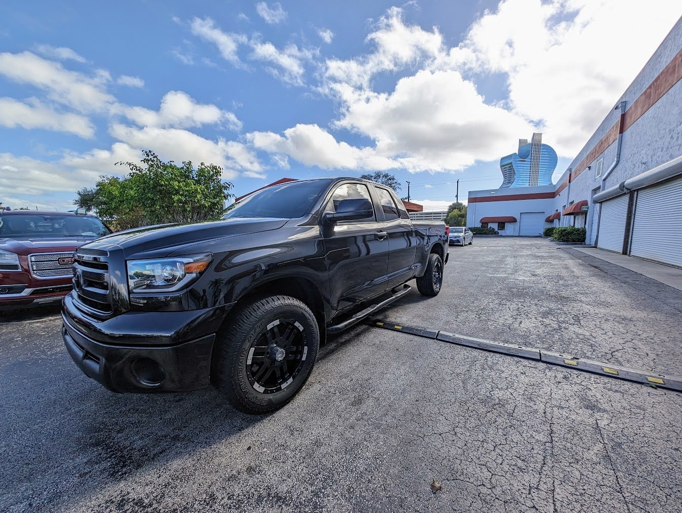

    Just picked the other Tundra up from a fresh paint job yesterday. It's a very metallic Corvette black now. This is the 4.6 v8. Trying to find some little performance bolt-ons for it but doesn't seem to be much out there. May just swap air filter, throw an exhaust on and get a custom tune.

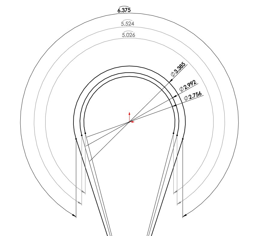

    Any idea on belt sizing for the 76mm?

    Based on @Wynnded measurements and some CAD, the 76mm will need a ~0.851" shorter belt and the 70mm will need a ~1.349" shorter belt. That's based off a ~6.375" belt wrap length with the stock pulley:
    Stock belt is: 116.188" K081153
    So 76mm needs somewhere around 115.267" and 70mm needs around 114.769".
    There's a gates 115.063" K081145 which might work for both? I haven't looked at other belt brands.

    Seemed like the belt that came with my kit was way longer than it needed to be. The tensioner had to take up a ton of slack.
