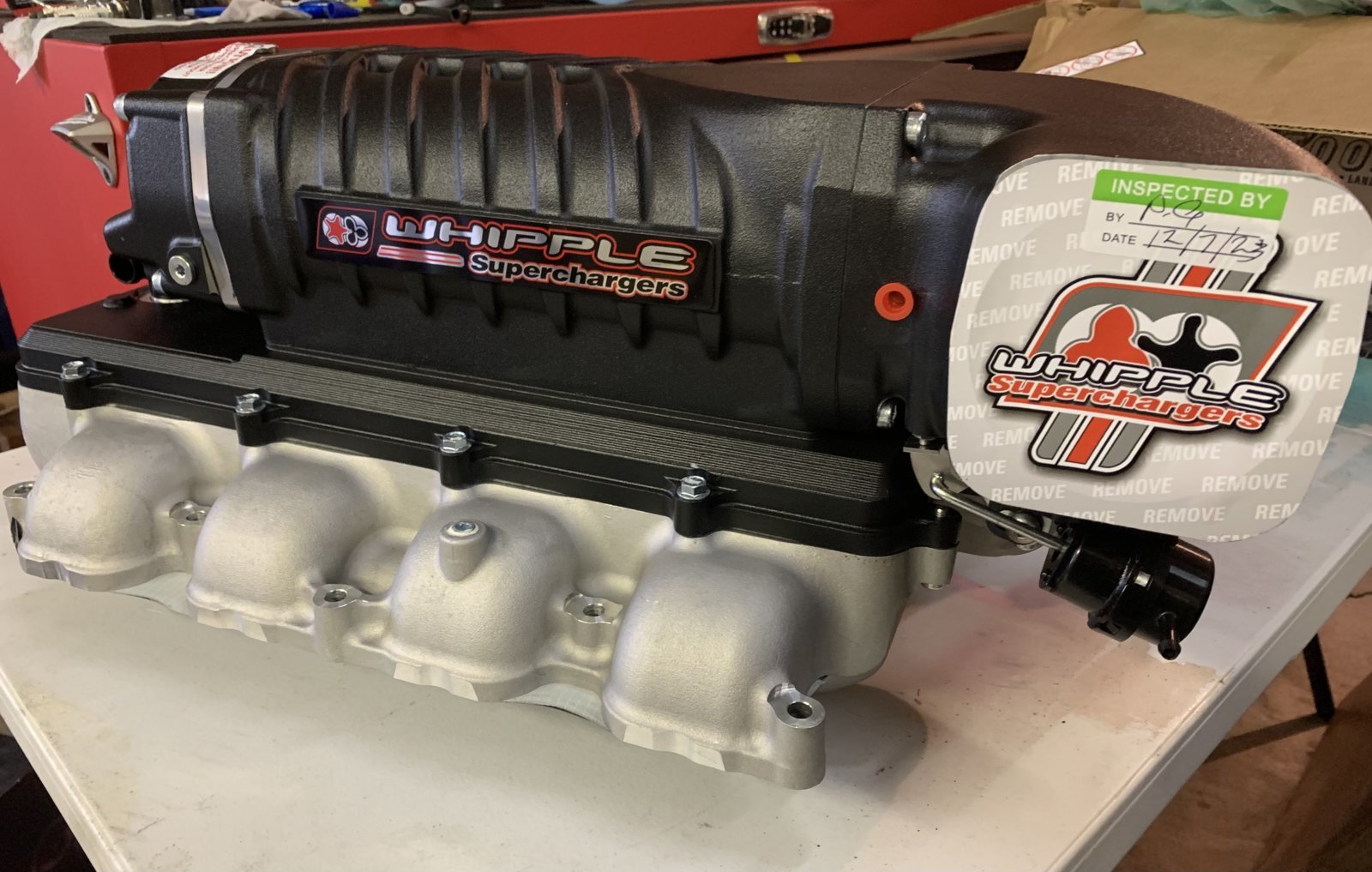

    Just read through the install manual - they recommend inspecting and replacing spark plugs every 10k miles. Anybody doing that? That seems a little excessive...

    Check the parts bags make sure everything’s there according to the install manual. We had a missing fitting on the old man’s according to the shop.
    Not sure if that’s true or not but doesn’t hurt to confirm before the install. I didn’t have any issues on parts outside of making certain items work with my trucks setup. I’ll send your pulley out tomorrow!

    Thanks! Will do - I barely had time to rip open the blower and make sure it was there before I had to head out again.

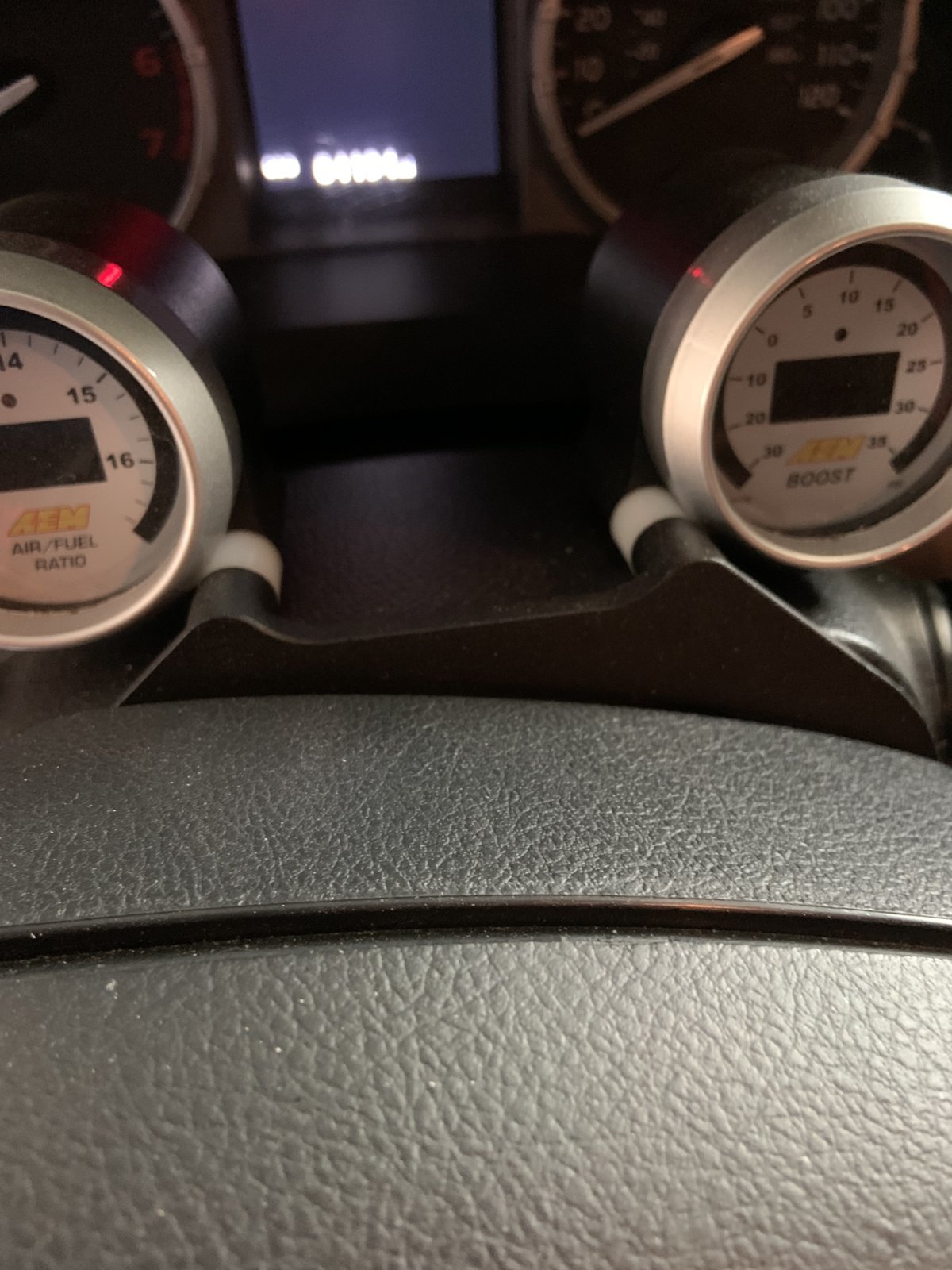

    Needing some help with installing AEM Wideband gauge on Cravenspeed mount. Did the plastic bezel around the gauge have to be modified? Seems like it has to be modified. Any insight would be great.

    no.
    just the gauge pod is moved back with some washer type spacers

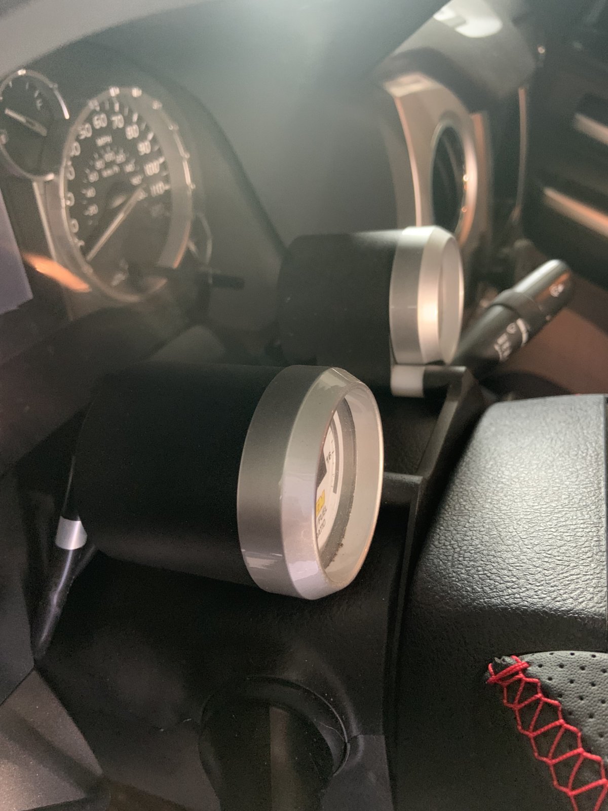

    No, but I thought about it too. I didn't like how the gauges sat so close. I'm now playing with this setup, and will probably glam it up with hiding the threaded bolts behind some sort of black sleeve. Or just paint it.
    [​IMG][​IMG]

    Good deal. How did the gauge itself mount to the inside of the pod? I may be missing something easy

    I haven't gotten that far yet, as of now they're just sitting in there... but, it's a tight enough fit that they stay. I'm not really sure how I'm going to secure them in there. Part of me is thinking glue, or make-up some mechanical clamp using the studs in the back.

    Just get yourself some nylon spacers. I don’t remember where I got these, or if I also needed longer bolts with them but it did the trick.

    Yeah, couldn't find any at my store for whatever reason. anyhow, these are good ideas. was also thinking about 3d printing some. That would also allow for some extra strength/stability to be added.
