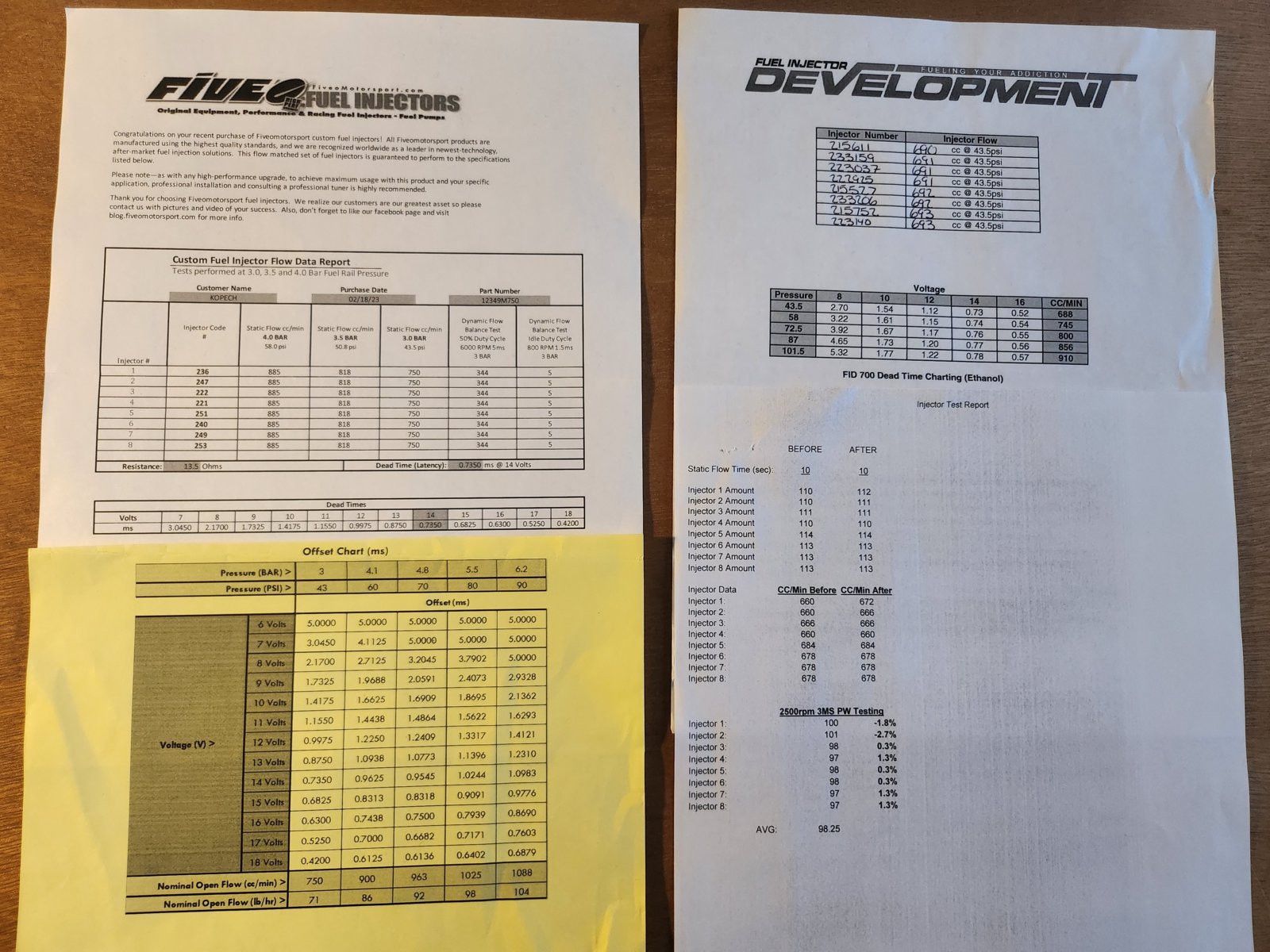

    Harrop has you clamp the stock regulator, but it's a guess what the pressure ends up being. ProSpeed provides an Aeromotive regulator that's boost-referenced and requires 60psi for their tune.
    Five-O data on left, ProSpeed on right...ProSpeed injectors test results at 43.5PSI are bottom right (before and after cleaning):

    The ones I have currently installed are FID725 with an average of 720cc/min @ 43psi. I was going to use the Fiveos for the same reasons. I have a remote start, here's how that was going with the Fiveos:

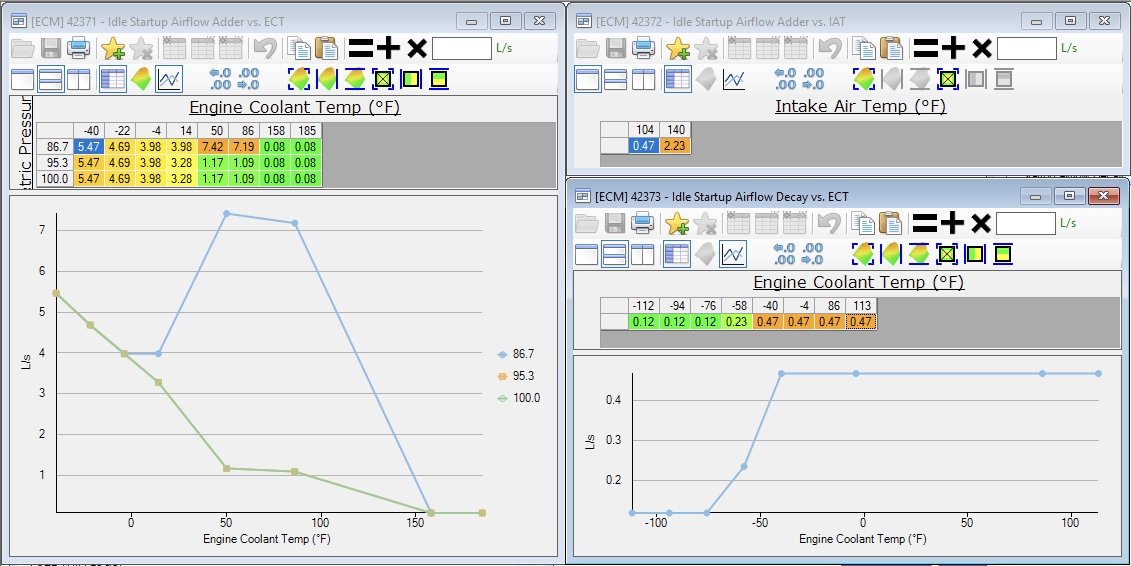

    I'm running the Magnuson greenies but also have the occasional limp dick start. What do y'alls startup parameters look like? I'm wondering if it's just not getting enough fuel on startup. Here's what mine currently looks like:
    My startup also surges* until the up-idle decays to normal idle.
    *I just compared this to an older tune and noticed that the Idle Startup Airflow Adder looks different for the 86.7 kPa - which might explain my surging. I'll look into it.
    Land Bruiser and Wynnded like this.

    Mine are currently stock with the exception of the Barometric Pressure axis in the Idle Startup Airflow adder, I have it set to reflect my actual pressure at my location along with some smoothing of values. So the pressures are something like 70, 85, and 100kPa. I've had them all over the place for testing and experimentation when swapping out injectors. The only reason that they are what they currently are is to make me feel like I'm accomplishing something. :rofl:

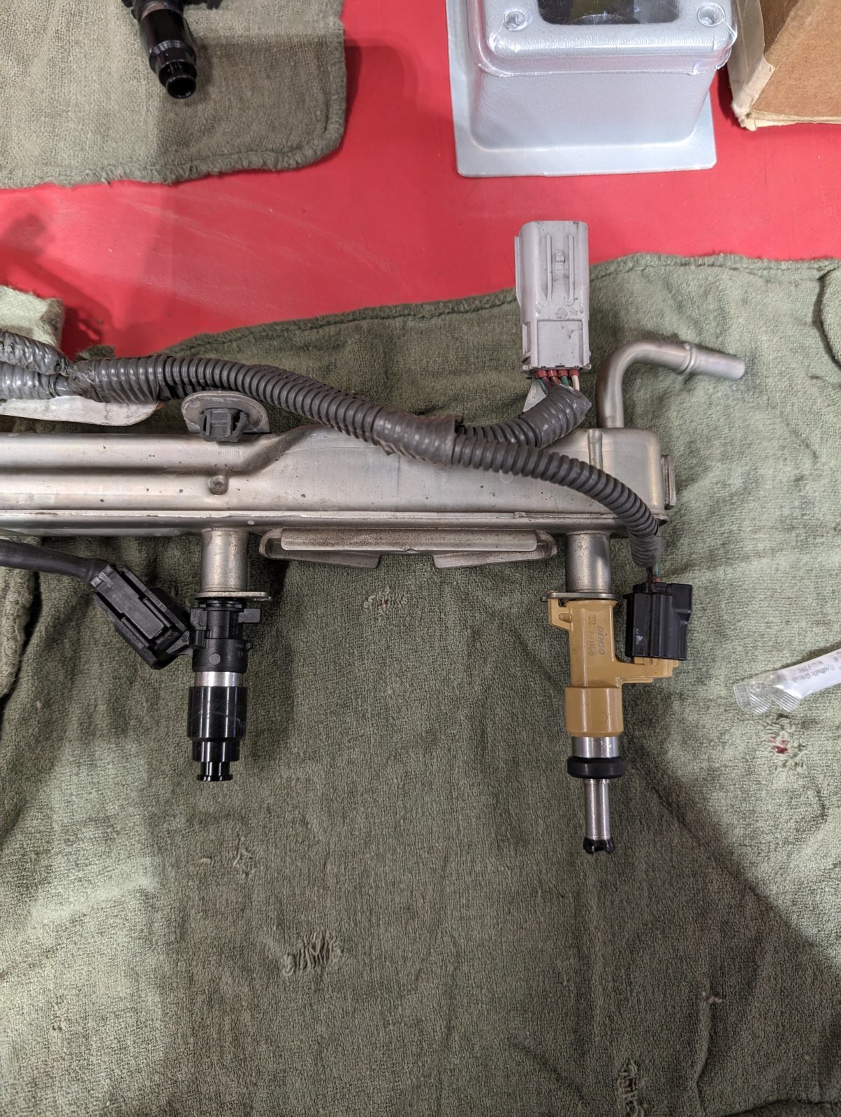

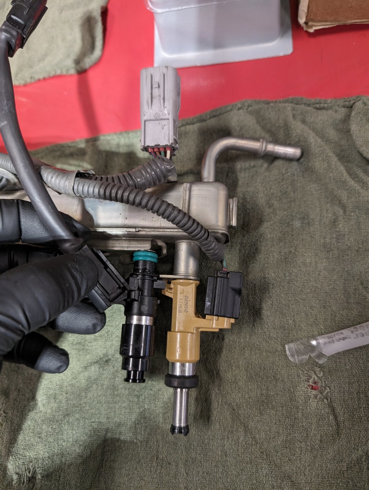

    I'm having something odd happen with my fuel injectors, well at least I thought they were the issue. Under WOT at 5k rpms I'm getting a cylinder miss fire, check engine lamp flashes and the truck runs hobble and I have to pull over and restart it. After the restart it runs fine, but I get the miss fire again under WOT and at 5k rpm. Runs great other wise. I installed new plugs, still there, swapped coils, no change. Replaced all 8 PS injections with a new set, same issue. I have no clue what's happening, but now that the motor is coming apart, I hope it gets fixed or that we see the issue. @snivilous has been a big help in trying to find the issue.

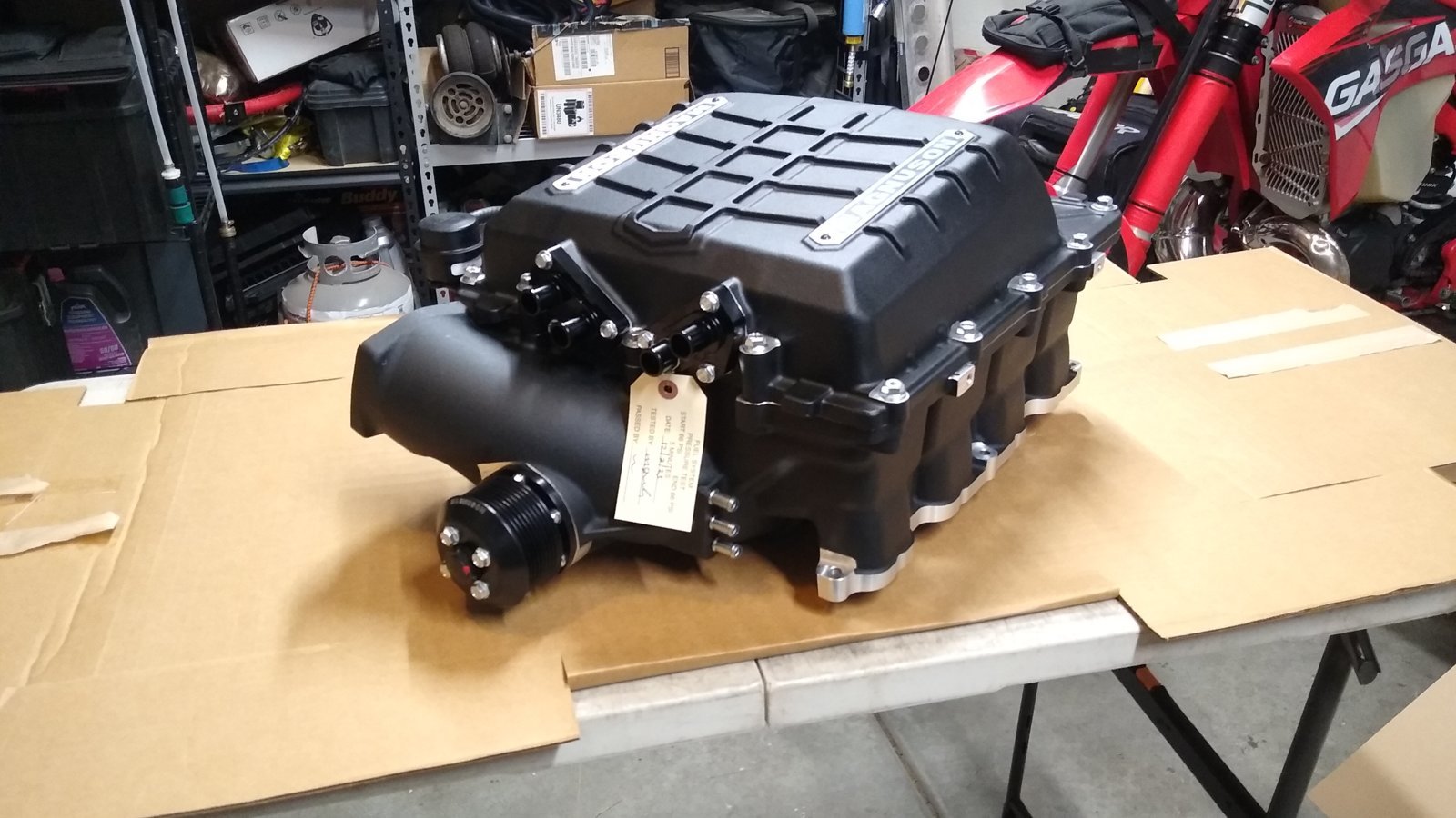

    Waiting around for pully and tune next has me a bit bored. For the holiday festivities lights up haha

    I had the same thing happen. Cylinder 7 misfire at high rpm. Not a hard misfire just intermittent. I did a compression check, 195psi, changed plugs, 2 step colder, gapped at .026 and new spare coil. It solved it. @snivilous and @ssmokedz gave some info to help. Usually a high rpm misfire is spark related. A true misfire will happen at lower rpm.
    Good luck with the build!
