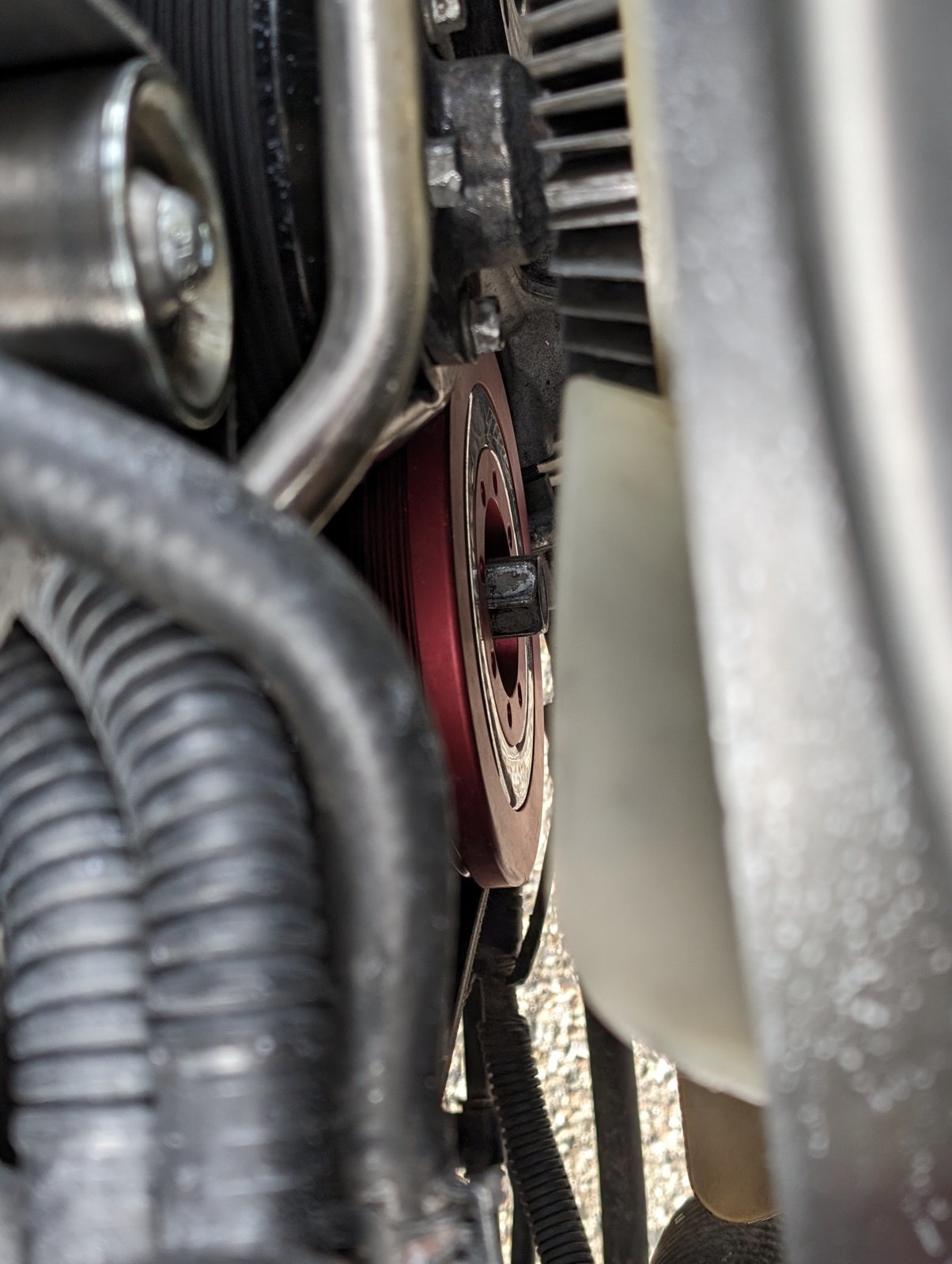

    XAT Pulleys and RR Crank Damper going in today. :militarypress:

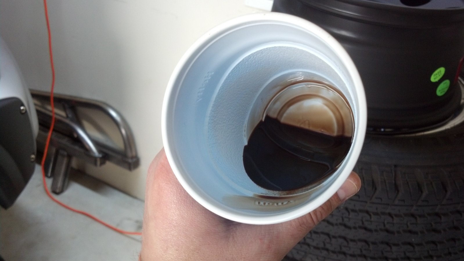

    I've already done it. There was no schmoo in the can but plenty of it in both hoses. Then I went a step further and disassembled it entirely, to figure out why.

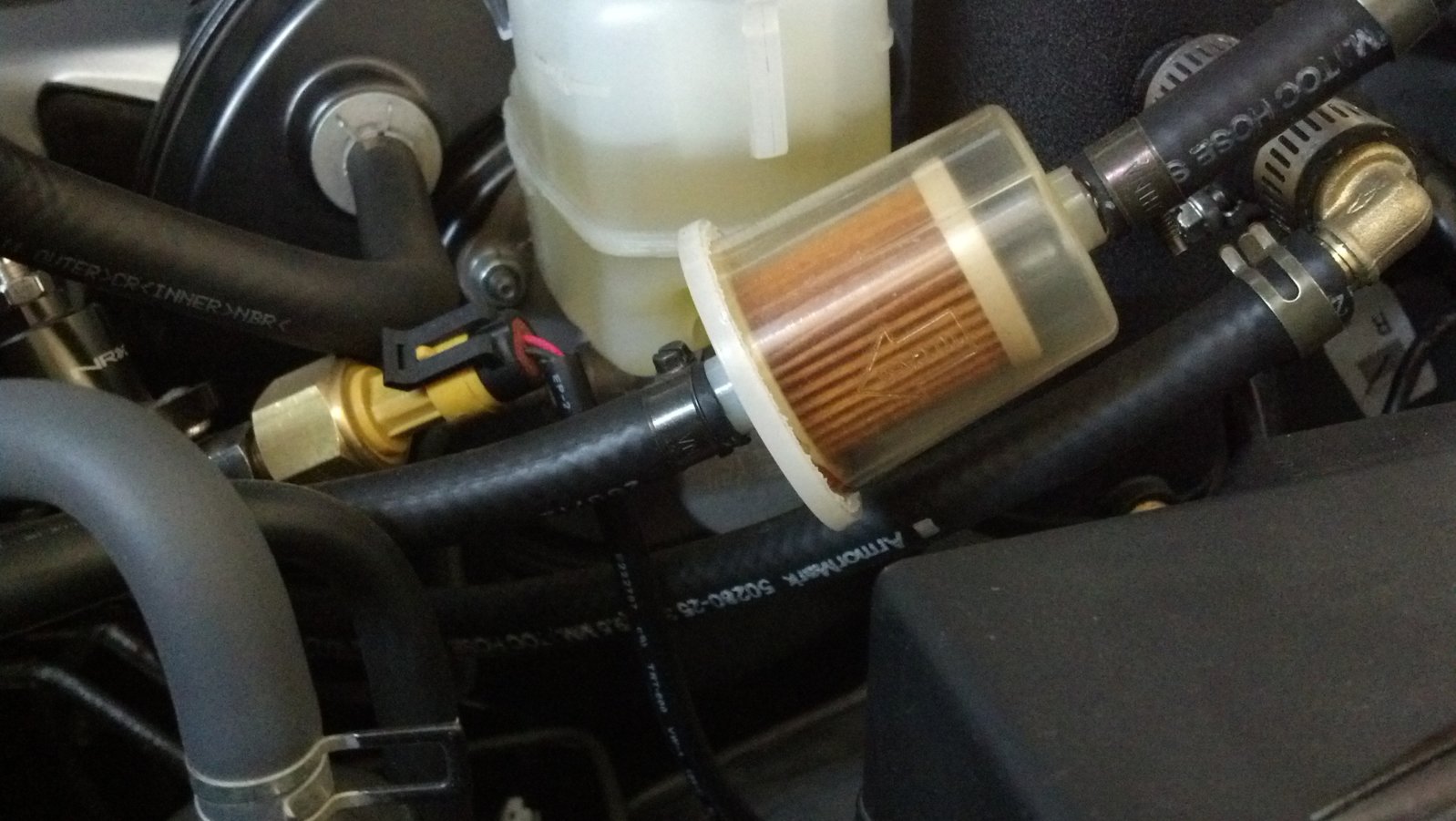

    You can put one of those cheapo fuel filters inline on the return side to see if anything is getting by. Replace it if/when it gets too dirty.

    Taking a stroll down memory lane...here is a picture of the catch can on my 2012 Tacoma with the fuel filter on the return side (replaced every oil change), and the amount of oil it caught between oil changes. This is before installing the supercharger, on a V6.

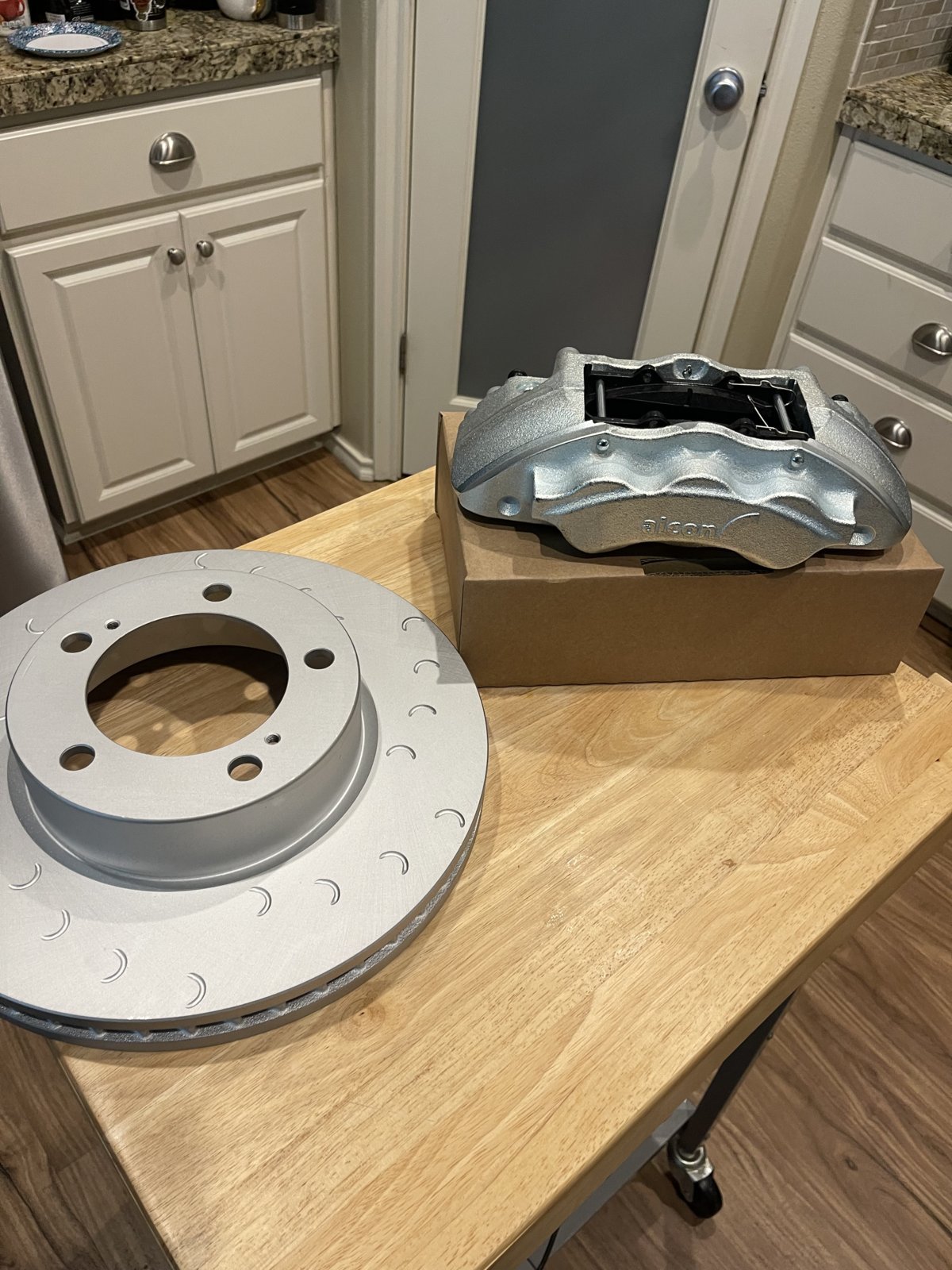

    I like how all your fancy new truck parts are put on display in the kitchen.

    Best place for it lol
