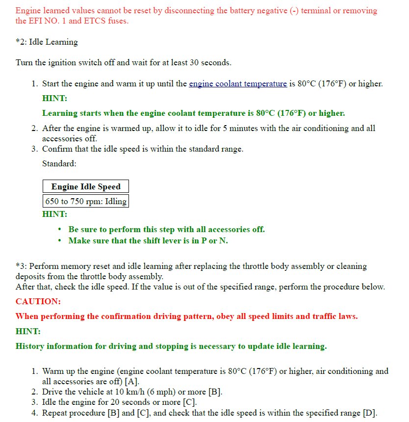

    I recently found out is that some learned values aren't erased when the battery is disconnected, some require manually resetting through techstream (or another device)...not sure which are which though.

    I'm not saying it's incorrect, just clearing up an assumption that I too was making. Spent a lot of time going back and forth with the D2A guy before we realized disconnecting the battery wasn't doing anything for us with regards to the throttle body learning.

    Well alrighty! You've saved me from needlessly disconnecting my battery... and setting the fckng clock over and over.

    Thanks for posting this. The instructions I've seen never mentioned temp values as part of procedure. Good to know the complete rundown.

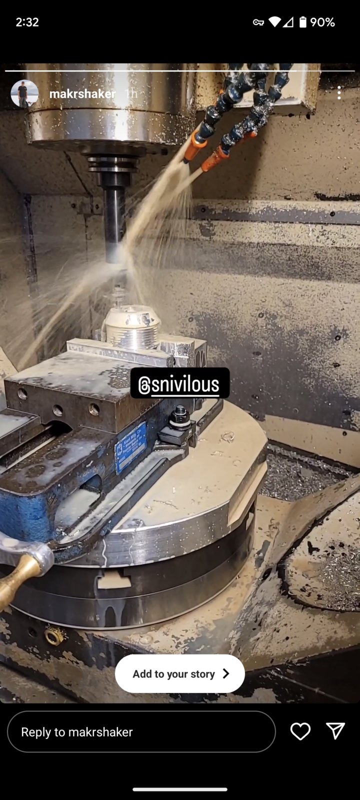

    I guess today is milling? :D
    mustang67408, Mdl, ARES35 and 8 others like this.

    Beautious...
    snivilous[QUOTED][OP] likes this.
