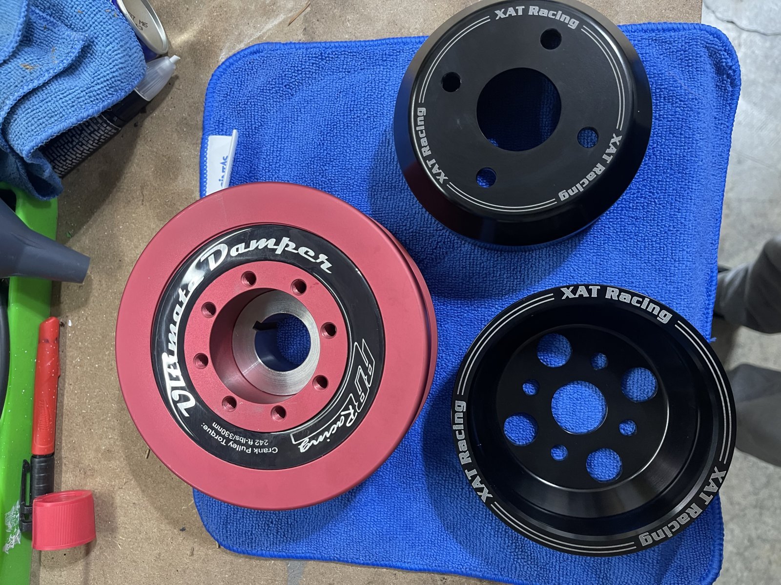

    Just got home and opened up the XAT pulleys. Looks good now to get time to throw them in.

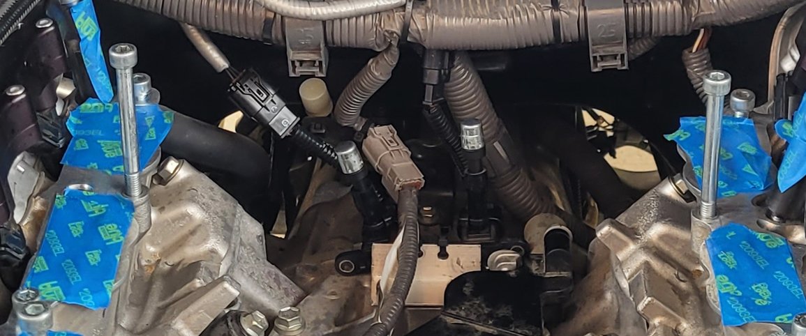

    Here you can see the bolt on the left that wasn't threading all the way down, compared to the bolt on the right that was fully bottomed. It was just about flush with the housing, but wasn't applying any pressure when torqued. I think only the weight of the SC was keeping it sealed until any boost blew past it.

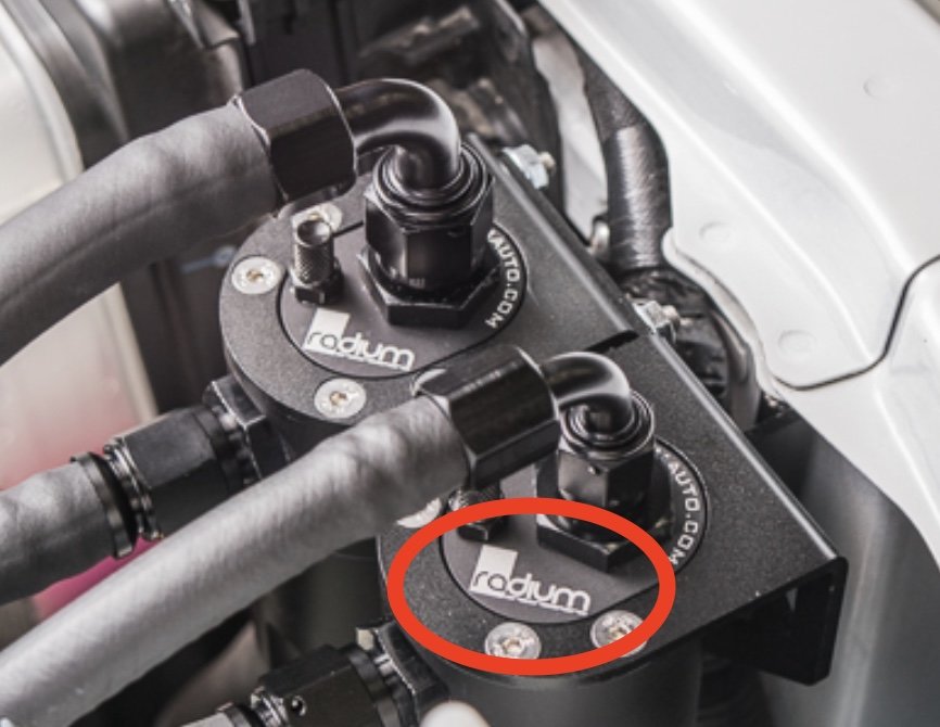

    So does the radium PCV can suck now? I just ordered one :annoyed:

    Also - worth mentioning ... when I opened up the supercharger to tap-out the stripped bolt holes, i removed the intercooler and saw quite the pool of oil inside... I mopped all that up, but seemed excessive to me.

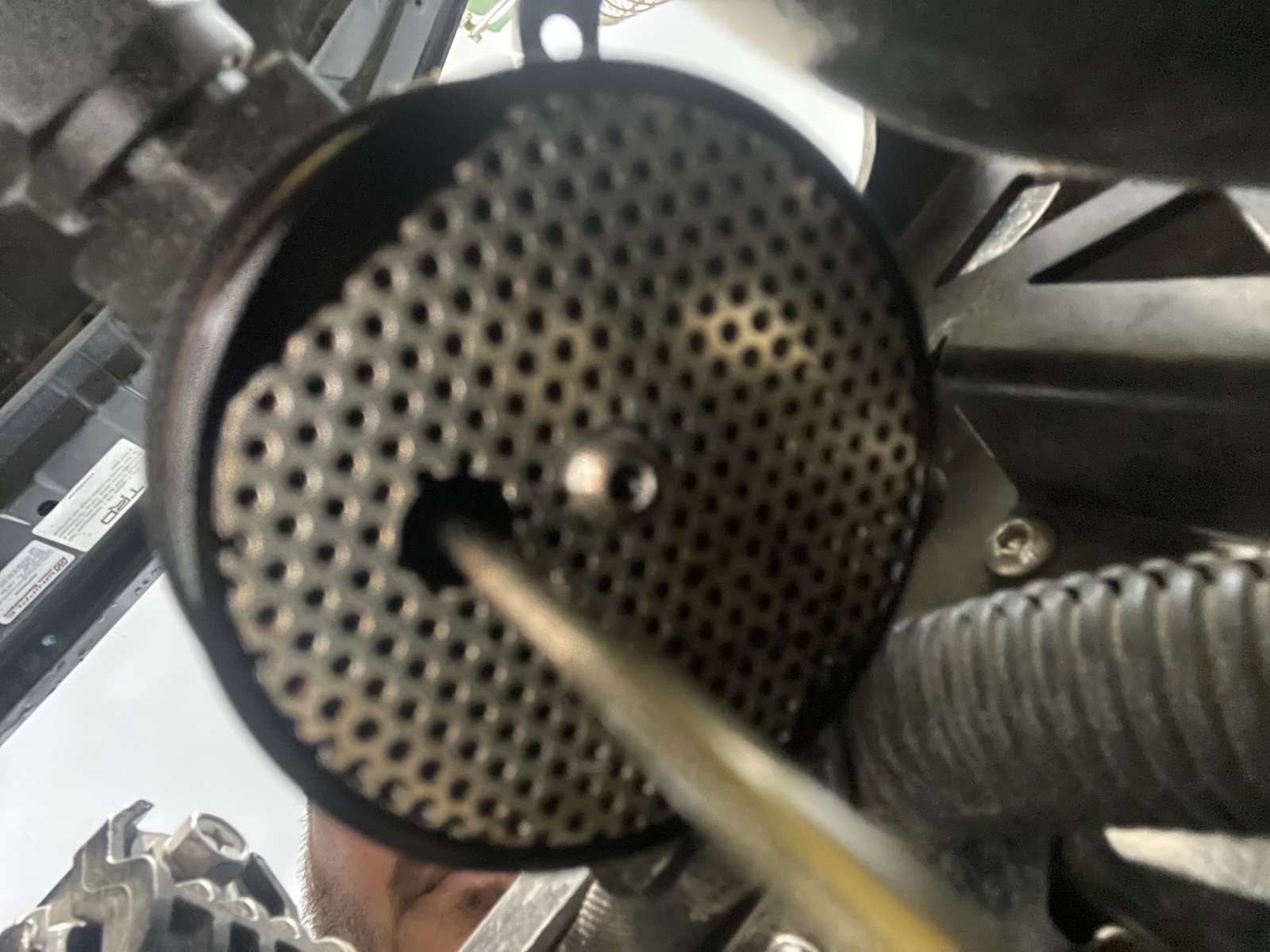

    I won't speak for any other version but if the guts look like what's in my photos, I'd return it. I purchased mine in July of this year. Hopefully it's been updated since then.

    Great now I need to check my radium lol

    Haha, share your findings with the class! If you have similar results, perhaps with enough of us we can get RE to do the right thing and exchange for working models.

    Full transparency, my exhaustion and lack of time got the best of me and I ignored the issue during installation and it came back to bite me. Hopefully, not the case for you, but I had to remove mine and chase the holes to get them fully seated and clamping down on the SC again. I checked each hole depth with my calipers, chased and verified I could thread each bolt all the way in.

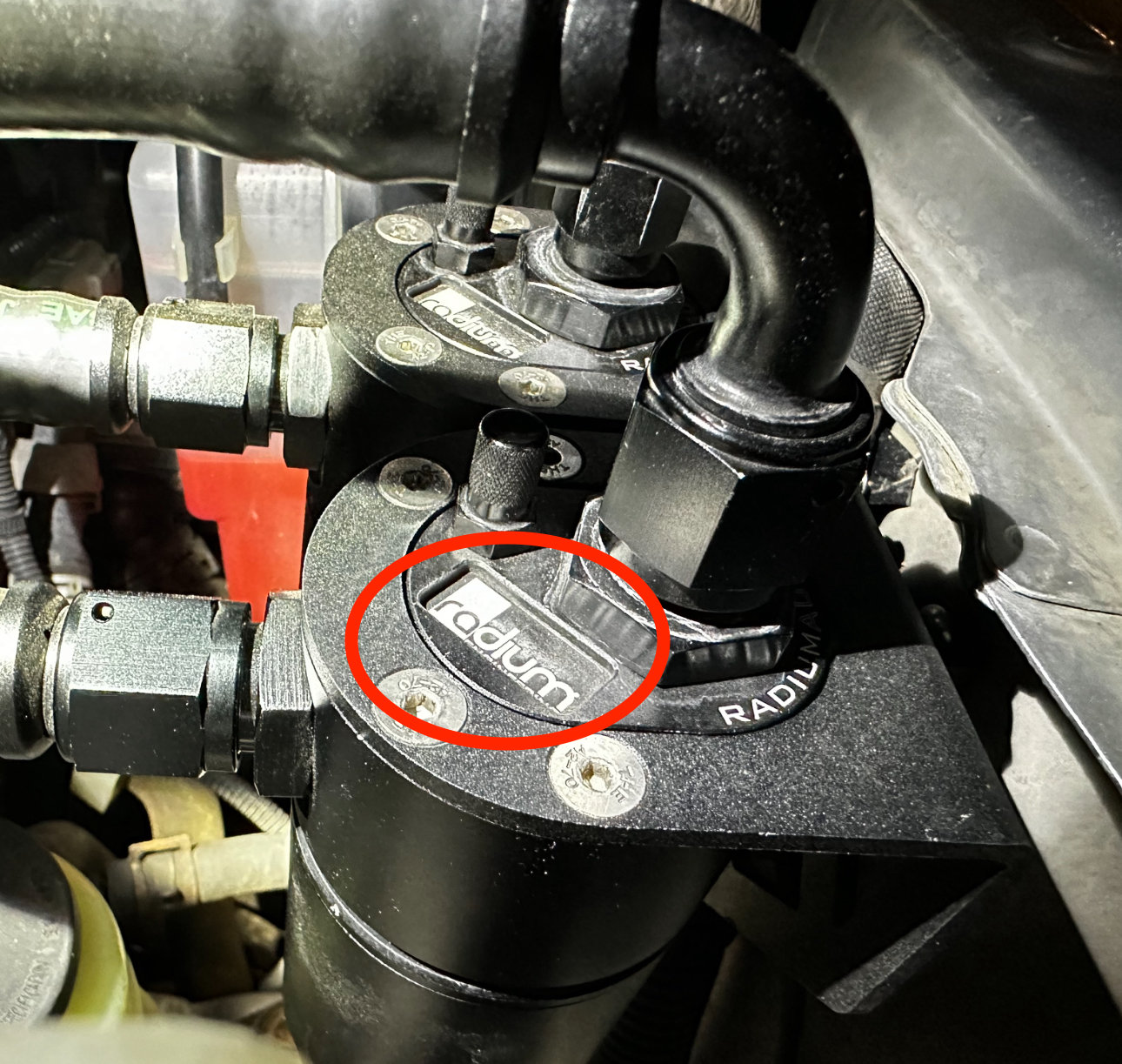

    New can:
    Old can(discontinued):

    It looks like the only distinguishable difference from the outside is that the new ones have a recessed logo. (Bottom pic is from my truck)

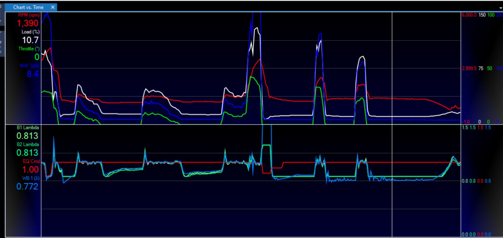

    Yikes. Well, I may have to check that next. I just checked the s/c bolts into the intake and several of them were little more than finger tightened. So, got everything snugged right. but looks like the issue is still present in the data - but I'll be honest... I don't really know what I'm looking at. If I didn't know any better, the system looks pretty ok. Do you guys see anything? I'm glad to send more shots of other data.
    Or, any more ideas on where to look for this leak...

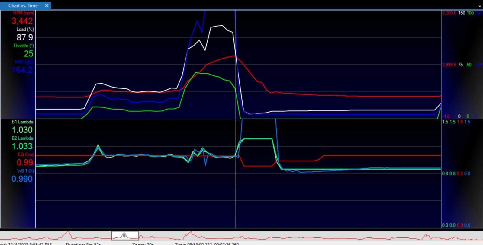

    You are running rich! Where your tracking line is - 0 throttle and lambda is 0.813 for banks 1/2 - that's an AFR of 11.9 assuming your commanded AFR is 14.6. Your Wideband lambda is indicating 11.3. Have you or someone else looked at your tune?
    I wonder if something is wrong with your MAF sensor and if the tune is setup for your current fuel injectors, such as correct injector constant.

    Makes sense as it involves both banks. You could post up your injector setpoints from hpt. Some are running the dw 650's and can compare if your off. You should reach out to your tuner to recheck the calculations.

    Interesting - a vacuum leak should lean out, not run rich. I'm curious what your tune looks like, such as the voltage/air density and injector constant. With the AFR being linear and not having codes, I would infer the tune is suspect.

    Checked my catch can this morning. Definitely works at collecting crap. Most I’ve had from my recent 2k mile trip. By most I mean maybe a cap or two full
