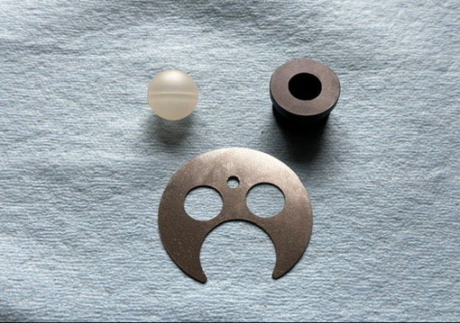

    I must have the new design. What a shame, as the machining and materials are great! Just terrible execution. They should have left it alone.
    Here are my findings:
    This photo identifies two things: 1) The clearance available for incoming gasses to bypass the float ball, if it were 2) not possible for the gasses to be drawn through the can as there is only one small opening, incapable of providing a path for the gasses to follow into and out of the can.
    This photo demonstrates the immediate path the gasses are able to take, completely bypassing the can. Consider the clearance around the float ball, the plug below the exhaust port, and the window bridging the ports.

    I'm pretty sure that is the new version since it has the overflow valve. Makes sense why those are seeing that problem with the tear down pics you posted.

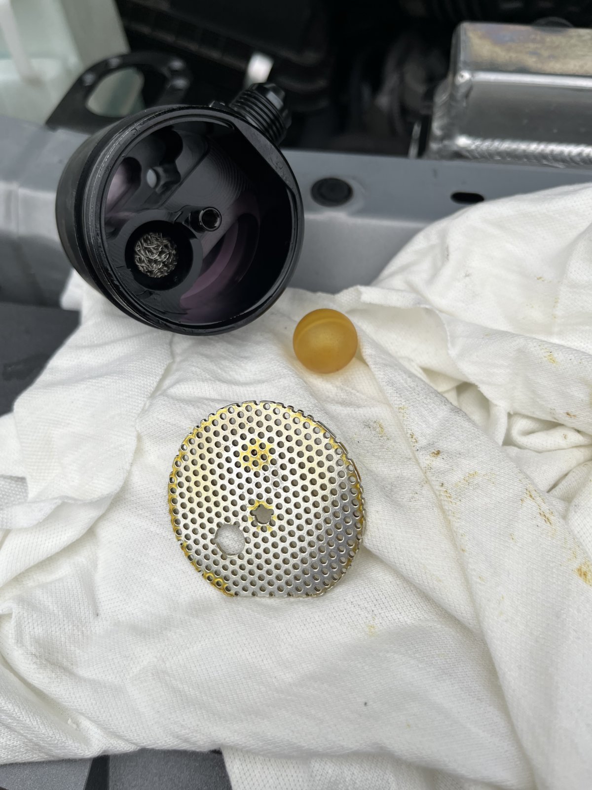

    Here’s mine.

    Interesting - how long ago did you purchase yours? I'm really curious what a working RE catch can looks like, being that ours are different from each other.
    If I had your catch can, I'd keep the condensate screen off and throw in a stainless Scotch-Brite scrubber. If it worked for mine I'd imagine it would work quite well for yours.
