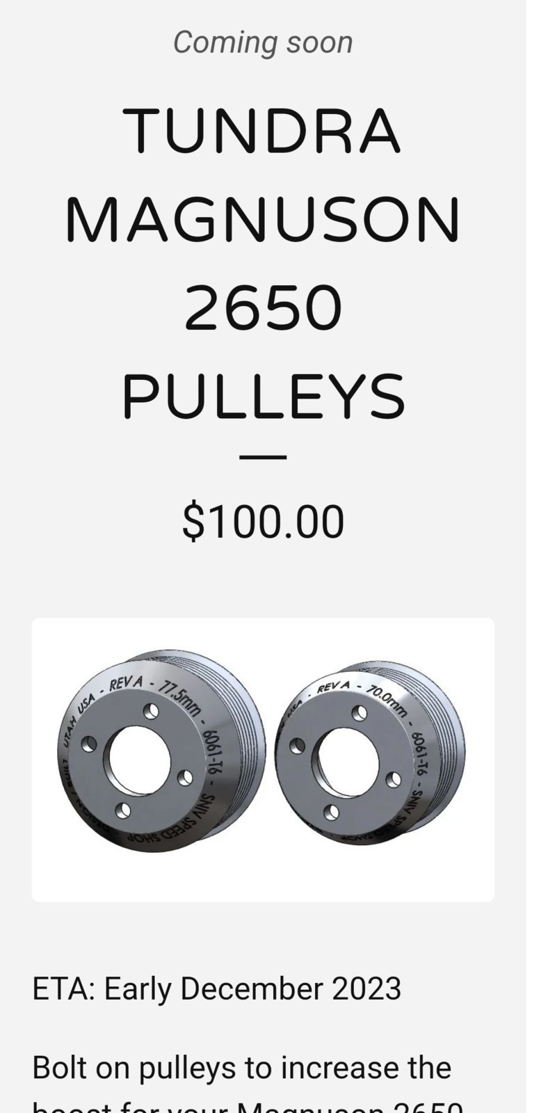

    Early December is here! I keep checking.... :(:D

    they should name the pulley on the right the widow maker

    seriously, This 77.5mm pulley is nasty
    You better have a kryptonite engine block and unobtanium pistons to run that 70mm
    at sea level, that would be some code red shit

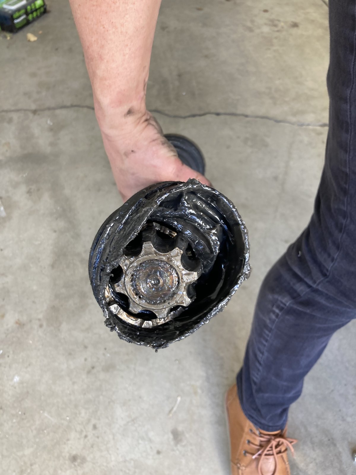

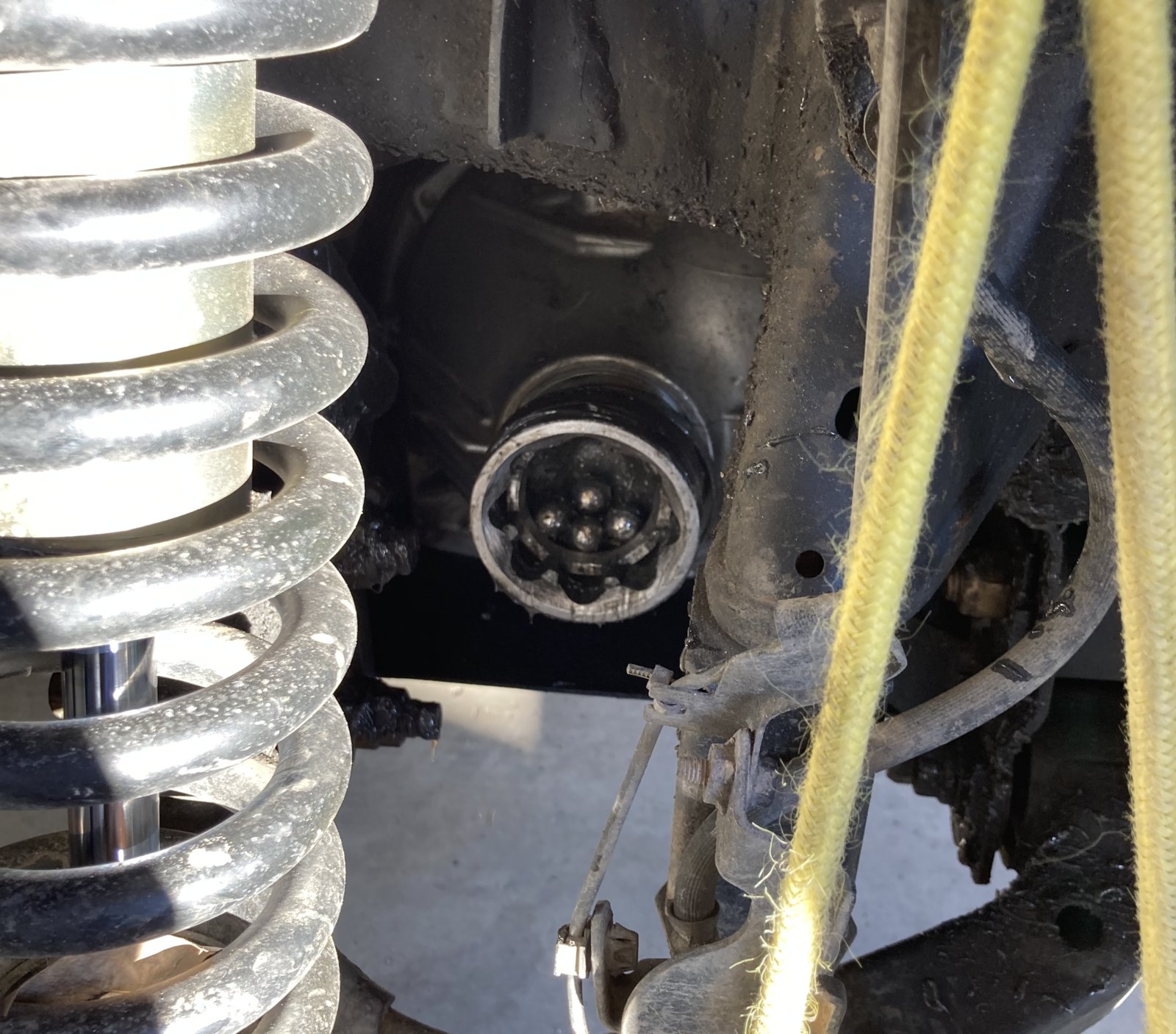

    Speaking of which… While visiting my folks for Thanksgiving, I took my dad for a quick rip and gave the truck the beans…
    I did manage to make 8.8lbs of boost, which is the most I’d ever seen! Haha
    I’d like to thank Sniv for the wonderful pulley, that helped make this possible :)

    Oh boy! Do share the details of the scenario that caused your beans to be spilled. How much lift in the front, and do you have a diff drop kit? Boosted 4x4 launch I take it? Lol

    Haha, he absolutely did! We both had a good laugh.
    • 6” Rough Country lift - not sure how much of a diff drop there is but not much.
    • 1 OEM CV axle
    • 1 aftermarket CV axle, supposedly for lifted trucks (shop that did my regear threw it in).
    • 1x 230lb gorilla with a heavy foot
    So! You were correct - 4x4 boosted launch, traction nannies turned off, and in tow/haul mode.
    It was going great right up until it didn’t. The road wasn’t as flat as I thought, and a slight deviation caused the FL wheel to hop. I heard the little ‘boom’ and knew exactly what it was. Funny thing was, prior to launching I had told my dad I had doubts about how long the aftermarket CV axle would last, and sure enough, it let go :rofl:
