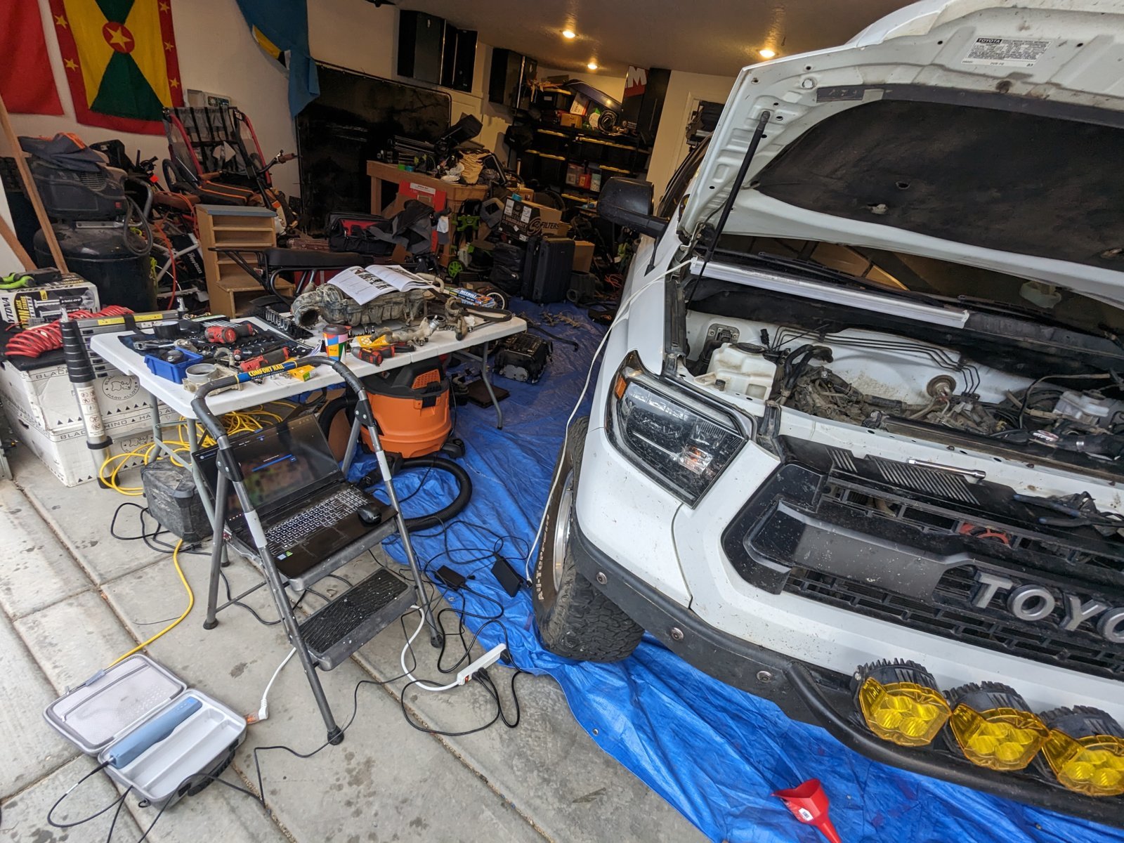

    I also have have a scan of the heads and intake ports. The blower scan turned out pretty good though! Did a full 360 scan of it since I'm here. I'll upload the supercharger scan to GrabCAD once it's processed if anyone wants to use it.

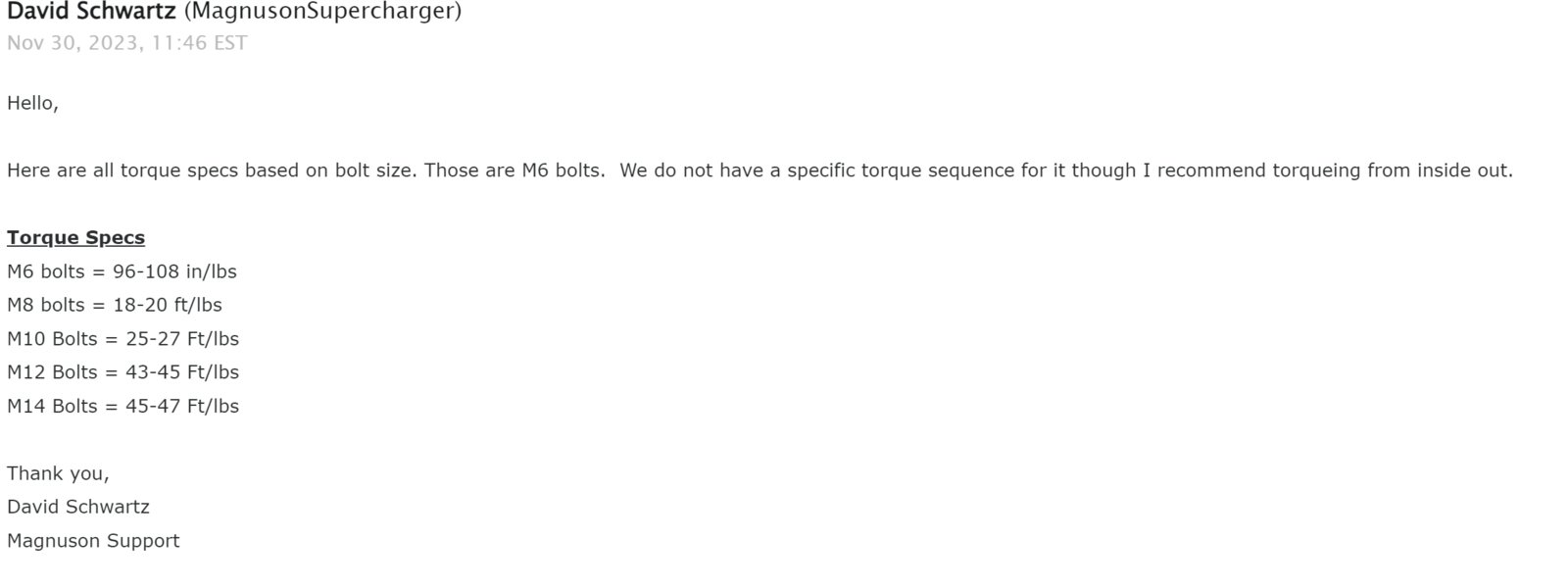

    Would anyone happen to know (or point me to) the torque specifications for the top plate of the Magnuson supercharger? Thinking back, I recall removing that plate (curiosity) before the install. considering at least torqueing everything down, if not adding some kind of gasket/sealant.

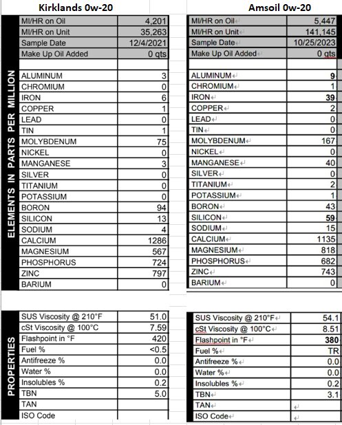

    Look how similar these 2 oils are. and these 2 oils are on either side of the price spectrum. I'm jealous of that Moly.
    this was my oil report, on the left, after ~18 dyno runs - tuning the 650's.

    What did you use to scan and what is the price tag of the device?

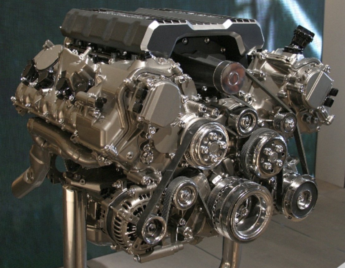

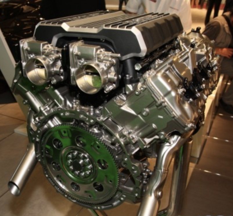

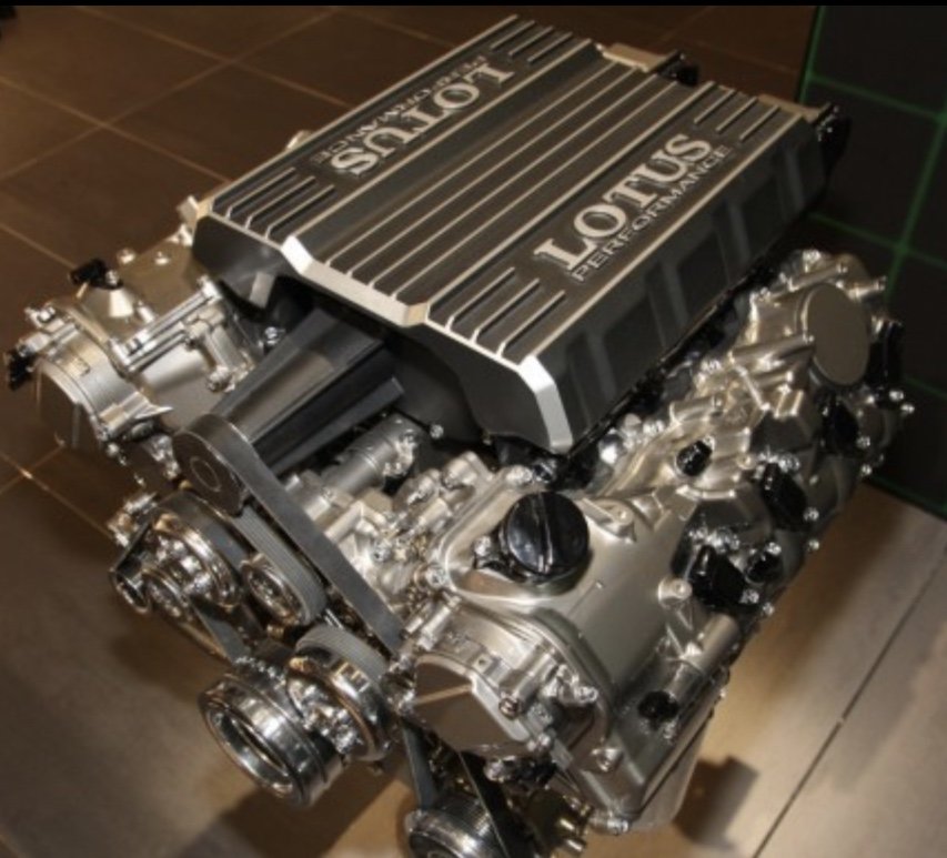

    Lotus sure knew how to feed that TVS1900! Two 76mm rear feeders. This was a prototype Lexus IS-F 5.0 2UR-GSE that was initially planned for the doa 2010 Esprit prototype. The 1st Gen F engine produces 416HP /371TQ, this engine purportedly produced 620hp/530TQ.

    It's called an Einstar and was $950. It seems to be professional grade hardware that's been simplified down as opposed to starting out cheap since the parent company makes much fancier scanners and they all use the same software. The software is free and does all the post processing, and theres multiple scan options and modes with the tightest tolerance for a big object being 0.2mm (.008") which it seems to hit consistently or better.
    This shows a final scan better. I scanned the axle and then used it as reference geometry to design a new knuckle. The tire and brake caliper are also their own scans.

    Are you saying you made them finger tight, and then another quarter turn? I remember taking that plate off ad the bolts were quite stubborn ...

    That is a pretty good capture for that price point.

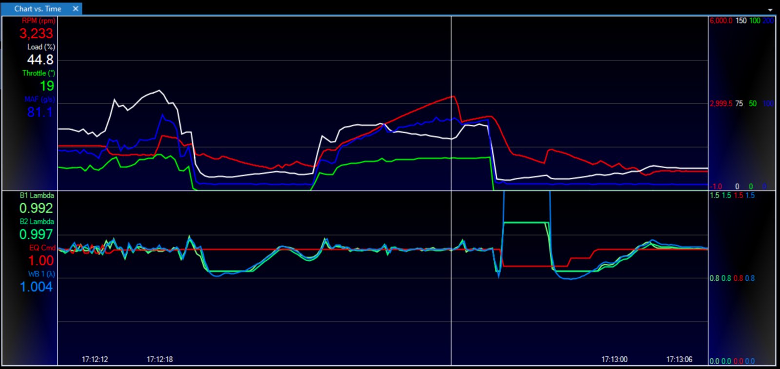

    well, I was looking closely at the logs to gleam some sort of ideas about where this leak is coming from ... the propane test was inconclusive, but I'm skeptical because the engine bay is filled with turbulent airflow ... probably blowing away the propane. Maybe I can find something to act a a wind block...
    So - i was thinking ... the issue is usually right after an increase in RPMs... that is, a big swing from lean to rich. Idle, everything is cool... then I was remembering messing with that top cover before the install. SO... that's what has me wondering if that seal is not what it should be...

    Certainly worth checking out, especially with how easy it is to inspect and fix.

    The bolts of the top half (the intercooler) of the 2650 are to be torqued to 18 Ft-lbs if that can be used as a ballpark reference. It's sealed with an o-ring around the perimeter.

    For future reference ... these are the bolt torque specifications for the TVS1900

    I'm wondering if you have a faulty injector (or injectors). The throttle plate quickly closing at higher RPMs would create an immediately higher vacuum than it would at idle, temporarily drawing more fuel until the revs drop. You can see the RPM briefly bounce up as the AFR goes from rich to lean as the revs dip before settling (meaning the draw of excess fuel has stopped and is being burnt off, causing the revs to momentarily rise).

    Could be, could be. This is my second set. With the new discovery of the blower lid having one bolt that was stripped - I've got my hopes hung on that being the problem. If not - then I'll put the stock injectors in, reflash the ecu and take another log ... that would indicate I got another bum set.
