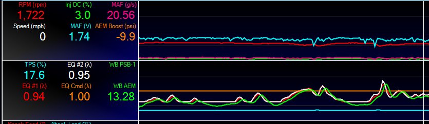

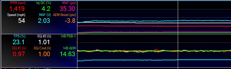

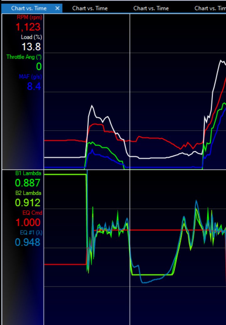

    Maybe I'm just tired and not thinking well, but I would expect a vacuum leak to cause a lean out as the truck gets more air than the MAF is reading. Can you walk us through the installation? Did you do the work? Did you pull the snout to do the pulley? Is it a new supercharger or a used unit? Are you using the stock throttle body? Did you pull the snout to do the coupler? Did the injectors come with new seals or did you have to swap over the black donut seals at the bottom of the injector? Did you clean out the injector bores before installing them? Might help point to a possible issue zone.
    @Mdl had some issues recently after installing a pulley and other things, and his gasket between the top of the snout with the bypass valve and the blower body got pinched of all things. He did a bunch of testing but none of it revealed the issue until he ended up back tracking through the install far enough to where he found the issue. Maybe doing some leak testing will help, but in the same stroke I would take it with a grain of salt if it doesn't reveal anything since that doesn't mean there's not an issue.
    And to throw some more data at you, this was @Mdl log from his issue:
    As opposed to being fixed:
    This is not to say you don't have a vacuum leak, that'd certainly be the most likely issue, but as you can see from this vacuum leak the AFR was bouncing all around but the truck was trying to maintain it around the 1.0 EQ. Additionally the MAF voltage/flow rate are extremely jagged (possibly due to the air source bouncing from the vacuum leak to the MAF and the path of least resistance changing rapidly?). Contrast that to your AFR which is extremely jagged, but your MAF is smooth, and then just a complete random plunge to full rich despite the MAF staying smooth. I don't know, call me skeptical. My brain leans towards injector stuck open... but take that with a grain of salt too, I'm just throwing ideas and information at you to get your mind turning.

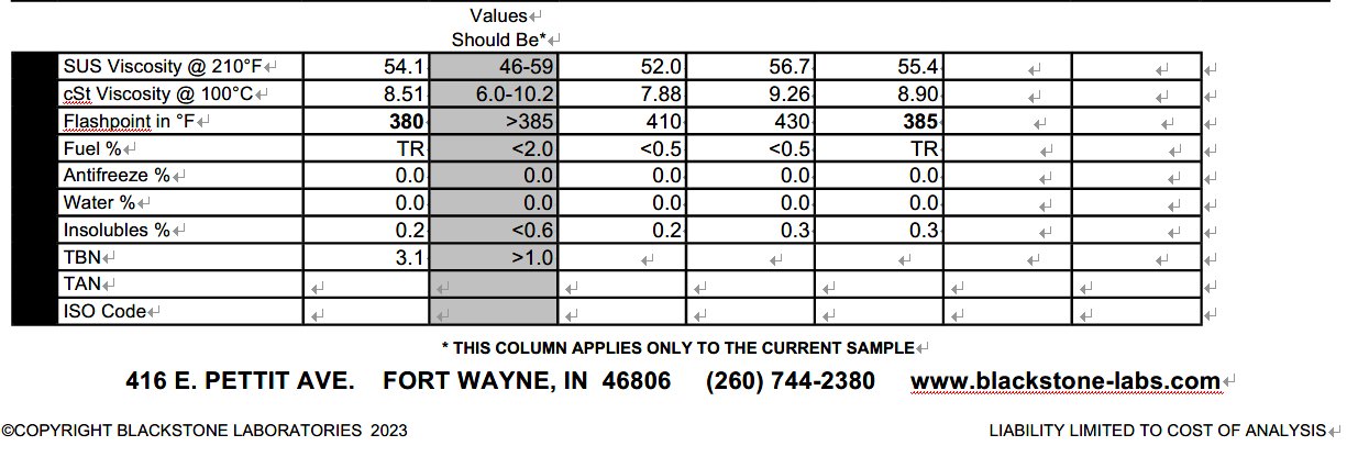

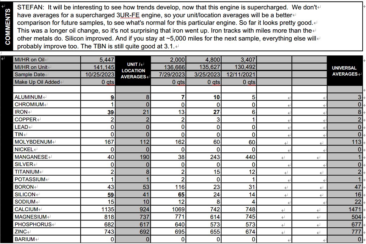

    My first full Blackstone report came, I went 447 over my normal 5k change & got TBN as requested.
    Amsoil 0-20 is the oil.
