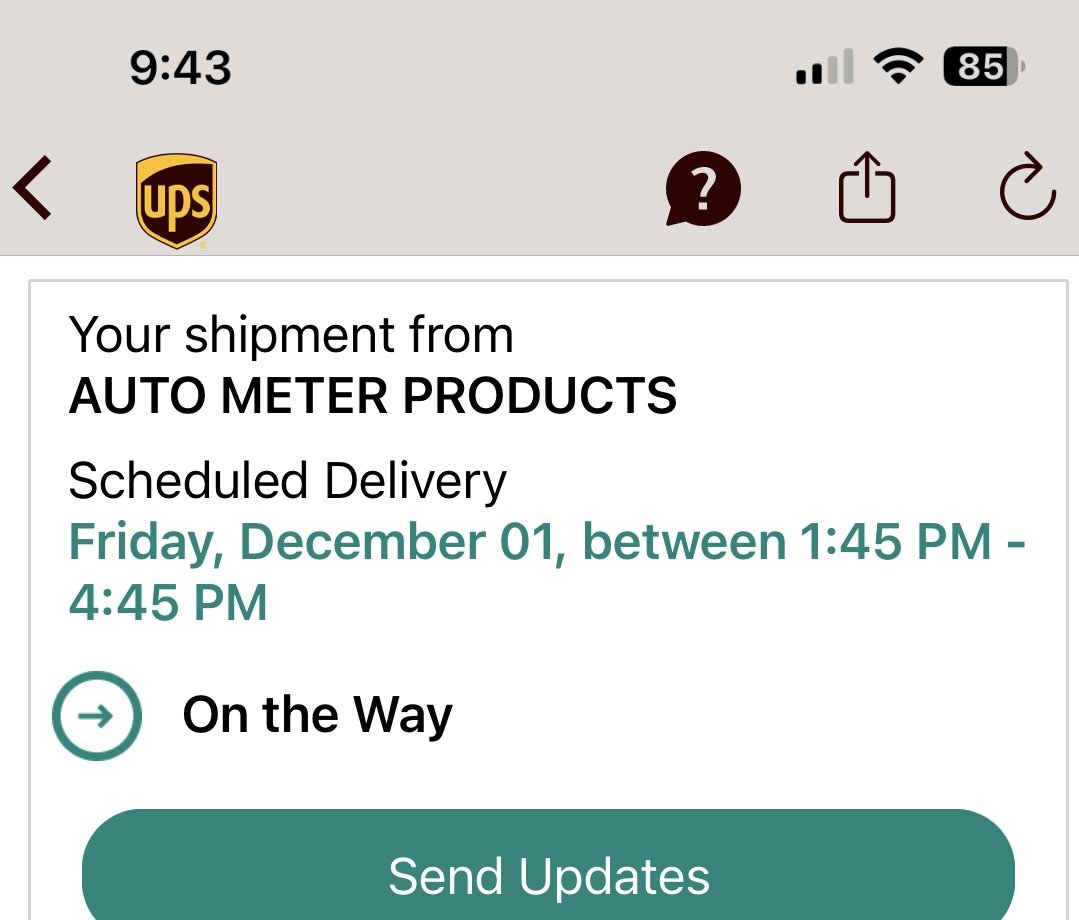

    I may have figured out the MPG issue. Driving to the airport Saturday I noticed the tree didn't seem to be shifting out of 4th, I put it in S6 and it behaved like drive but shifted up to being under 2k @ cruising speeds (had been staying over 2500) I was 14 miles into a fill up so I'll continue to drive in S6 & see what the tank averages.

    Apparently Auto Meter owns Innovate.
    This is the PSB-1 for the BMW.
    Of course it's coming the day after I go to N.Y.
