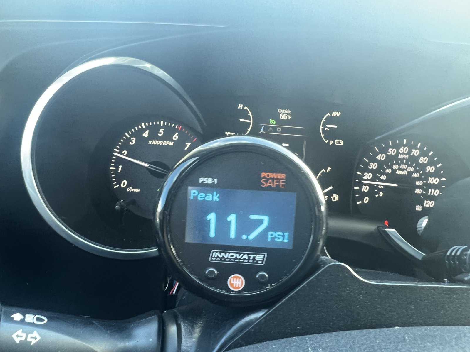

    New high, truck loves cool air!

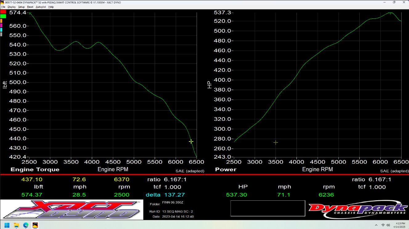

    My question is if I did this @9.5lbs slipping, where is it at 10+ not slipping
    Also, @snivilous if I'm getting this high should I not risk the 2.2?

    Out of curiosity, @e30cabrio, looking at the HP graph, is that belt slip around 5600/5700 RPM, and then fuel cut at 6200/6300 RPM? And DANG.. that torque at 2500 RPM! Is that just a dyno artifact settling down at 3000 RPM? Or is really making that much torque that low?

    I have no idea, that's a fat bit of boost. @Mdl or @Fastlane47 are probably the ones to discuss with how much power you feel safe running. I probably wouldn't run the 2.2 if it's already knocking on 12psi, but it's kind of game theory how far you feel comfortable pushing it and not knowing how close or far the cliff of destruction is :D If I didn't need my tundra to tow stuff I'd probably send it and see how much power it could make :p

    It'd probably be good to know where your MAF voltage is as well as injector Duty Cycle and AFR. On the 1st Gen Tacomas we were using Exhaust Gas Temp sensors to determine if more fuel was needed to keep temps down. I'm mildly surprised that it's not mentioned in our application. We're kind of guessing how fat to run at WOT to keep heat down rather than actually measuring the heat. If I recall correctly, the recommended ECT to stay below was in the neighborhood of 1400F. Unfortunately there were probably some casualties in determining that temp. No idea what that might be for the 3UR.

    I'm not really looking to kill the motor. lol
    No idea. lol

    @e30cabrio for me I'd stay under 13psi. I settled at 12psi with good fueling, good tune and the added protection of water/methanol.
    Heard of too many coming apart pushing them.

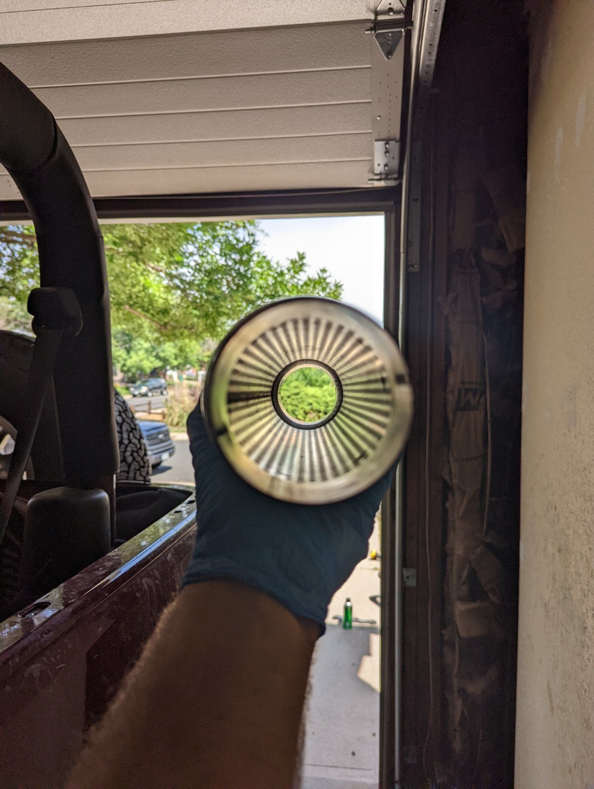

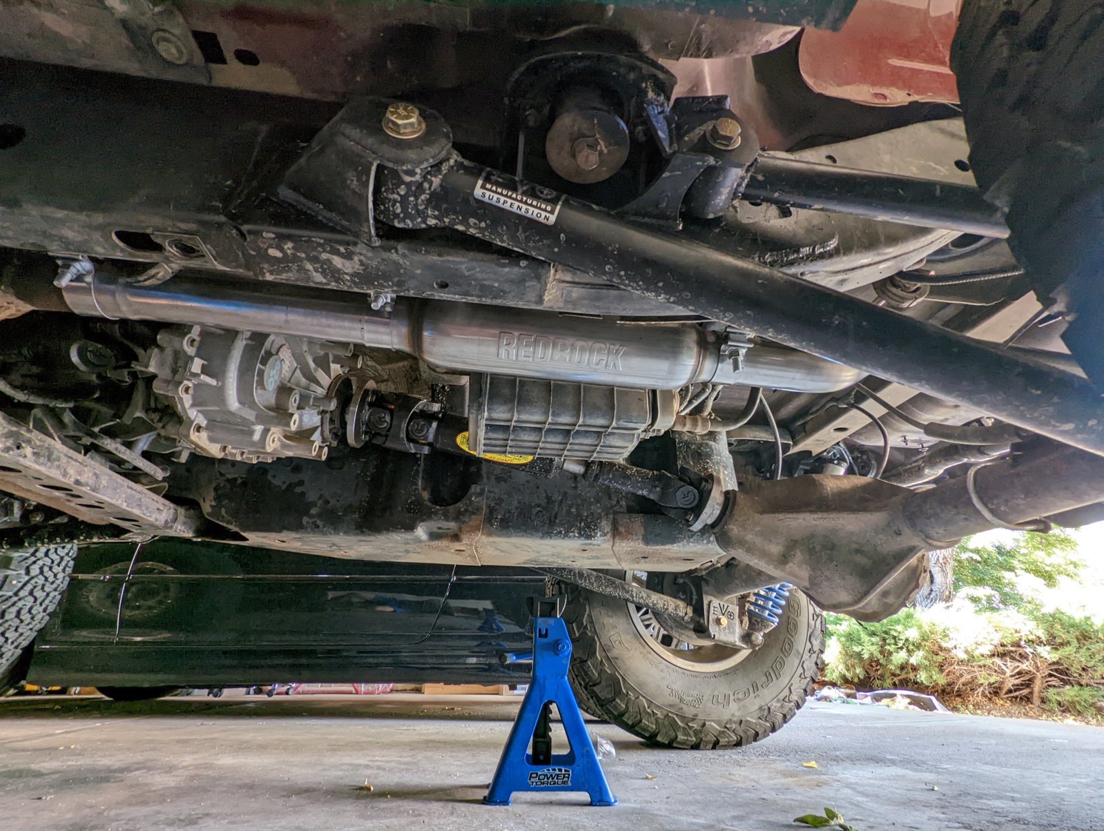

    This is the "muffler" on my jeep. It's loud lol
