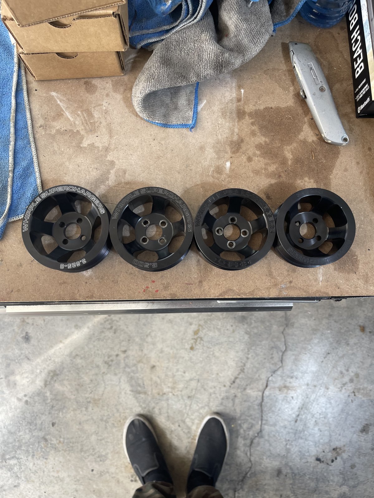

    Yea that’s what I thought lol

    Hahaha. That 3.625" pulley doesn't even look like it's been mounted...

    lol it wasn’t
