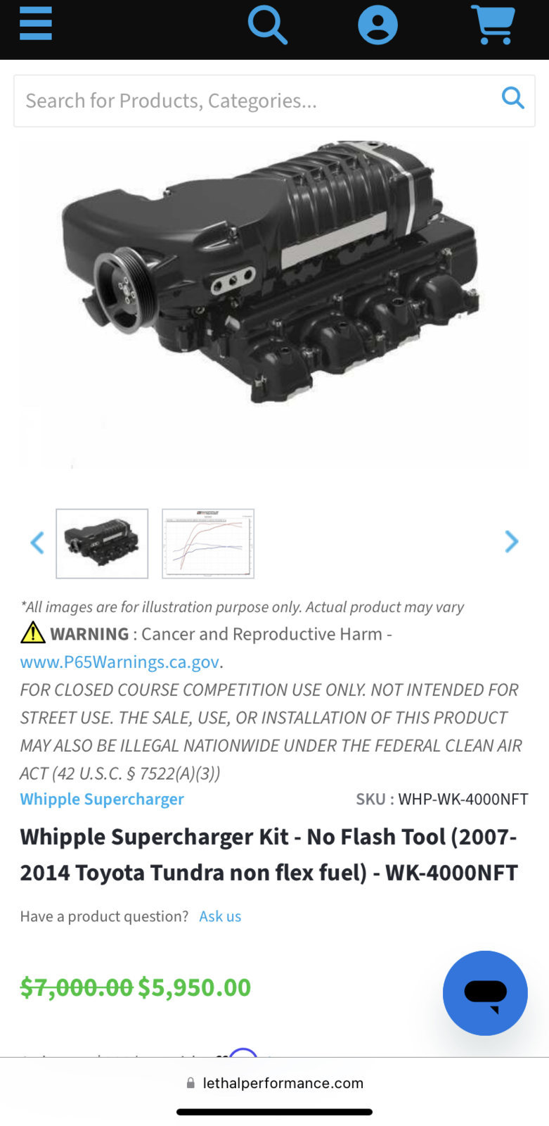

  10. Nov 20, 2023 at 8:27 PM
    Saltyhero13
    Saltyhero13 Throbbing Member
    Aug 12, 2020
    #50704
    4,947
    Fuel delete mod Cup holder upgrade
    I thought it was a twofer sale when I saw it in my inbox. So disappointed.
