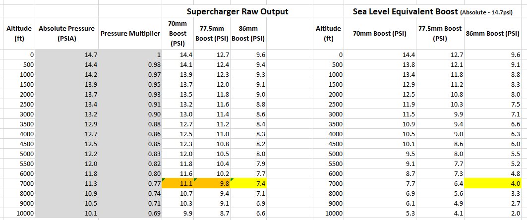

    I had posted something and it was totally wrong I realized, so if you saw that post ignore it! This one should be "closer" to real.
    This is an extremely preliminary extrapolation I did based on @Wynnded saying he made ~4psi at ~7000ft (bottom right yellow cell), this also projects close to what @carn_dogg said about making ~9psi at ~sea level, so I think the 86mm (stock) size is pretty close. Up and down (altitude) on the chart is pretty consistent with air pressure. Where it gets more complicated is pulley size isn't linear to boost in my experience. For example, my 2.0" pulley which is ~13% smaller than a 2.3" pulley, generates ~48% more boost. Using numbers I measured before and assuming the 2650 has a similar efficiency curve, I came up with the orange cells on the left. The 77.5mm is ~10% smaller, but generates ~32% more boost, and the 70mm is 19% smaller and generates ~50% more boost. Both of those assumptions are loosely based on the Magnuson 1900 data I've compiled, but without someone actually testing one of those pullies and giving me numbers, it's all a guess.
    With that said, I would think these are pretty close within a psi or two. The values on the left (Raw Output) is how much boost is the blower actually creating, the values on the right (Sea Level Equivalent) is taking the Raw Output and subtracting the boost used to make up for elevation loss. How I think of it is Raw Output = supercharger stress, Sea Level Equivalent = engine stress (and is what your boost gauge actually reads).

    Im anxious to see the results I'll have with the lighter pulleys going in if this will effect boost at all. Less engine rotational mass less boost?

    So is magnuson under-rating the 2650 when they say it makes 7psi or is there that much variation between individual setups?

    I never saw over 7psi on my 2650 with the 85mm, granted I live at 800’ and my boost gauge only reads in whole numbers. Don’t know if it shows 7 if it’s 6.5 or greater, or if it actually needs to hit 7 to show 7. 9 psi sounds high to me unless it was an exceptionally low DA when that was seen, perhaps combined with terrible flowing exhaust.
