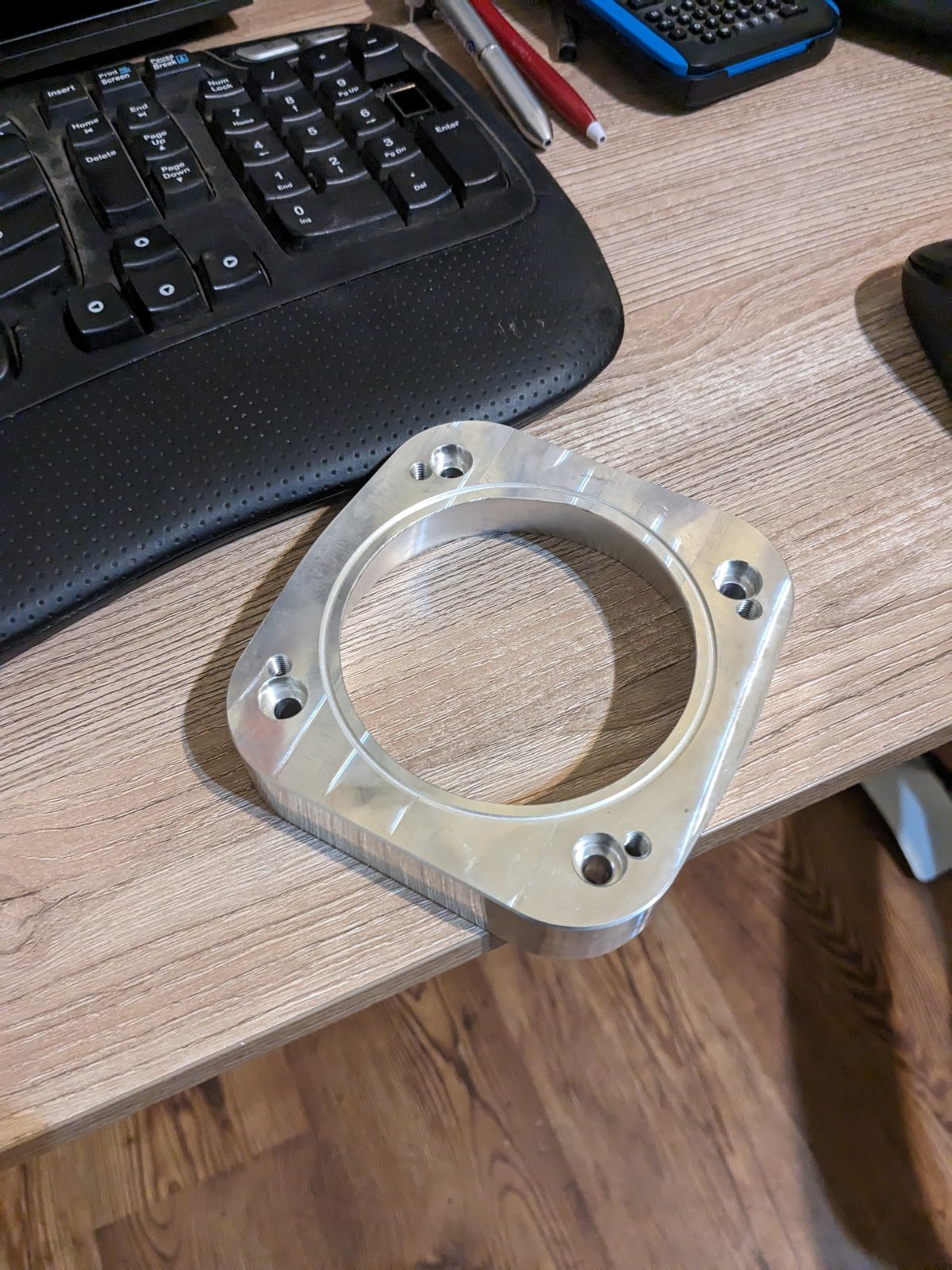

    I'm slightly confused as to what I'm looking at. What's the pattern on that thing, RFC to Harrop? Wouldn't it be the same? The Harrop would be patterned to take a stock Tundra TB. The pattern for the 1900, 2650 and the Harrop would all be the same.
    Oh shit, I need to make a correction! The outlet of the RCF TB is ~83mm, not whatever I was saying before. Forget that number...
    Back to my regularly scheduled confusion.... What's the ID transition on that bad boy?

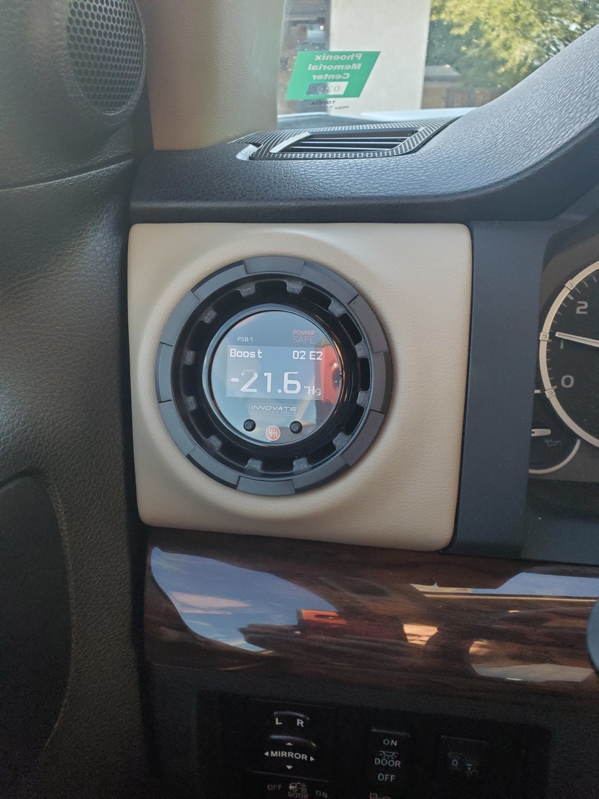

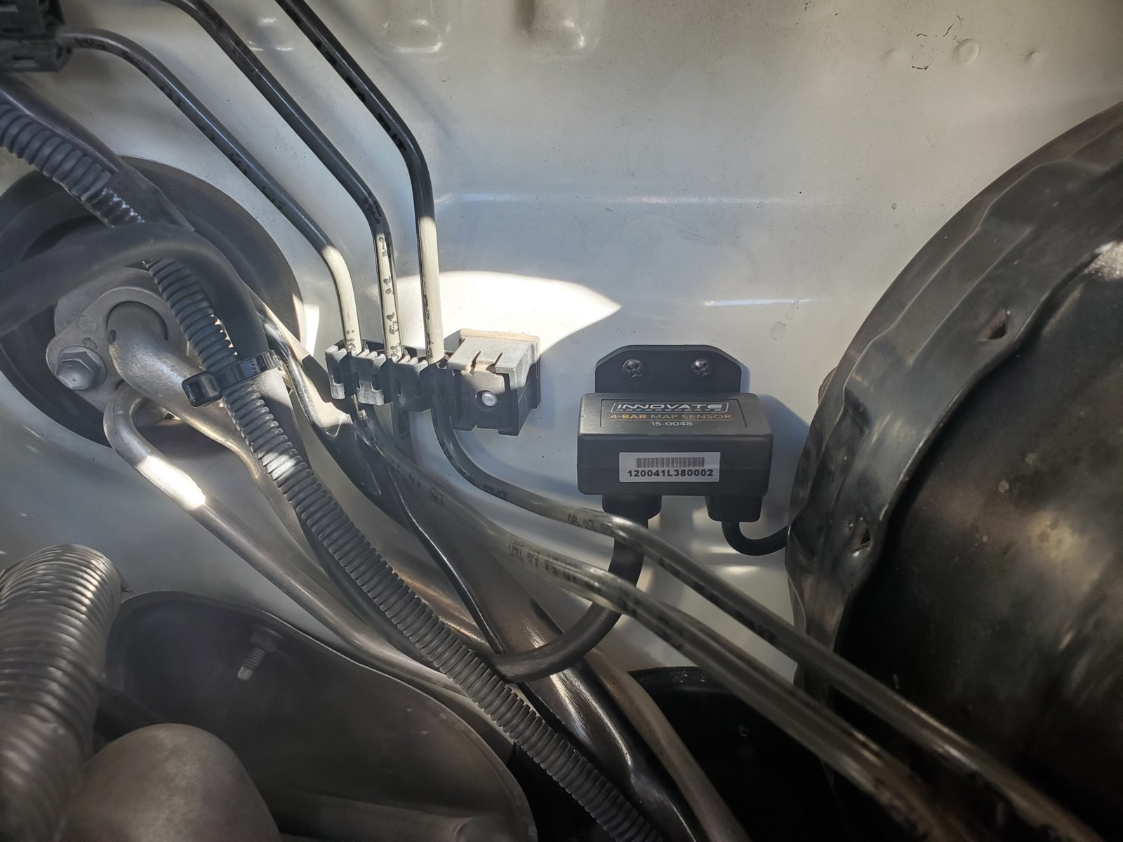

    I was going to tap the dimmer from one of the oem lighted switches as @snivilous suggested, but I first connected w/o using the dimmer function and the Innovate gauge is not overpowering by any means with it fully lit. I decided just to connect the white wire to ground and eliminate the dimmer option.

    Just kidding I'm retarded, this is a Whipple. You're right the Harrop adapter would've worked, but it wouldn't have been a smooth transition since the TB side was 90mm, and the blower size was something else (opposite of yours)---plus the Harrop one had holes for a GM throttle body and not the RCF.
    I can get a TB spacer made for you, but theyre not cheap, the last ones I think were $200 a piece. Or if you know a local machinist I can send you the CAD.

    My TVS1900 has stock TB over bored to 80mm, and tapers/transitions to 83mm. The o-ring groove on the snout (which has an ID of 83mm) is filled with an aluminum ring, then the old inner diameter is ported out to 83mm ID of o ring groove. The Lexus IS-F uses a nearly identical 76mm throttle body, but uses a MLS gasket in place of the the O-ring, so sealing things up is easy with an off the shelf part. Pics if anyone is interested in pursuing this path.
    Has anyone considered redrilling the bolt pattern on the TVS2650 snout to allow the RC-F throttle to directly bolt up? What about over boring the 84mm? I have an RC-F unit here, I’ll see if there’s enough meat in the casting.

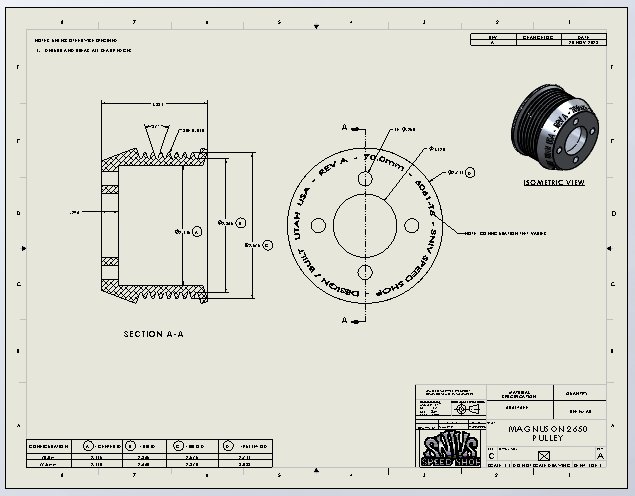

    Magnuson 2650 pulleys are sent out for quote. I'm going with just the 77.5mm that is popular with the Harrop guys, and the 70mm which is about the same as the 2.0" setup I did for the 1900 Magnuson. That should cover the sweet spot of good reliable power at sea level and high elevation.
    I also measured the Harrop pulley that @ViktorG had sent me, it would require a fair bit of modification to work with the Magnuson 2650 but I do think it'd be possible. The rib/mating surface offset is close enough I think it'd be usable, however the bolt pattern is completely wrong and the alignment bore is ~.055" too large. Drilling the front for the mounting holes and using some shim stock as a reducer adapter for the alignment bore could make the Harrop pulleys work on the Magnuson, though that is quite a bit of modification so I decided to move forward with making my own Magnuson ones.
