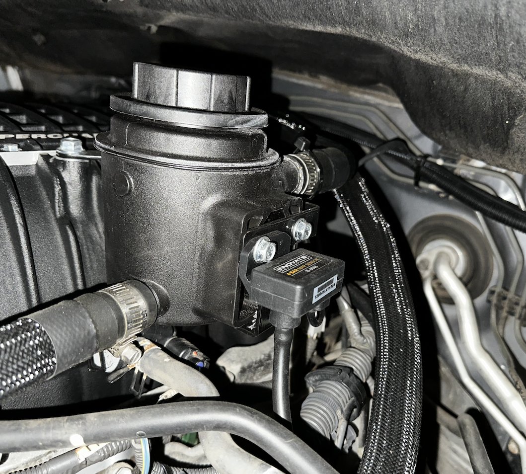

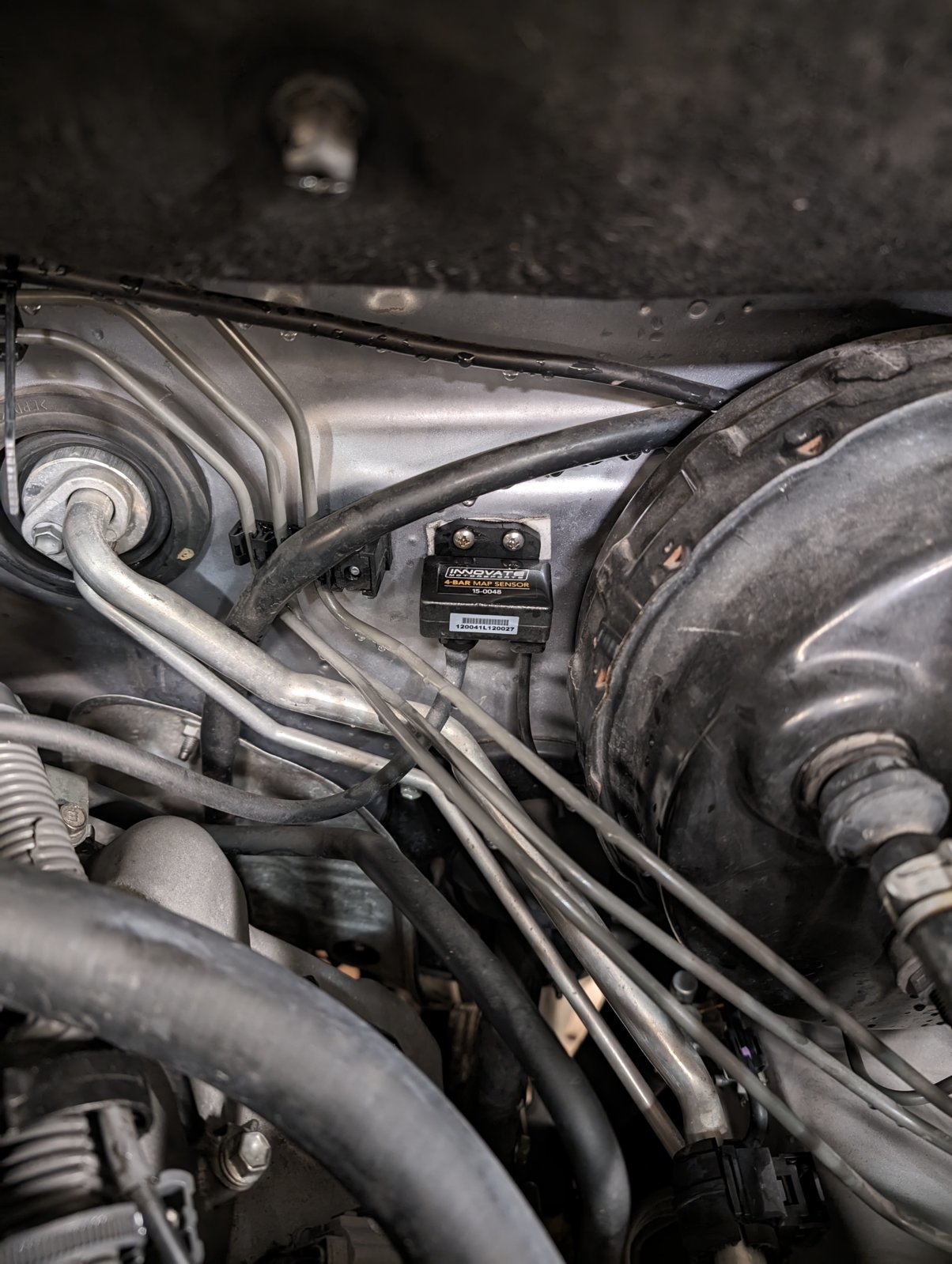

    You could use VHB tape if you dont want to drill

    Good call. I may go that route if anyone can't confirm I'm good to drill there. The screws I'd be using are just long enough to secure it and would probably only go 1/4" into the metal.

    Not to dissuade you from mounting to the bulkhead, as I almost went that route, but I ended up mounting mine on the IC reservoir.

    I agree it would look clean against firewall, short self tappers should do.... Mines ghetto route ziptie and bob the builder rigged boost nipple:cool:

    I was looking at that exact method while scouting for a location under the hood. Another good spot.

    Ha ha. Mine was mounted with zip ties as well since the supplied vacuum line isn't more than a foot long. I was pretty limited at the time with what I could do.

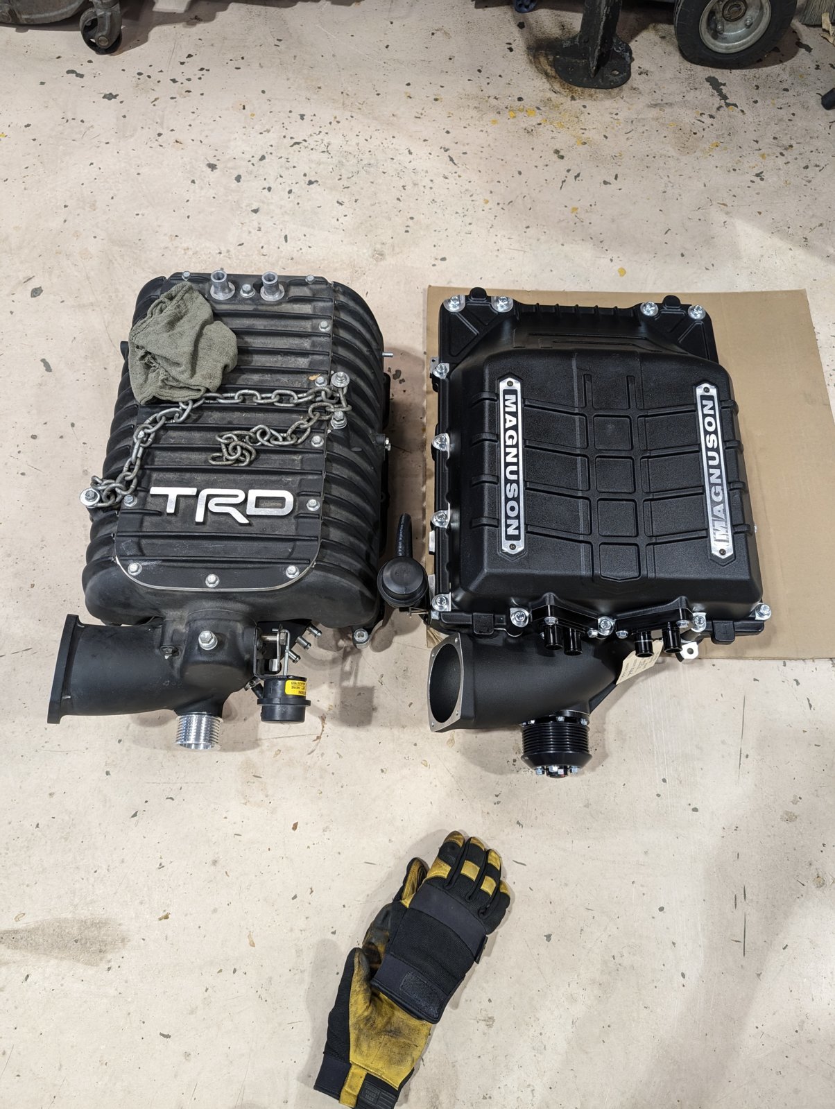

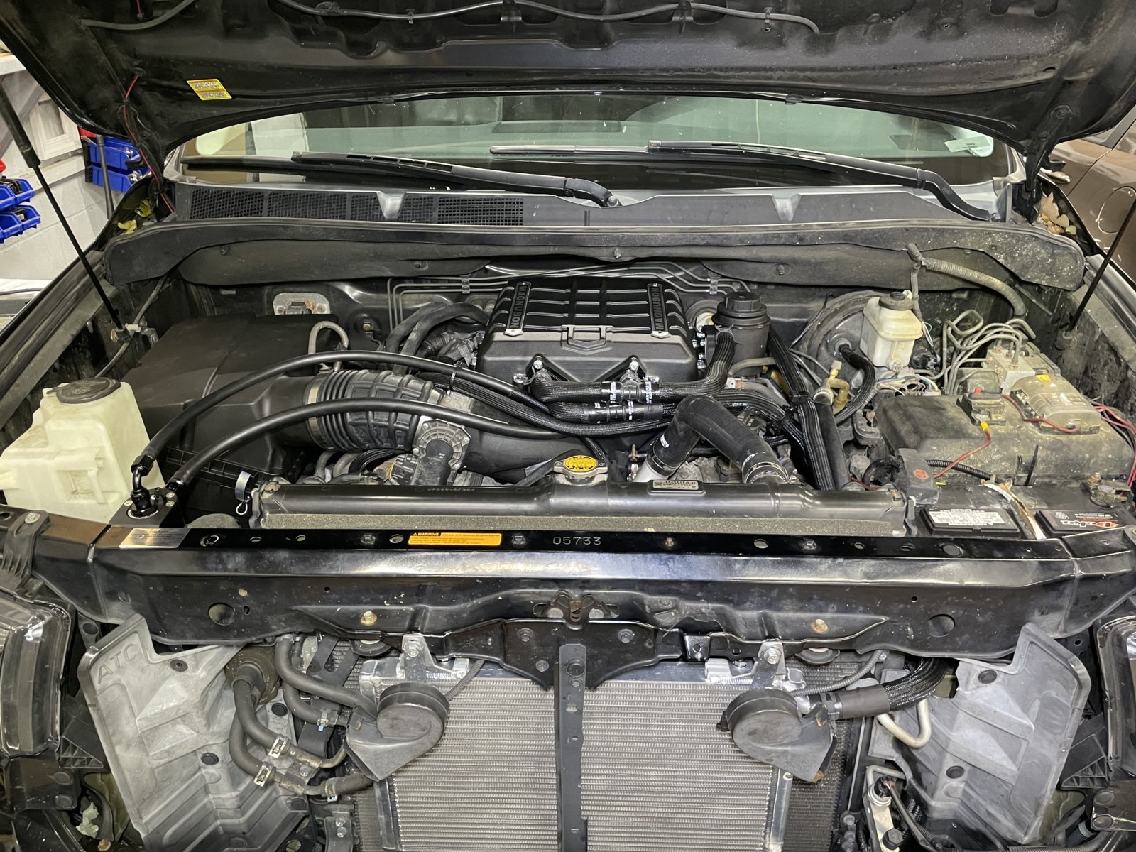

    Here's where I put mine.

    I've drilled quite a few holes though the firewall. Mostly for wire runs with grommets. I don't believe there are any lines on the back side of the firewall in that location. Mine is an 07 so not sure if things have changed. To the left of the center dash there are some servos for the vents. But you have a decent .5 inch from backside. Mine has the carpeting and can't see any wire runs or piping.

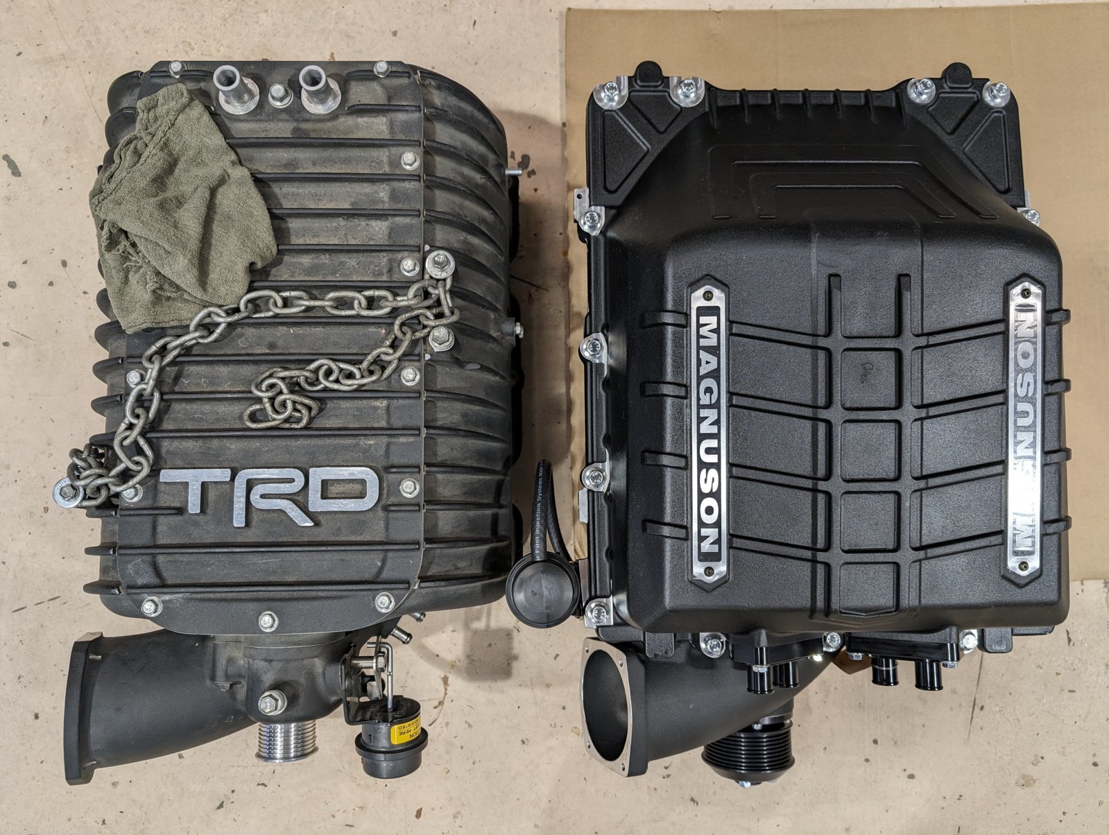

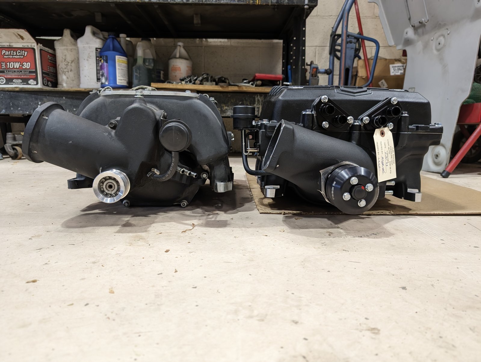

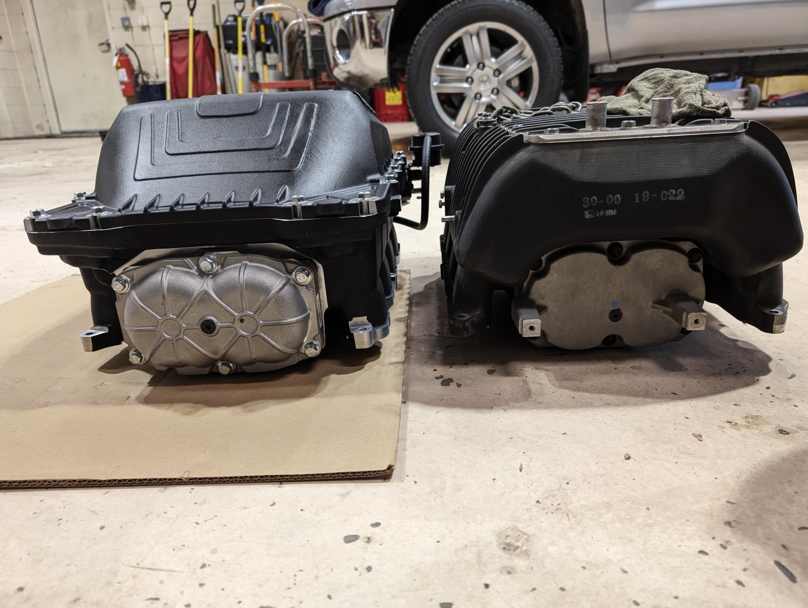

    Random.
    I don't think that the camera really accurately shows the differences, for example, the angles of the inlets look much more different than the really are.

    @Wynnded , did you go thru the upgrade process with Maggy? Notice anything more amazing vs the 1900? Delivery-wise?

    Yes, mine was the upgrade kit. No, not yet. I did the install yesterday at the workplace and only drove it the mile home. We got enough wet and heavy snow that there was no point in even considering any comparisons. The blower is very quiet though. When I was running it up to temp to check for leaks, the only things I could hear were the burble of the exhaust and the ticking of the injectors.

    You had a busy day! Yes the 2650 is quiet but once you get into the power band she does start to sing the whine.....
    Can really see the substantial size difference in pullies here! What size were you running on the TRD? Need more of that for the 2650! Lol

    I just tried to send @snivilous a bunch of measurements. ;)
    That was Sniv's 2.0 pulley, the smallest available.

    It looks like the new blower doesn't have provisions for the wire harness clip retainer to screw into it...how do they address this, or is it just left hanging?

    Correct, and there was no mention of how to deal with that in the instructions. The harness on my truck doesn't really move at all, which creates other difficulties (like access to that rear mounting bolt), so I just left it alone.
