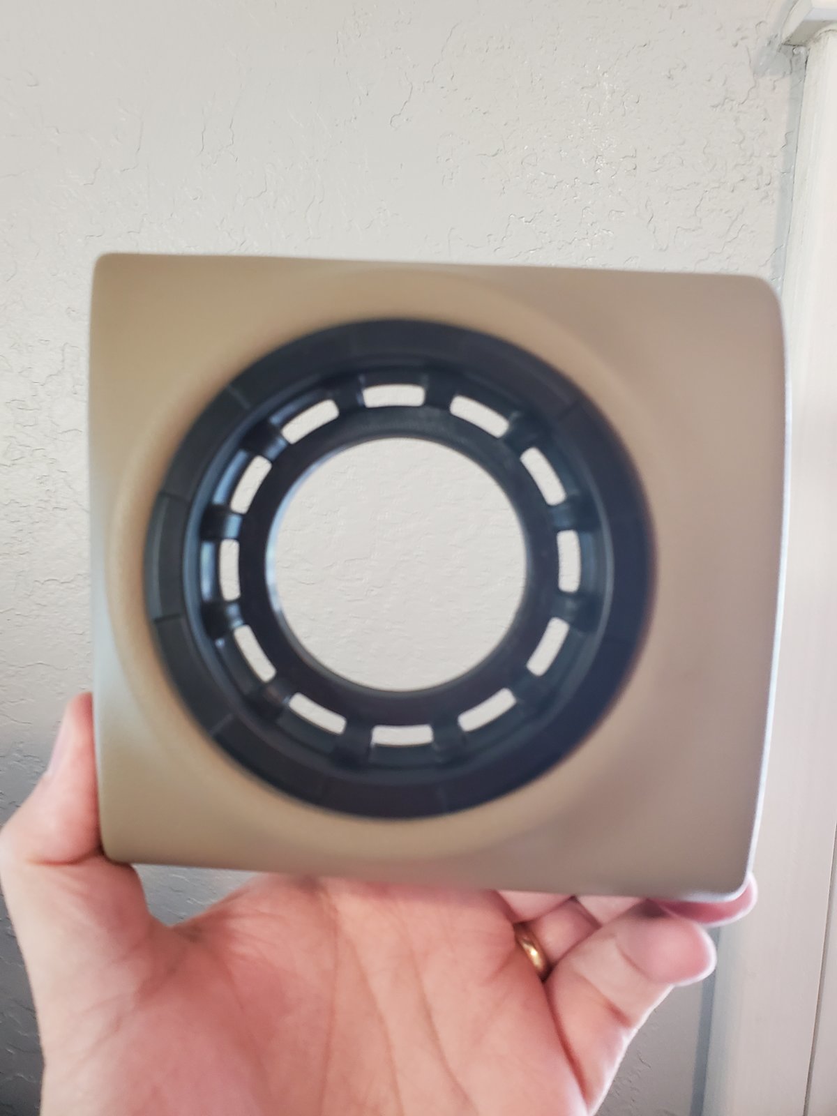

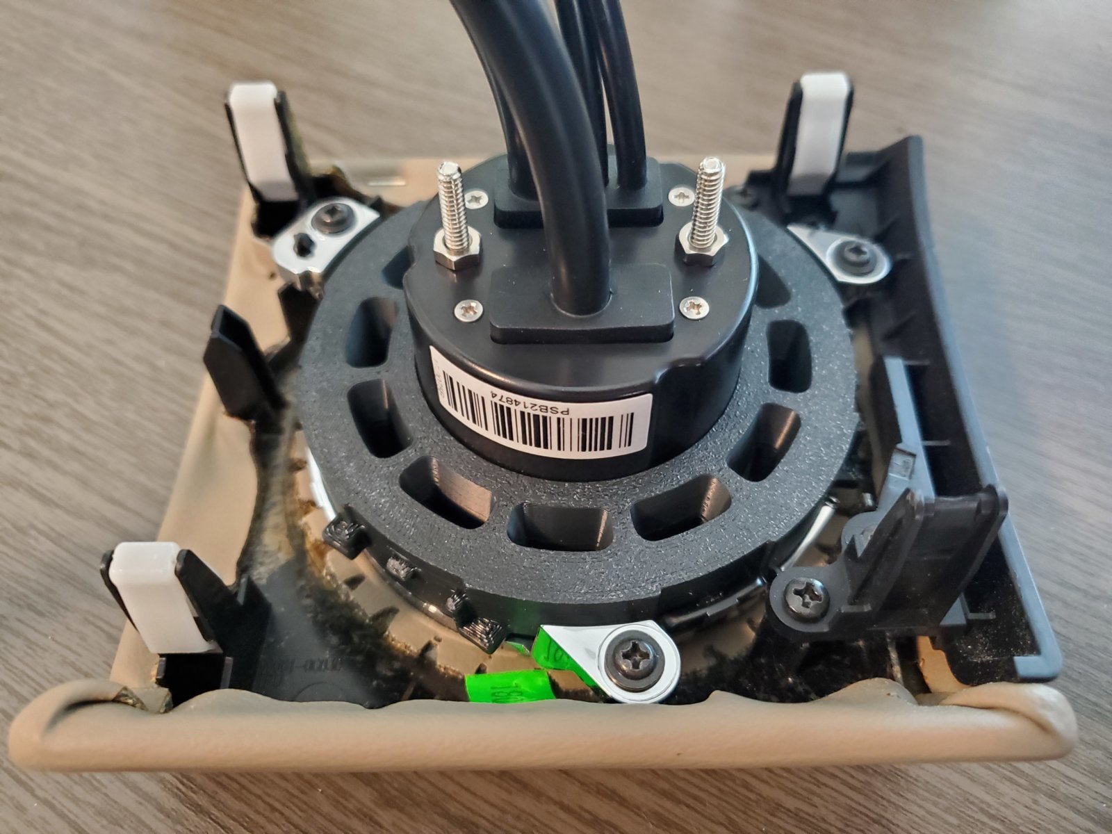

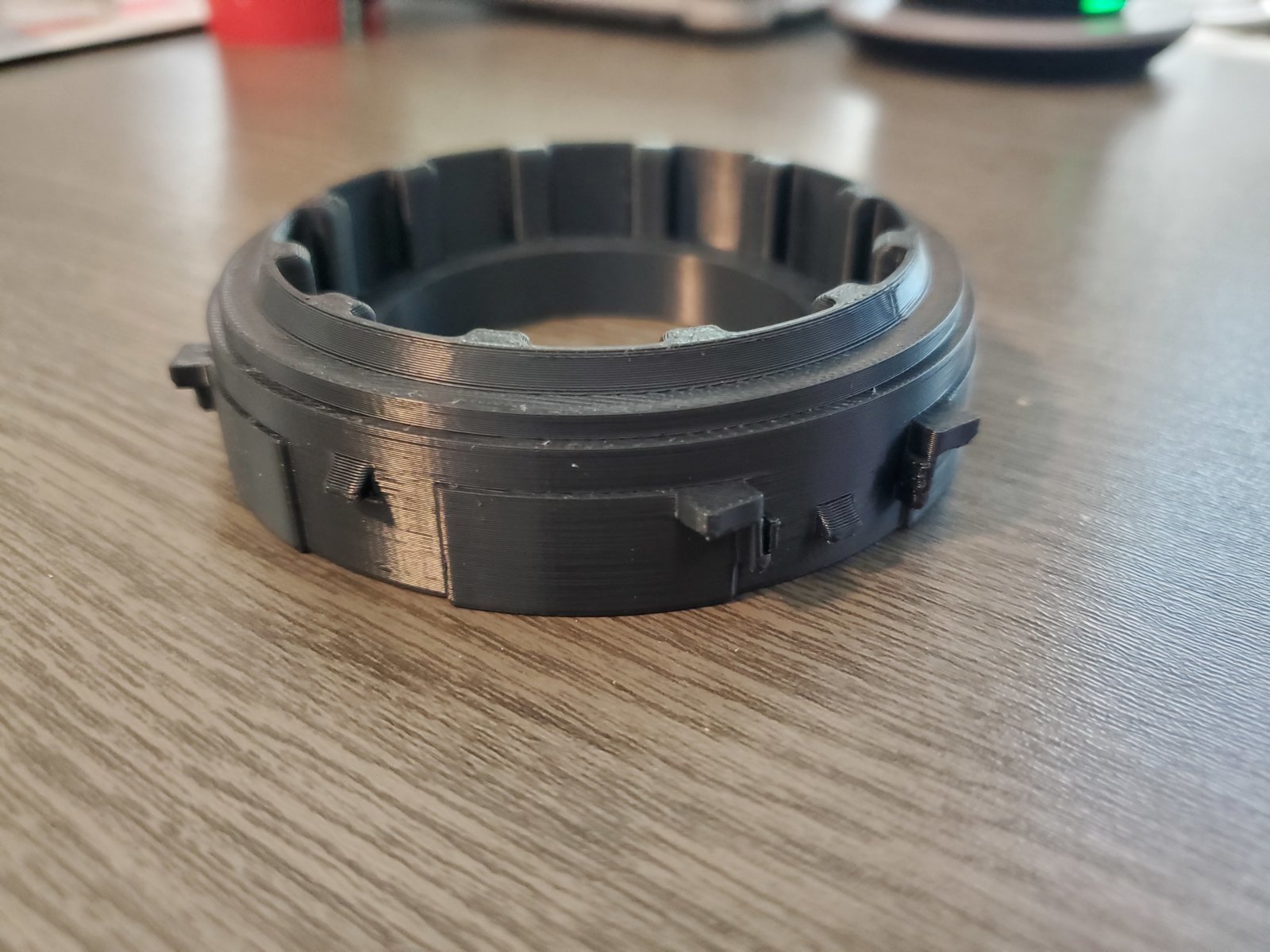

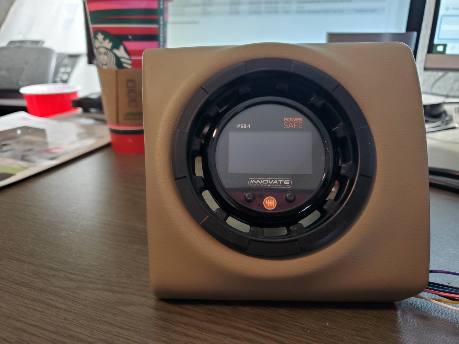

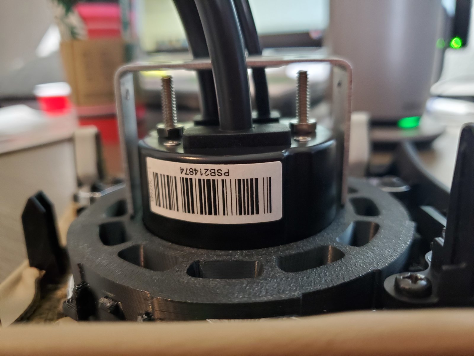

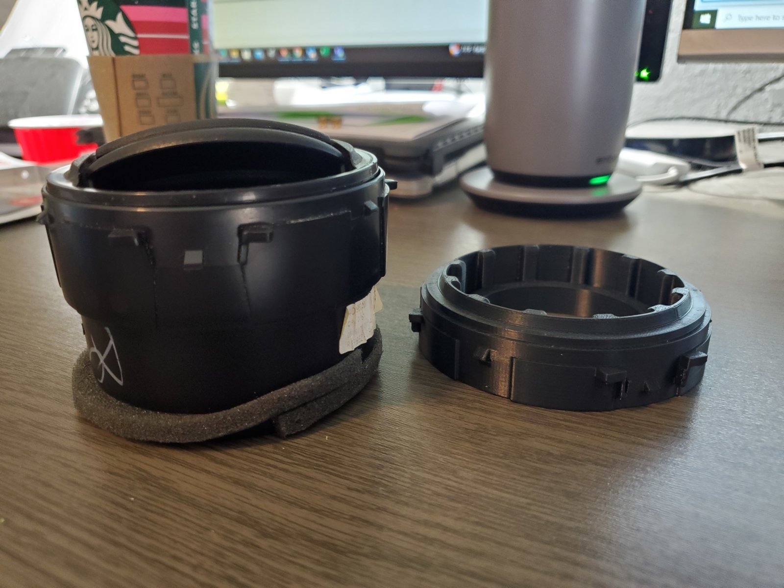

    Just wanted to update with my final gauge pod setup. I've been trying a few ideas and haven't been happy with the look/fitment until now. Originally I tried the Mustang vent pod ring from Glow Shift. While that one did fit into the Tundra vent it was not a solid mount even after trying a few different ways to secure it I was never really happy with it. Next up I went with the Cravenspeen flexpod mount. My plan was to just utilize one pod since the Innovate PSB-1 does both AFR and Boost in the same gauge. My issue with this mount was just the location of the gauge. I felt like I was just settling on this because the vent mount idea sort of fell through and let me down.
    After searching high and low I came across a posting on Etsy for a vent mount gauge pod for the 2016 - 2023 Tacoma. Based on the pictures included in the posting the Tacoma vent itself looked identical to the Tundra. The seller has many pod mounts for different models, but nothing listed for the Tundra. I gave it a try for $35 and the pod arrived today. It fits into the Tundra trim with a perfect fit. The 3D printed pod has the same tabs as the OEM Tundra vent and it clips into the dash trim just like it was meant to be there. The pod fit the Innovate gauge with no modifications whatsoever and is rock solid. The only item that will need to be addressed is the gauge bracket which needs to be trimmed a little since it's too long.
    I've sent an email to the Esty seller notifying them that this gauge will also fit the 2014 - 2021 Tundra in addition to the 2016 - 2023 Tacoma that is listed on their site. Below is the link to the item if anyone is interested. I can't recall who else was running the vent pod from GlowShift, but I'd seriously recommend swapping to this mount if you are unhappy with the fitment.
    2016-2023 Toyota Tacoma Vent Pod N300 3rd Generation - Etsy
    **Cravenspeed Flexpod is available if anyone is interested.
    EDIT: Cravenspeed Flexpod has been sold.

    Badass.. and I just bought one too as a just in case...haha looks outstanding!! Have you thrown it in yet?!

    I installed the MAP sensor and ran some of the wiring to get power and the dimmer connections over to the vent. I was waiting for the vent pod to arrive before fully hooking it all up. I still need to find time to get the bung welded in. I'm going to have Performance Muffler do the bung, but they are only open Mon-Fri so it might take a little time before I can accommodate that with my work schedule.

    Seller is quick with the update. They responded to my review and already updated the title to include the Tundra!

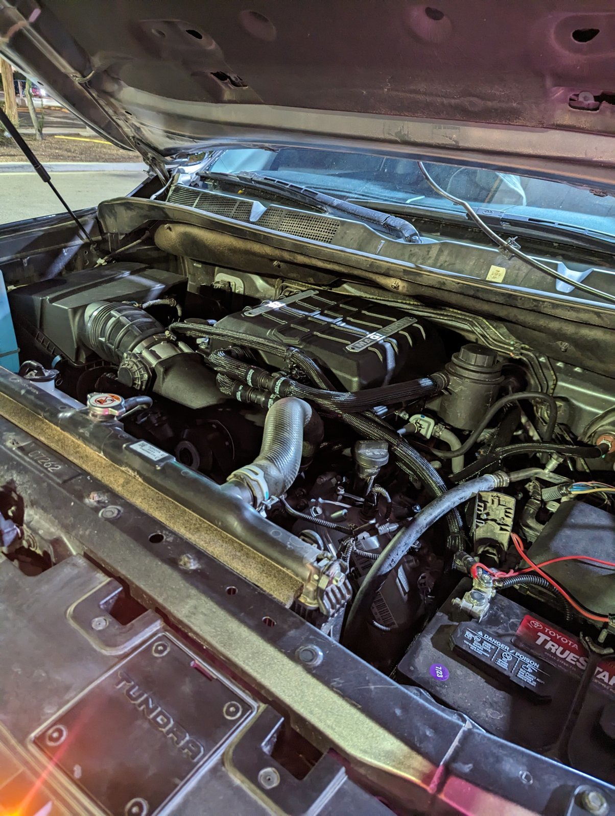

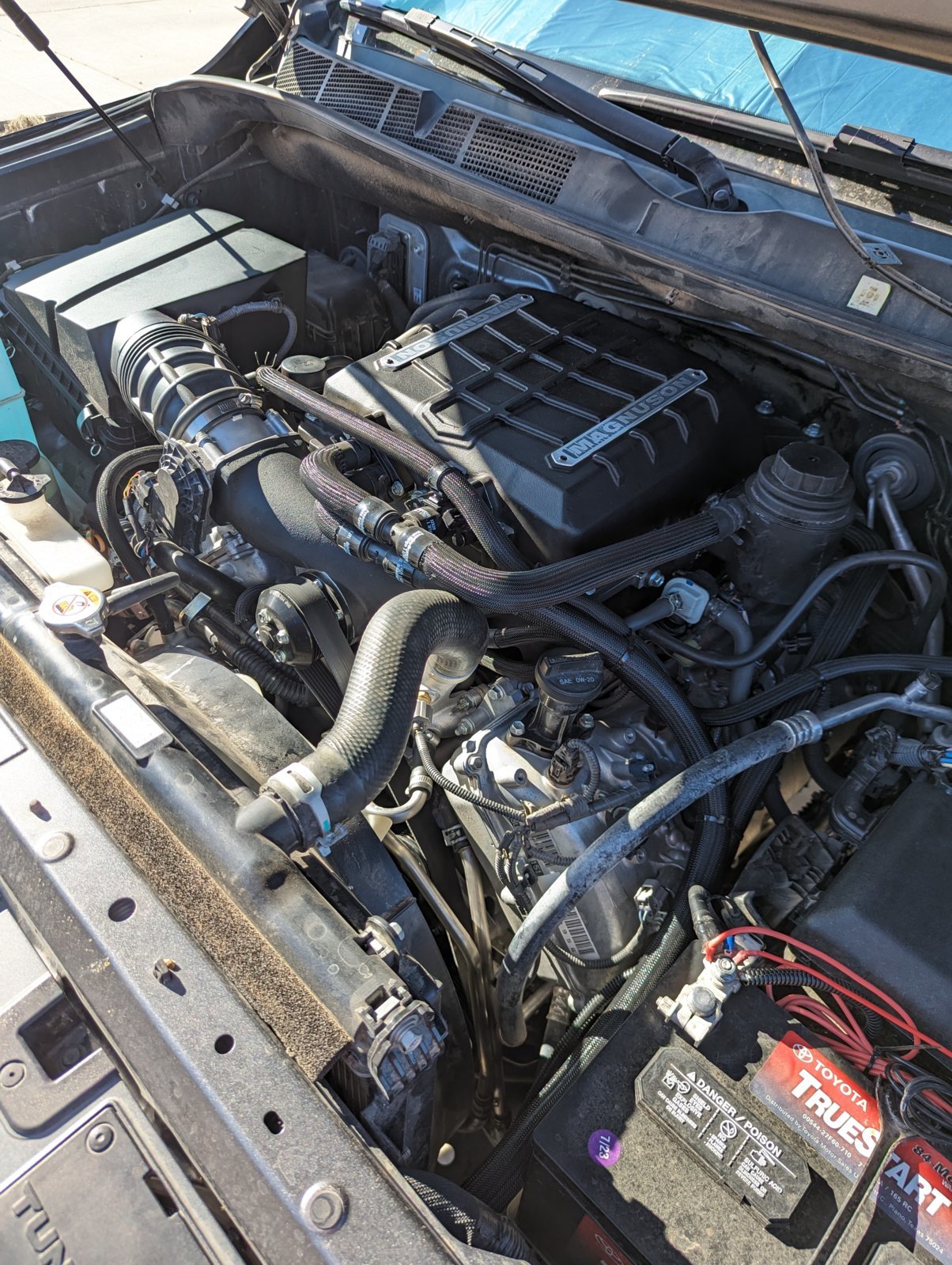

    Can someone post a picture of their Magnuson 2650 engine bay so I can update the first page. And if there's any special info or links to things that should be there, post that too :D

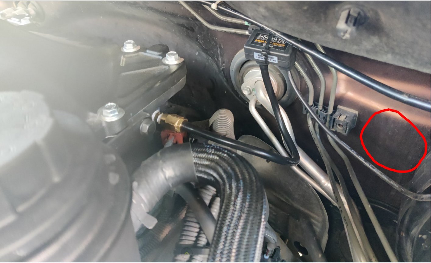

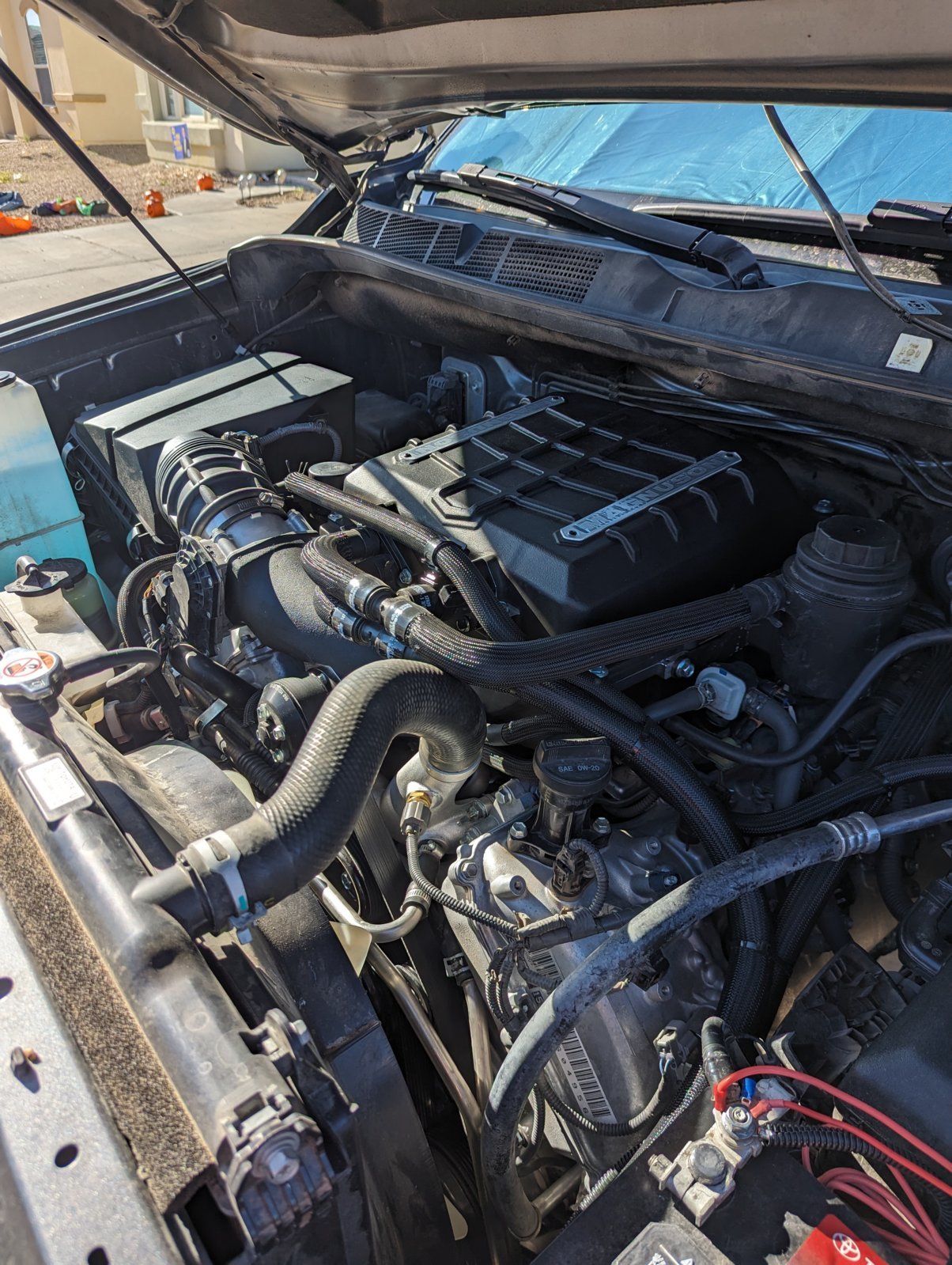

    Borrowed this picture from one of @ARES35 posts. I picked up 2 ft of vacuum line today from Ace Hardware so I can move the Map Sensor father away from the blower. Is there any reason I can't drill into the firewall and mount the Innovate Map Sensor here? Anything to be cautious of when drilling there? I can't imagine anything would be right behind the firewall there, but ya never know...
